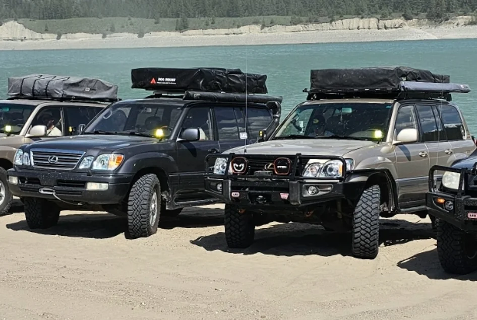

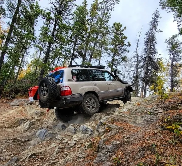

4 pinion is just as weak as the 2 pinion diff. I have experienced breakages first hand in the same obstacle, 98 vs 03 100 Series the 98 (mine) being as heavy as it could possibly be and the 03 just bigger tires and a lift.
Get a locker, problem solved
Both 100's and the obstacle mentioned
