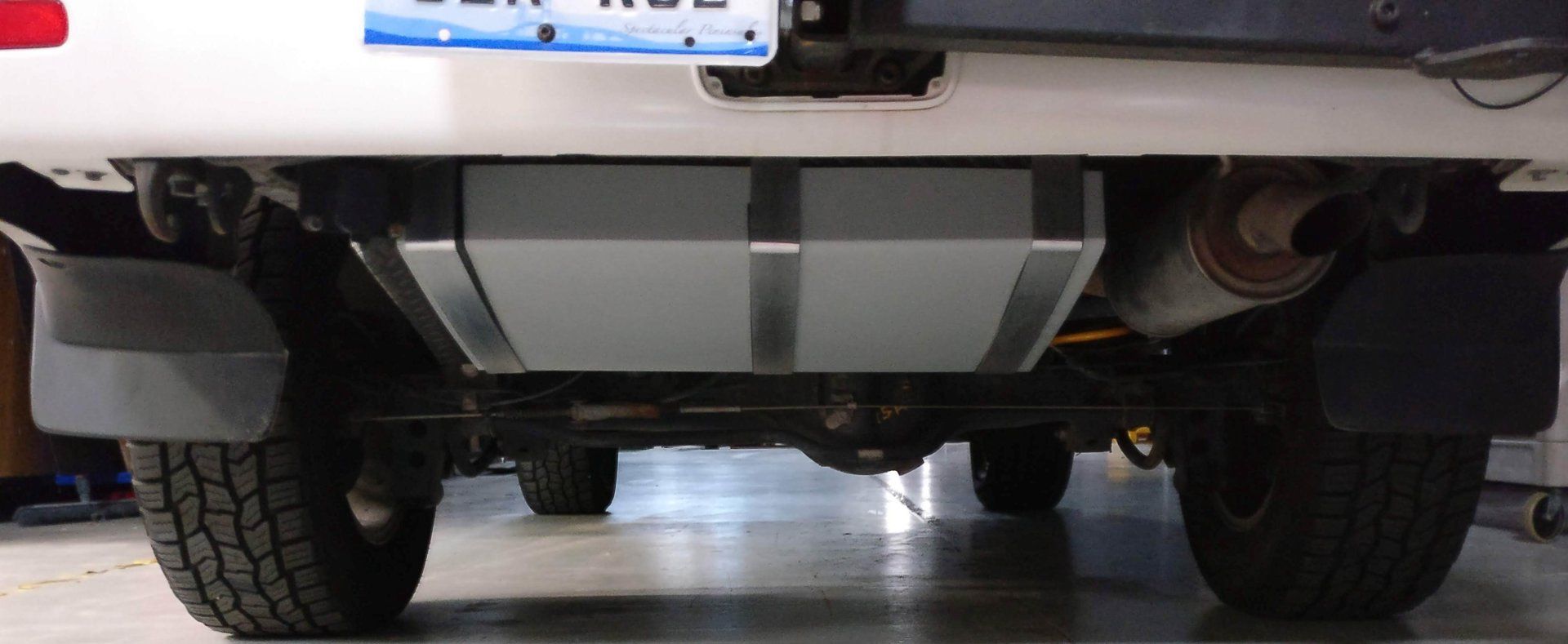

The tank is mounted to the same cross-member that the spare tire winch is mounted to. The cross-member needed a couple of 8mm holes drilled for my tank mounts to work. I used 80/20 aluminum extrusions for tank mounts. M8 holes are tapped into the sides of each extrusion (that's how they are meant to be used).

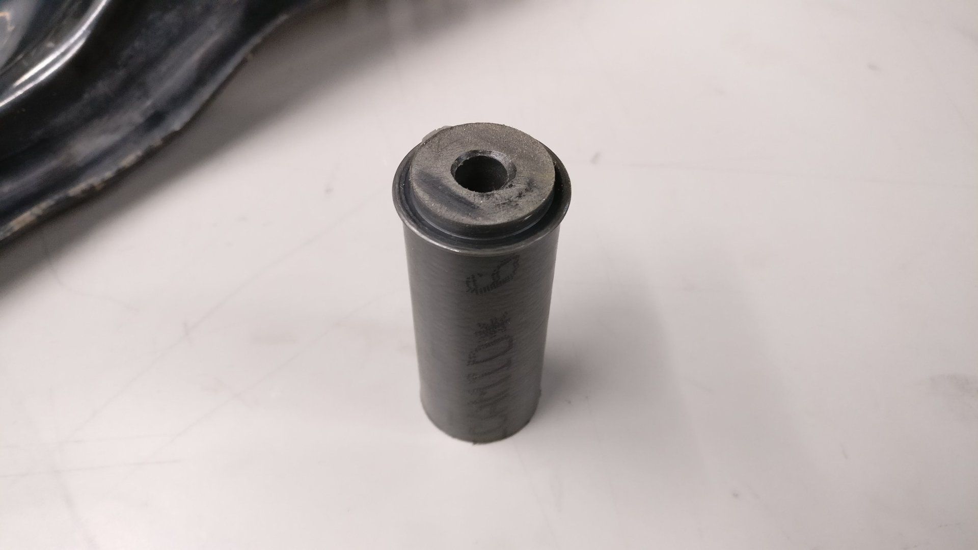

Here is the spacer I turned out of Tecamid-66 (Nylon) for the long center bolt that re-uses the winch mount on the crossmember.
Here is the full water-
tank assembly that mounts to the truck with 4 M8 bolts. The spacer shown above goes on the bolt in the center (not tightened in the pic below). The straps are bent aluminum flat bar, 2"x1/8" thick from the hardware store. Each strap is preloaded to 200lbs (yes, I stood on it before the bolt holes could line up, LOL), so that tank isn't going anywhere. Used stainless steel M8x35 bolts with a flat and spring washer. I will be keeping a close eye on the straps since aluminum can fatigue and break quite easily in this application. In the long term I would re-do these in 1/16" steel.
The water pump is mounted to the center extrusion using a simple tapped 6061-T6 plate and screws. I mounted the pump to the top of the tank to minimize road debris, damage etc. I had a NorthStar 1GPM 12v pump lying around so I used it.

I wanted the tank to be as high up and tucked away as possible. So I made some spacers for the cross-member bolts. Sorry I dont have pics of those but I think the front ones are 1/2" and the rear ones are 1.5" long, so it makes the rear of the tank much higher for departure angle.
Final Mounting:
You can see here how the rear 1/4 of the tank is well above the muffler. The entire tank sits above where the spare tire used to, so I think this will be good enough.

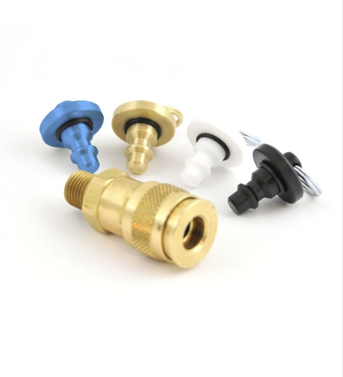

This is the quick disconnect bulkhead fitting on the rear bumper - unfortunately it isnt self-sealing but this hasn't been a problem. If the fitting gets gunky then all I have to do is turn on the switch, water flows and it cleans itself!

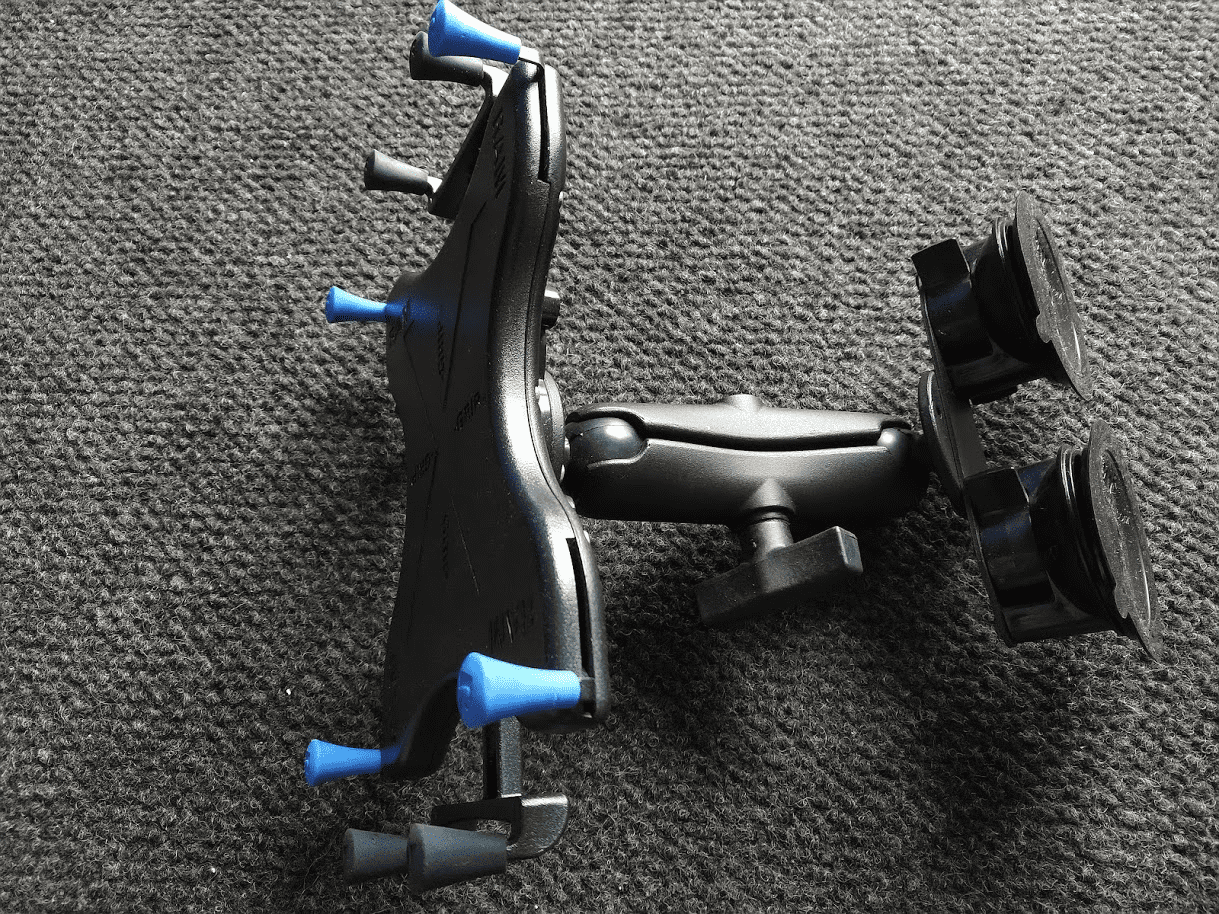

After trying a few cheapo iPad mounts I needed something solid and vibration-free that
- was within normal driving field of view (this excluded everything like trans tunnel or seat track mounts).
- was easy to move from vehicle to vehicle if needed.
- was easy to install.
I put together a RAM mount which has worked really well now over thousands of miles. The suction cups will stay attached all summer long and it really doesn't affect the driver's vision out of the windshield as much as it looks....
Parts List:
1.5" double ball mount, 7.5" length: RAM® Double Ball Mount with Two Round Plates
Twist Lock 3.3" Dual suction cup (mine isnt this exact part number): RAM® Twist-Lock™ Dual Suction Cup Base with Ball
X-Grip Holder for 9-10" tablets: RAM® X-Grip® Universal Holder for 9"-10" Tablets
I tried it initially with 1" ball mount and extension but the key to stiffness is really to use the 1.5" RAM ball.
The 1.5" ball and arm are the perfect length to move the suction cups down so they're not visible behind the ipad, and because the arm lays down on the dashboard the vibration goes down to basically nothing. From the pic below it looks like the clear vision would be affected for shorter drivers but it hasn't been a problem for me at all.
