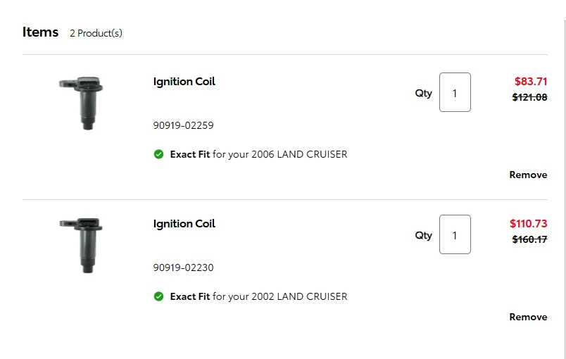

Toyota lists different part numbers for these rigs, but denso lists the same part. Obviously I would prefer, with the sale going on, to pickup the 16 coils for an 06 which is right now less than I can get the denso from an authorized seller.
Toyota lists
90919-02249, 90080-19027, and 90919-02259 for my 2006
90919-02230 for my 2002
Denso lists 673-1303 for both?
The 06 coils are $20 cheaper than the 02 coils.

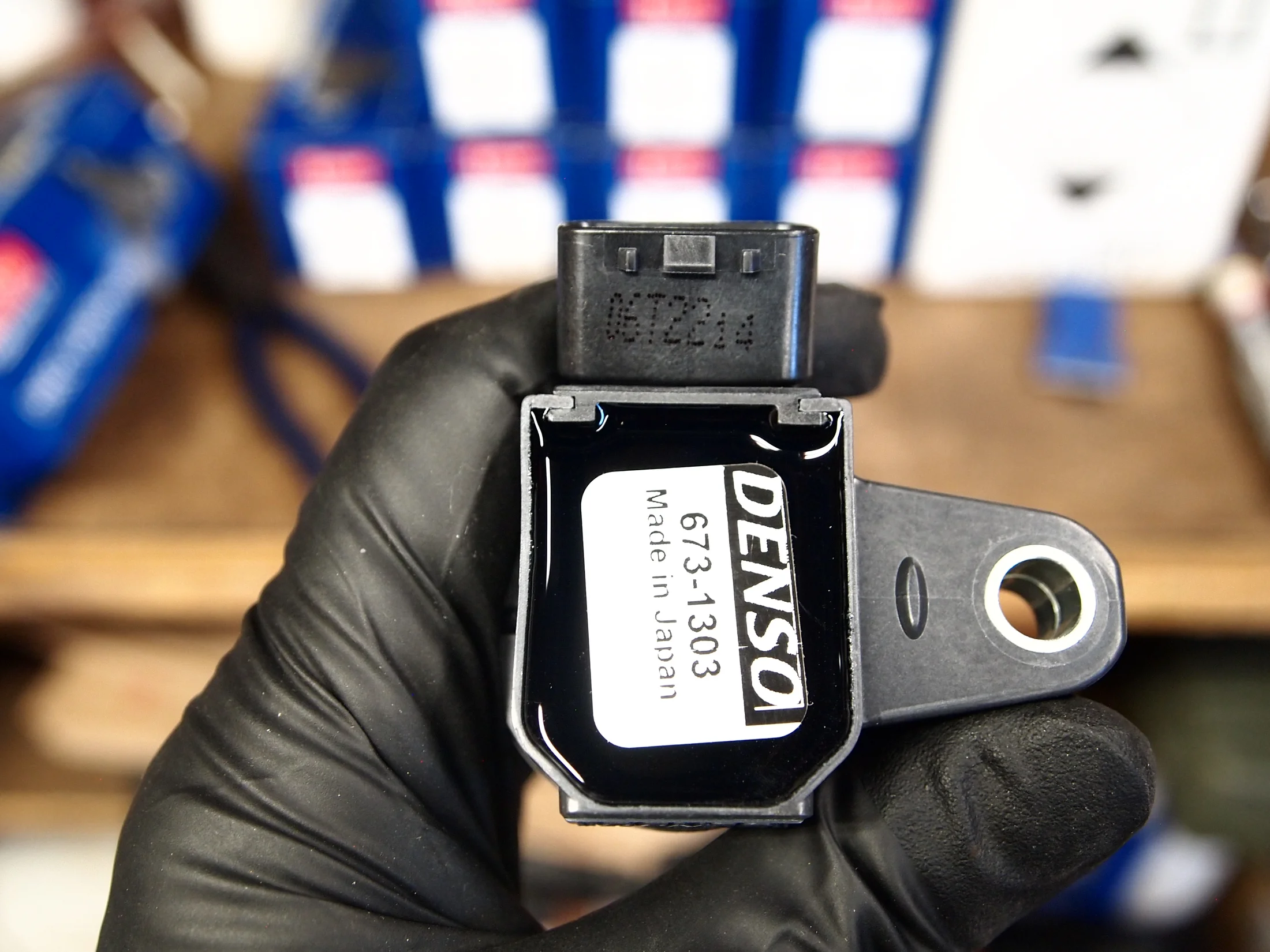

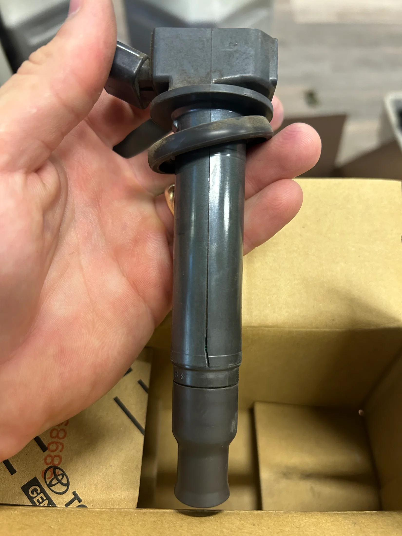

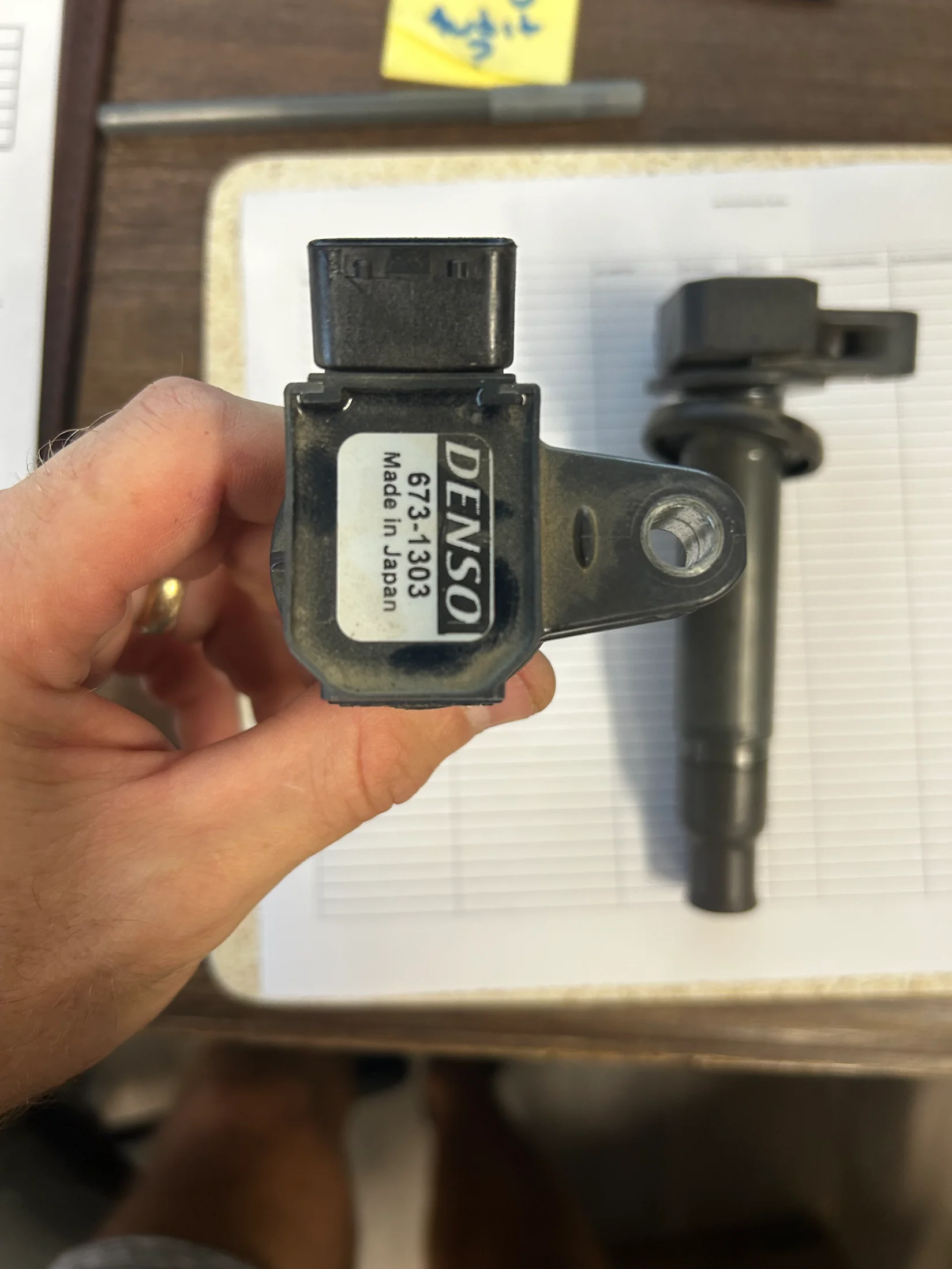

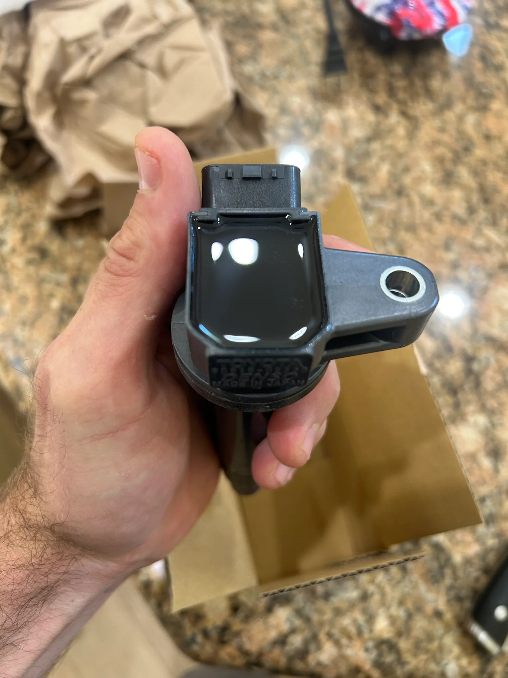

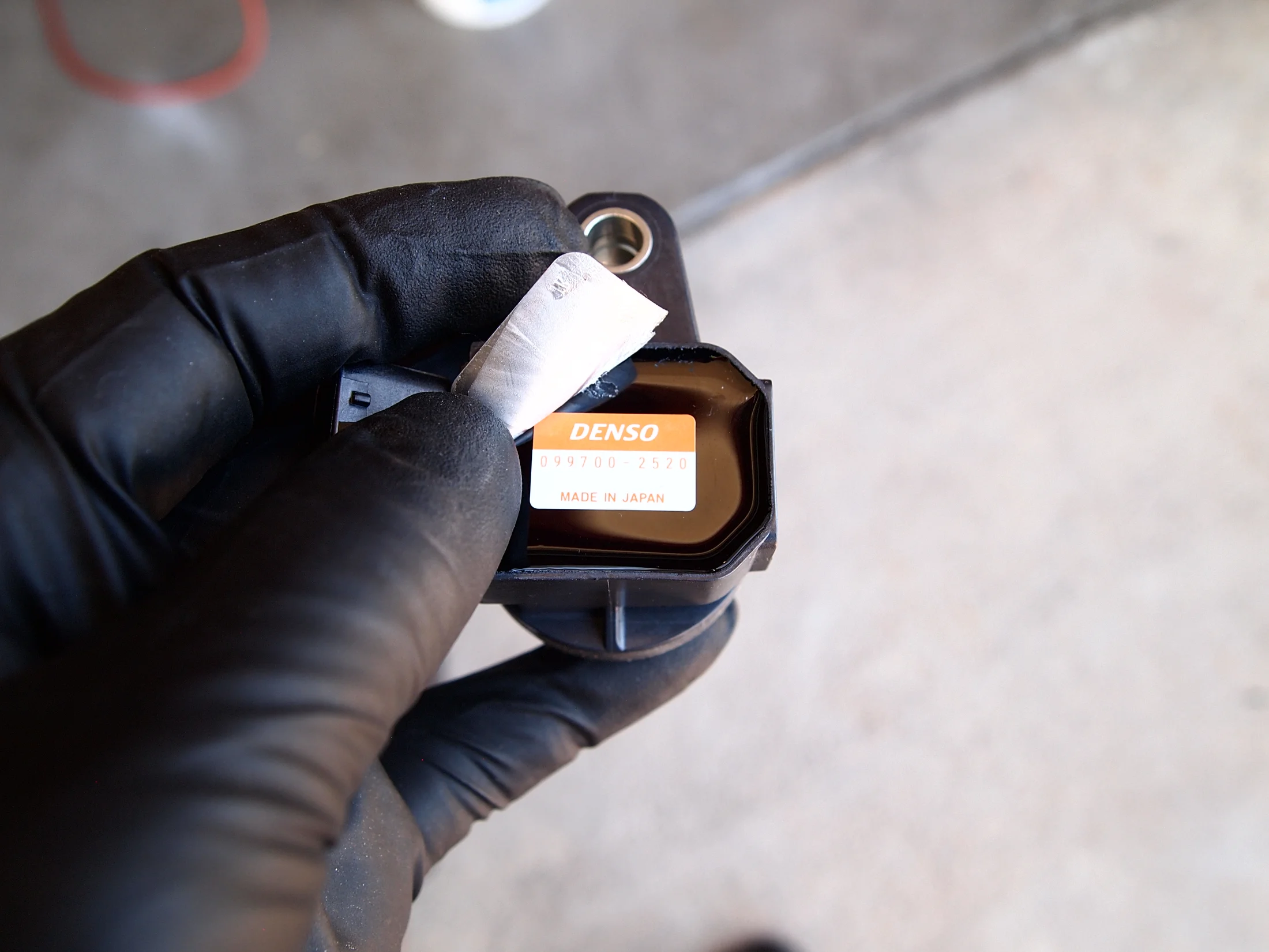

So I just did all of the coils on my 02 yesterday with 90919-02230’s. 270k miles on the originals. All had cracks. Original owner replaced one coil with a Denso part # 673-1303. From what I can tell, this part is the same as the 90919-02230 but with the toyota logo machined off and a denso label thrown up top. Here a few pics for reference.
The boots on the 90919-02230 seem to be of much better quality than the Denso # so there may be other differences as well that are not exactly noticeable to the naked eye.
No matter how many argue, a part with a Denso label and a part with TOYOTA and Denso labelled are very different in built quality. If you can afford go with OEM toyota coils. It is not about aesthetics, it is about the composition of interior parts, what percentage of certain mineral goes into the coil, what resistance, heat tolerance., etc., are far too superior in a TOYOTA part than a part with Denso. It goes into all parts.

Speaking with Denso tech support. Rep said; Toyota logo ground off, mean Toyota gave Denso permission to sell in third market. Did he know what he was talking about or blowing smoke. IDK! But, why not caste with only Denso, and save time/cost grinding off something.:hmm:
The real Denso with top half ground off and lower half said made in Japan. Had a sticker on top with part number. If sticker removed, another part number was under it. IDK, what that other part number was for. But it is what motivated me to call Denso and question the coils made in Japan.
Today when we but Denso Coil from authorized distributor. They don't have this extra peel off sticker. They're also now made in China.:frown:
