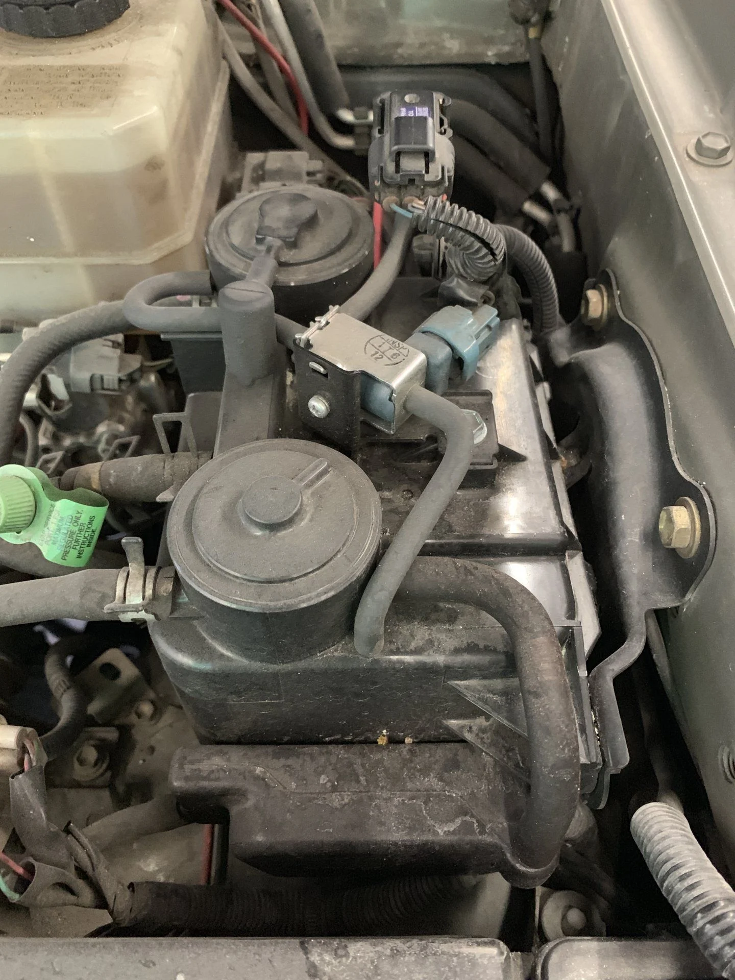

If mine ever fails I would like to convert from my original that is under the hood to the design that is mounted near the spare tire. Has anyone done this conversion to save space under the hood?
I would guess that is more work than it's worth.

I just went through this, and no, there are no suitable aftermarket ones. I cut my canister in half with a reciprocating saw, dumped out the charcoal, went to Petco and got some aquarium carbon, refilled it, sealed it up with a metric ton of RTV and huge HVAC zip-ties. Total cost maybe $40 instead of $400. I was getting a CEL frequently and it has now vanished. More details here: Charcoal Canister Replacement Option
Has anyone tried replacing the older model ones under the hood with one of the newer under-body ones (placing it under the hood)? I would think the basic structure would be the same aside from some line routing and mounting, but that can't be too hard to overcome. No CELs but it does smell on hot days.
What happens if the canister is removed completely since it's an emissions type device? Friend wanted me to ask.
