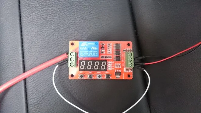

I'm working on retrofitting a pair of 2016 BMW 428xi sport seats into a 1998 LX470. I have a few diagrams, though some of the BMW diagrams I'm currently not 100% certain of having the right ones. I'm putting together information from various threads around the internet to try to figure out the wiring to have fully functioning power adjustable heated seats (because I have a fancy Toyota). I've found a workaround for the CANBUS signal on the seat modules to keep the power alive, using a 5v stepdown coupled with a 5sec timer. Please follow along while I most assuredly **** this up a few times before getting it right.

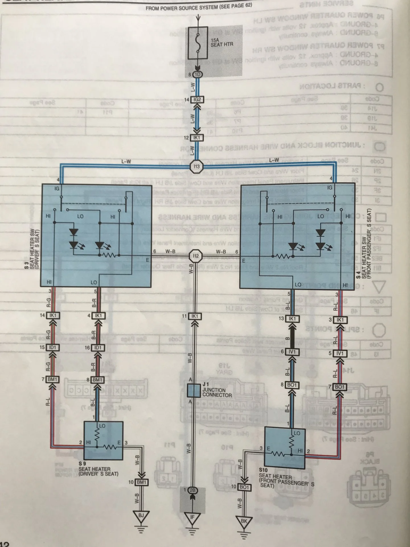

LX470 heater wiring

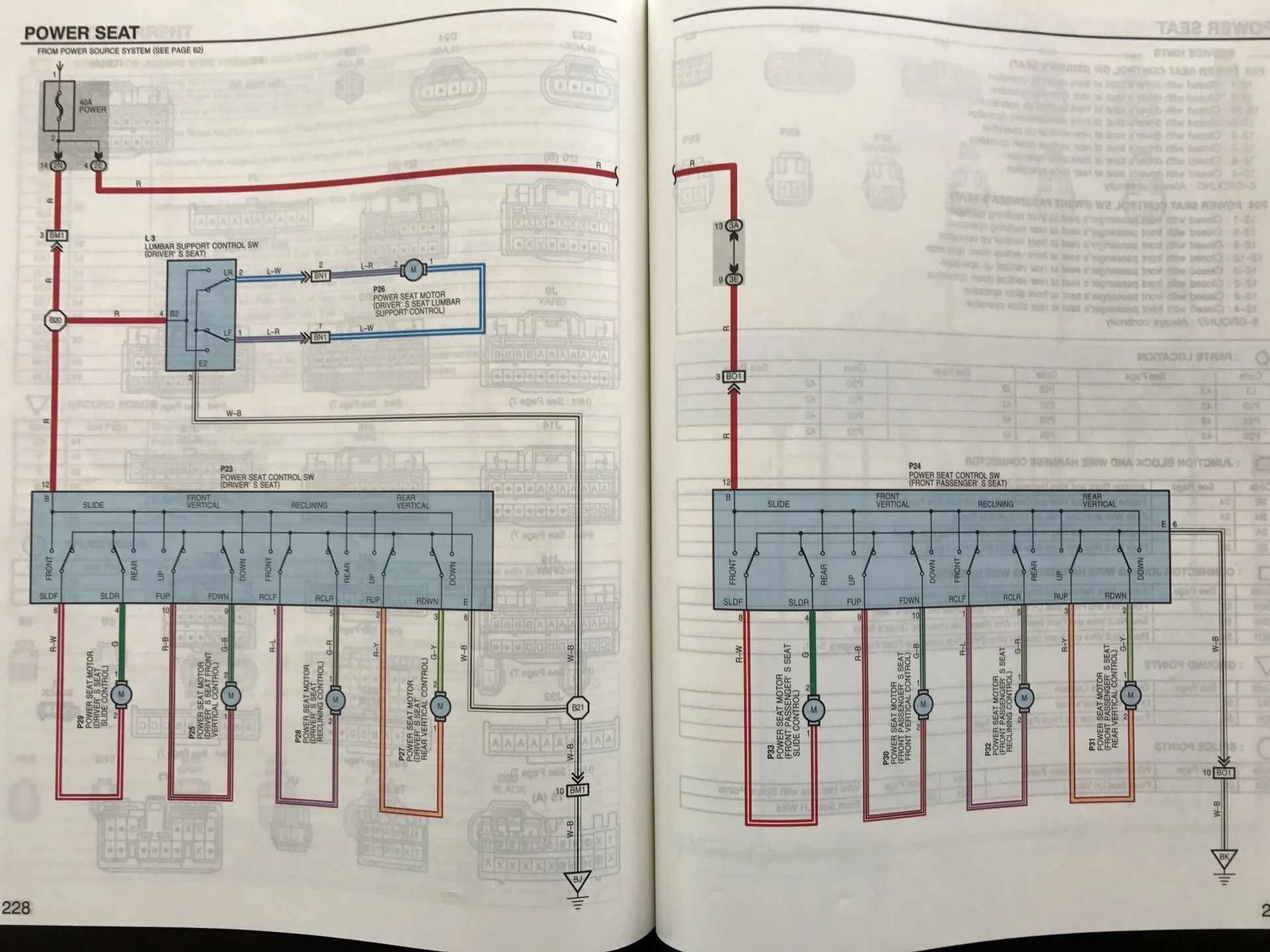

LX470 control wiring

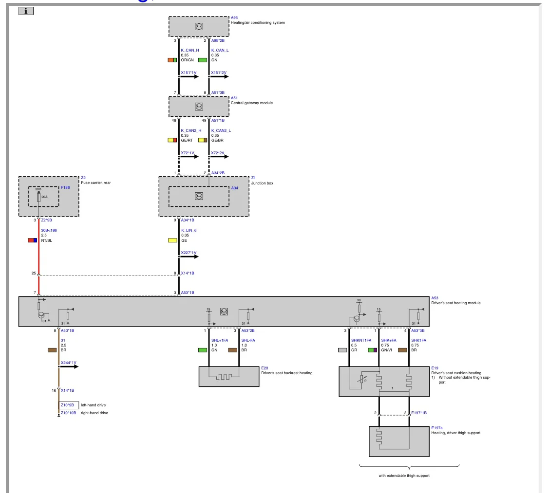

BMW heater wiring

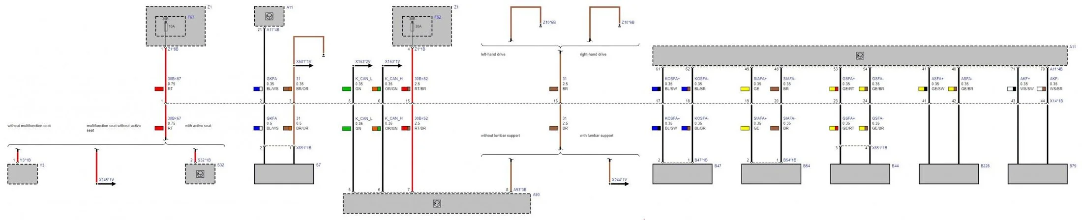

BMW control wiring (may not be accurate for the model)
As best as I can tell, these are the wires I'm going to have to adapt/accommodate. The seat belt sensors are thankfully wired separately.
Driver BMW Seat:
Brown: Ground
Red: +12v 20a in (heater)
Red: Lumbar support
Red: +12v 30a in (controls)
Orange/green (CANBUS): wired to the 5s relay and 5v stepdown which gives it an intermittent signal to keep seat module alive
Green (CANBUS): not wired to anything?
Driver LX470 Chassis:
Thick Red: 12v+ 40a in (controls)
White/black: Ground
Blue/White: 12v+ 15a in (heater)
Passenger BMW Seat:
Brown: ground
Red: Lumbar support
Airbag Sensor Circuit?
Passenger LX470 Chassis:
White/black: Ground
From the above I'm guessing I'm going to have to create my own 20a power circuit for the BMW heaters as the 15a circuit and wiring from the LX470 won't be enough. I should be able to reuse and refuse the 40a circuit to provide the 30a power to the seats for the adjusters, however. In theory. I've already isolated the BMW seat air bag circuits and quarantined them to prevent accidental deployment.
Happy to hear feedback from anyone who may have more wiring expertise than I on this project.
