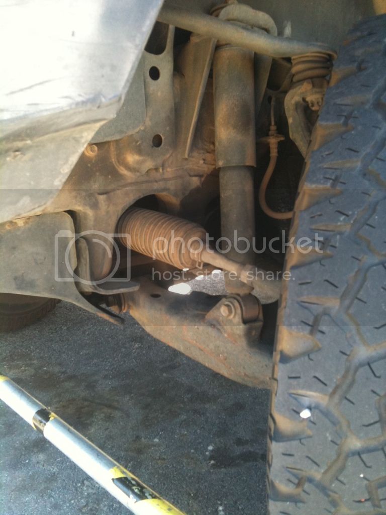

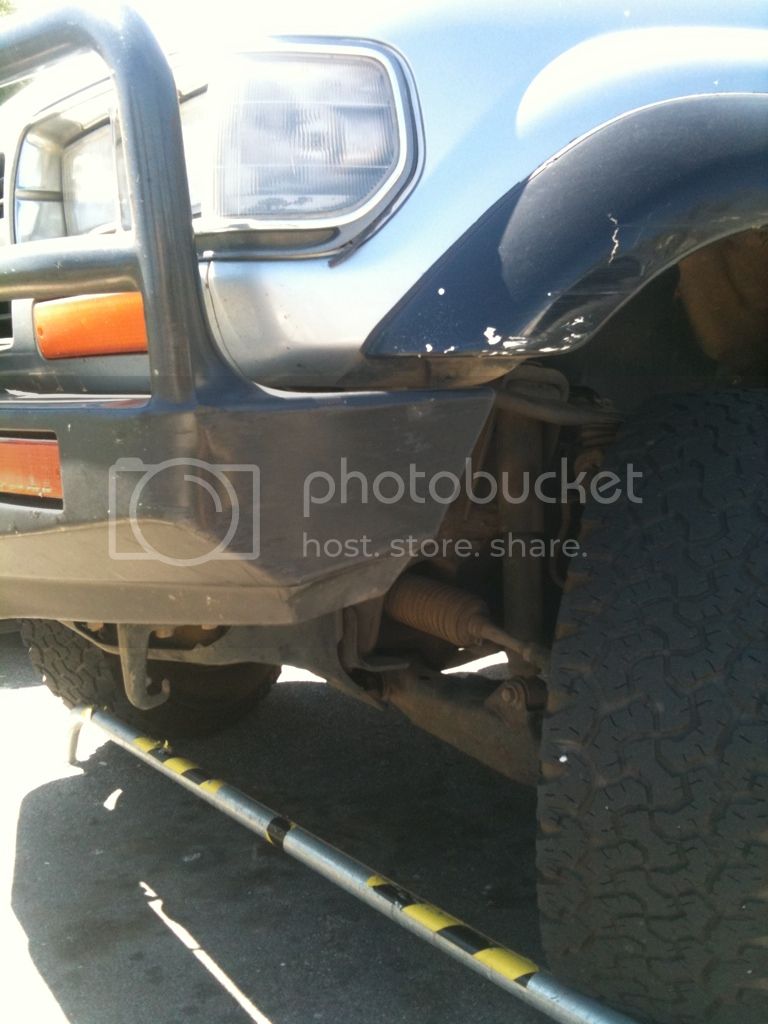

Found the old pics

Found the old pics
What the heck am I looking at? Is that an 80 series with IFS? Who in their right mind did this? My brain hurts.
It's a 100 series. They went IFS and 5-lug with the V-8 :eek:
The owner could have rolled the 100 and found a cheap 80 series body ..ya never know.
I cant find the other pics i had but it had a 100 cluster in the dash and 5 speed shifter console from memory
