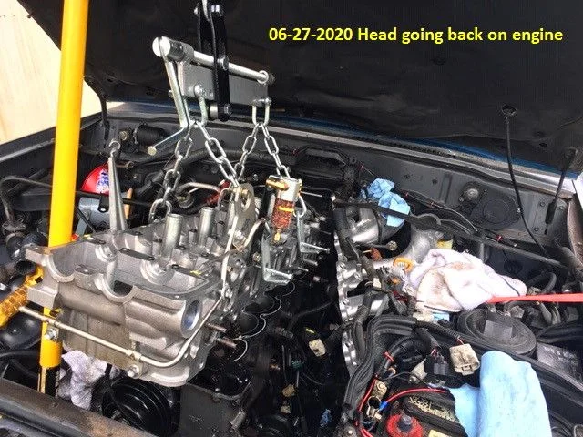

I've done it twice alone and I have a cherry picker in the garage. I felt it was easier and I had more control by just lifting it in place. If you've removed the intake manifold it's not hard. I didn't remove the hood either, but I did set some long bolts with the heads cut off as alignment pins when I set it back on. Just be very cognizant of the head gasket and the radiator bypass nipple.
If you are going to do it alone, get a cherry picker. No matter how strong you are, there is precision involved that you can't get by just muscling it.
I've done a head job twice by myself. Both times I used a hoist.
I couldn't agree more. I did my '92 FJ80 head gasket last year. I removed the head with much difficulty by using blocks and plywood to lift the head over the radiator. It was time consuming and could have caused real damage. I got a cherry picker for the reassembly. I could see no way to lower this behemoth without damaging the new head gasket without the cherry picker. My sense is that you need to lower the head onto the gasket in a controlled, very slow way to align everything and not dent the cylinder crush seals.
No, other way around. Depending on your cherry picker, the length of the arm and whether or not you use a leveller you probably need to remove the hood to allow clearance of the hoist.

It may be because my cherry picker is old and beat up, but the reason I preferred setting by hand method was because with one person you need to align the head in three planes with one hand while turning the bleed screw on the hoist using a long extension with the other hand. My cherry picker tends to drop quickly from a stop. I don't have as much precise control with the hoist as I do with just using my arms.

Engine hoist and a leveler make it a LOT easier. Pulling it is not that big a deal but reinstalling it requires a bit of finesse.
