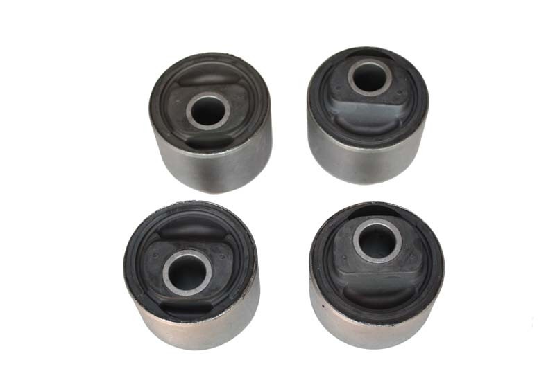

That's why I recommended this last week.Yep, need some caster correction.
or![]()
Dobinsons Rubber 2.5° Caster Bushing Kit for Land Cruiser
Dobinsons RB59-522K Rubber Caster Bushing Kit corrects the front caster angle when you lift your Land Cruiser 80 Series anywhere from 0-3"exitoffroad.com

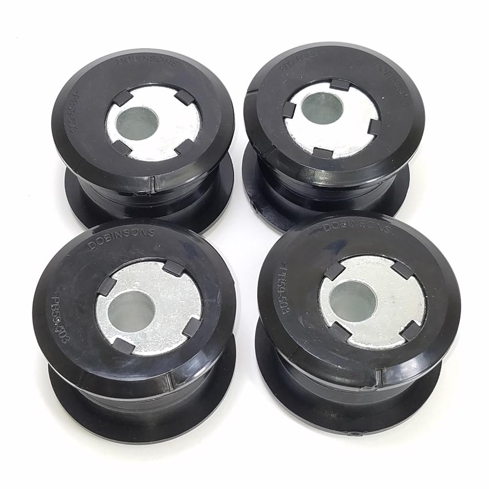

Dobinsons PB59-503K Adj Front Poly Caster Bushing Kit Land Cruiser
This PB59-503K Adjustable Front Radius Arm Caster Bushing Kit is designed for the 1990-97 Landcruiser 80 Series Wagon 105 Seriesexitoffroad.com
I'd go for rubber at that height.
Edit: Also, old worn out stock springs would be lower than stock which would have even more caster (heavier steering), so the difference from that up to the new height would feel quite different without correcting the caster for the lift.
