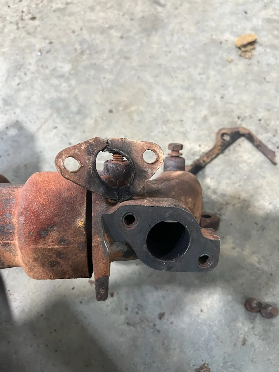

Also trying to identify this gasket if anyone has any pointers. Didn't have this one on the 40, but trying to retain the 60 manifold to get rid of a leaky set of headers on the 1.5F

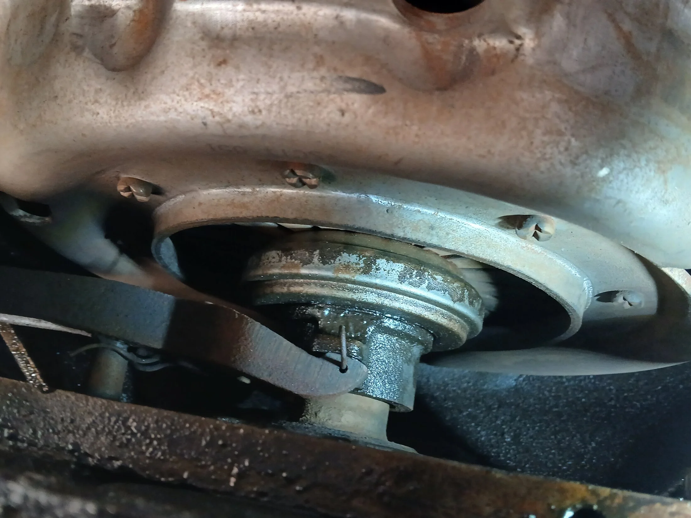

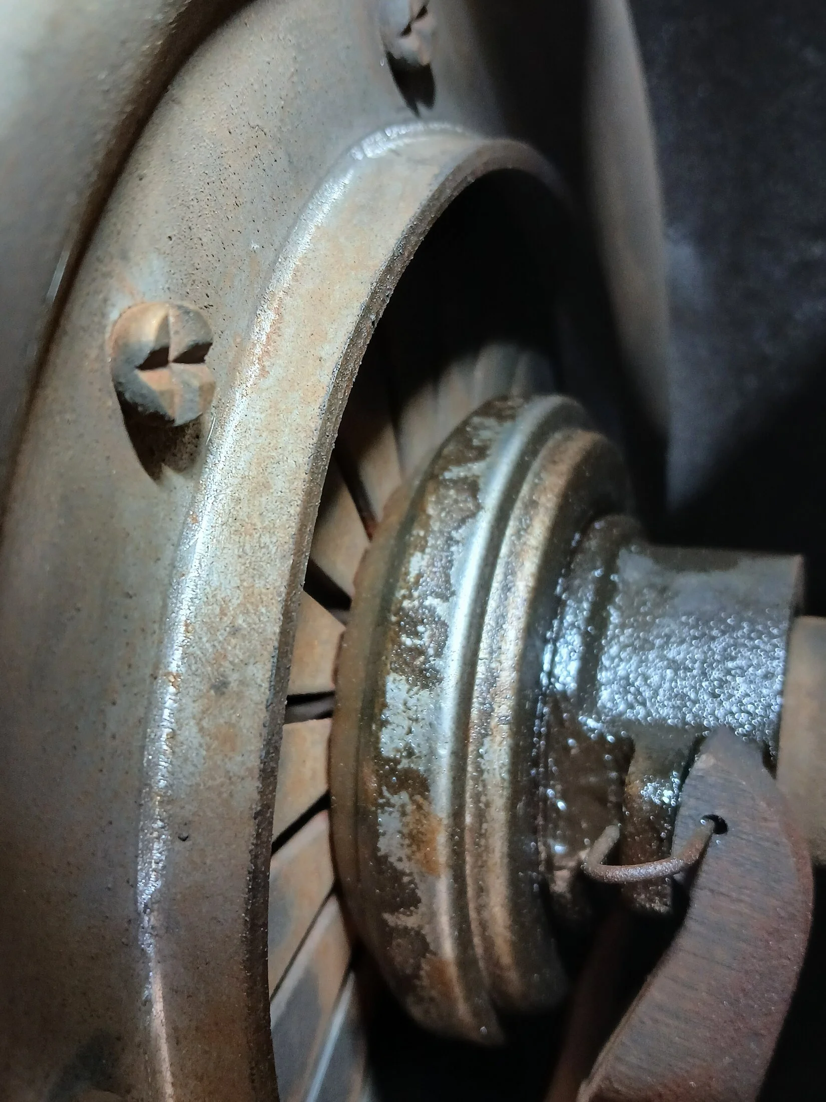

View thru the inspection cover as we're chasing down the noise, first clutch job. I noticed the clip is touching the back of the TOB, but that side should not spin, correct? New bearing seems right still, here's a video of the movement.
Noticing now the throw out bearing and carrier direction looks different from other threads I have seen. Not sure if the install is incorrect or the it's just a different part.

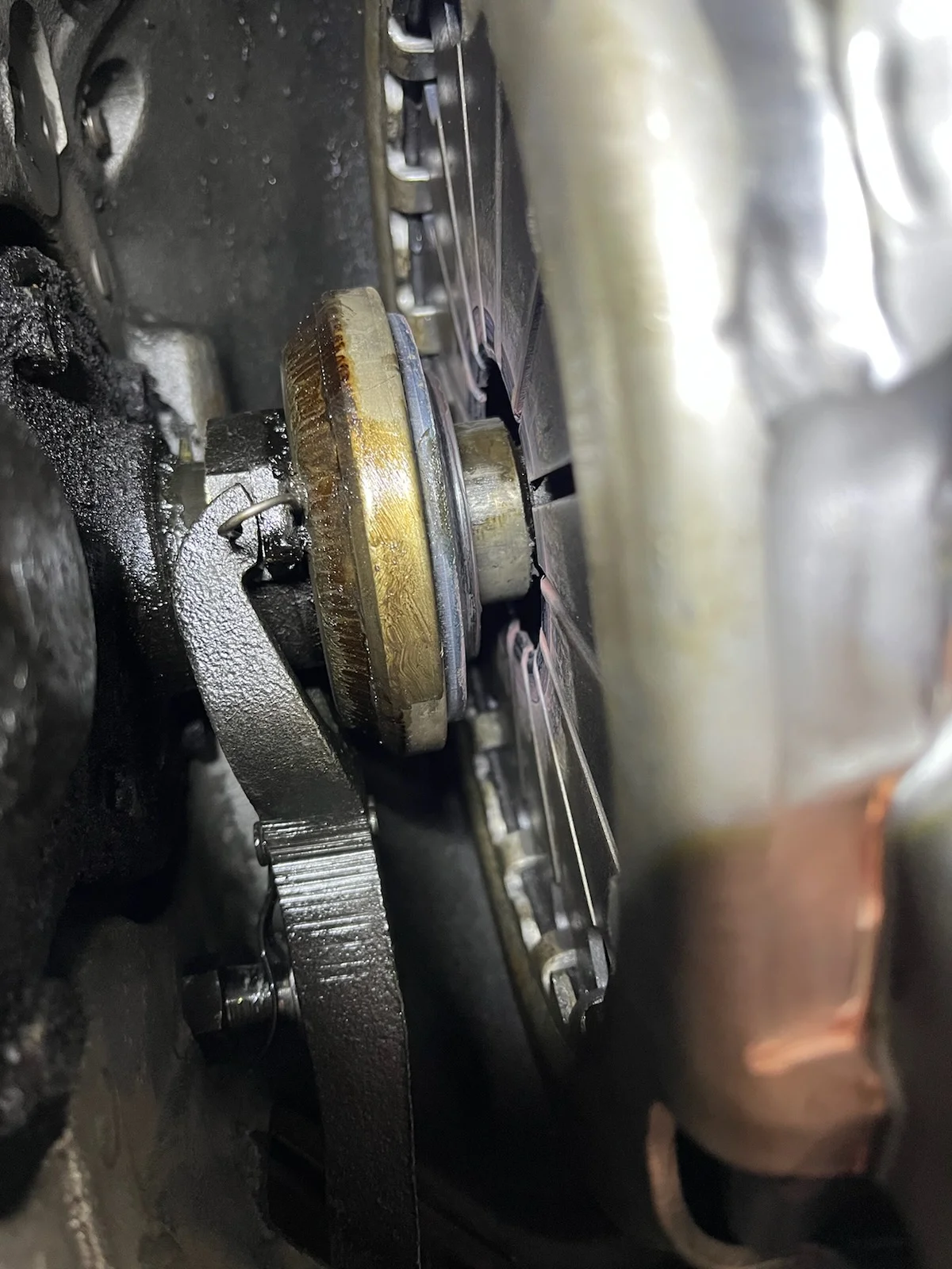

That's not the OE Toyota ( Nachi ) bearing, so it's hard to tell, but I think the TOB is in backwards. See how you've got that scrapping on the Pressure Plate fingers?

Looks like the OPs TOB is backwards.... And using the 1.5F TOB hub.
Concur TOB is backwards. Hub is probably 2F, the clips for the earlier hubs are very different and don't work with later hubs.

Good pic, Pighead.... Looks like the OPs TOB is backwards.... And using the 1.5F TOB hub.
My reasoning was also backwards TOB, that's what I was trying to confirm. This is (should be?) the correct later model clutch hub, but I think it looks weird with the bearing on backwards. I supplied a new hub for install. Planning to replace with factory bearings this time since its gotta come back out anyway.
