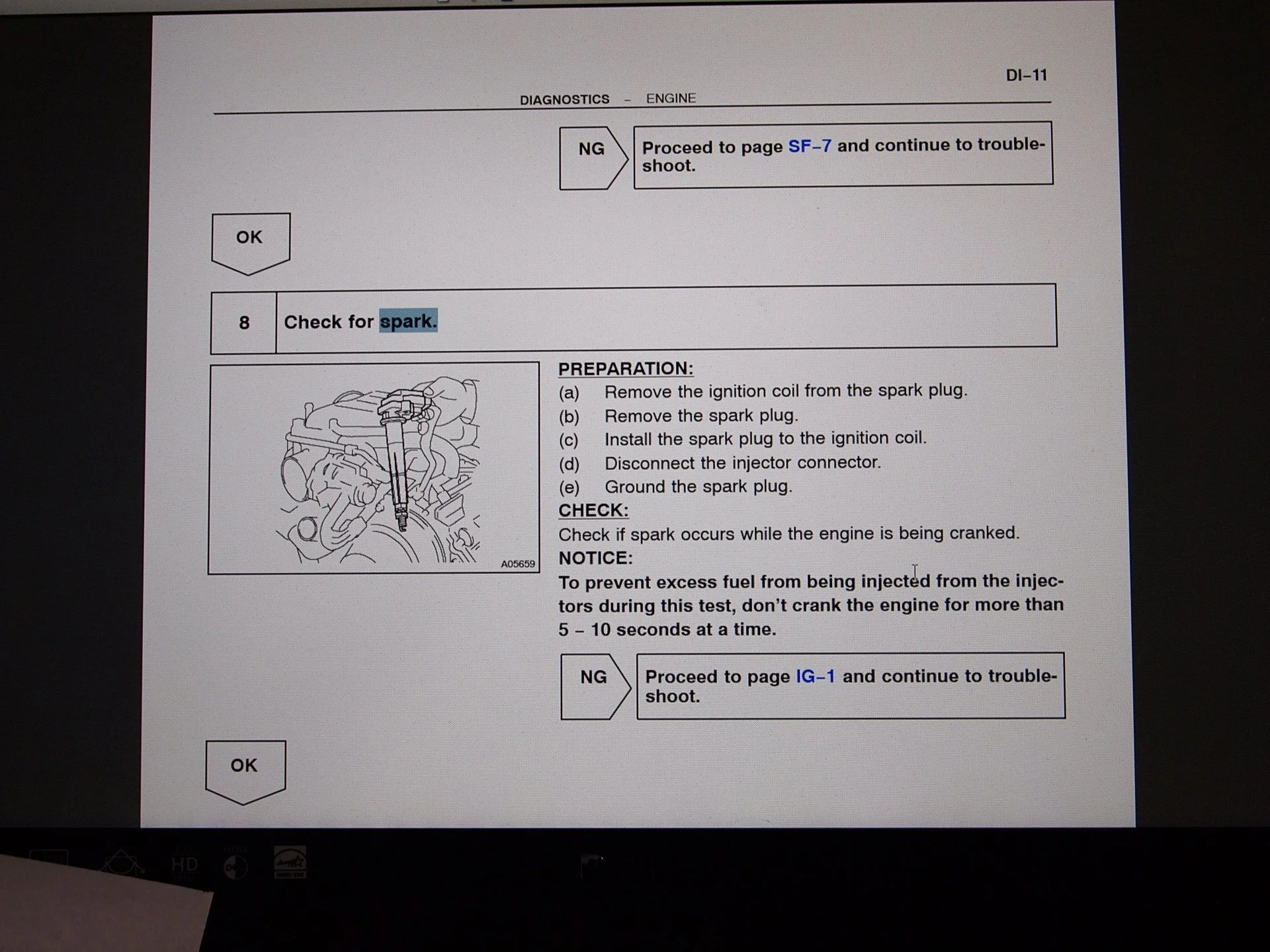

This is done to confirm bad coil, once you've a CEL that points to bad coil.

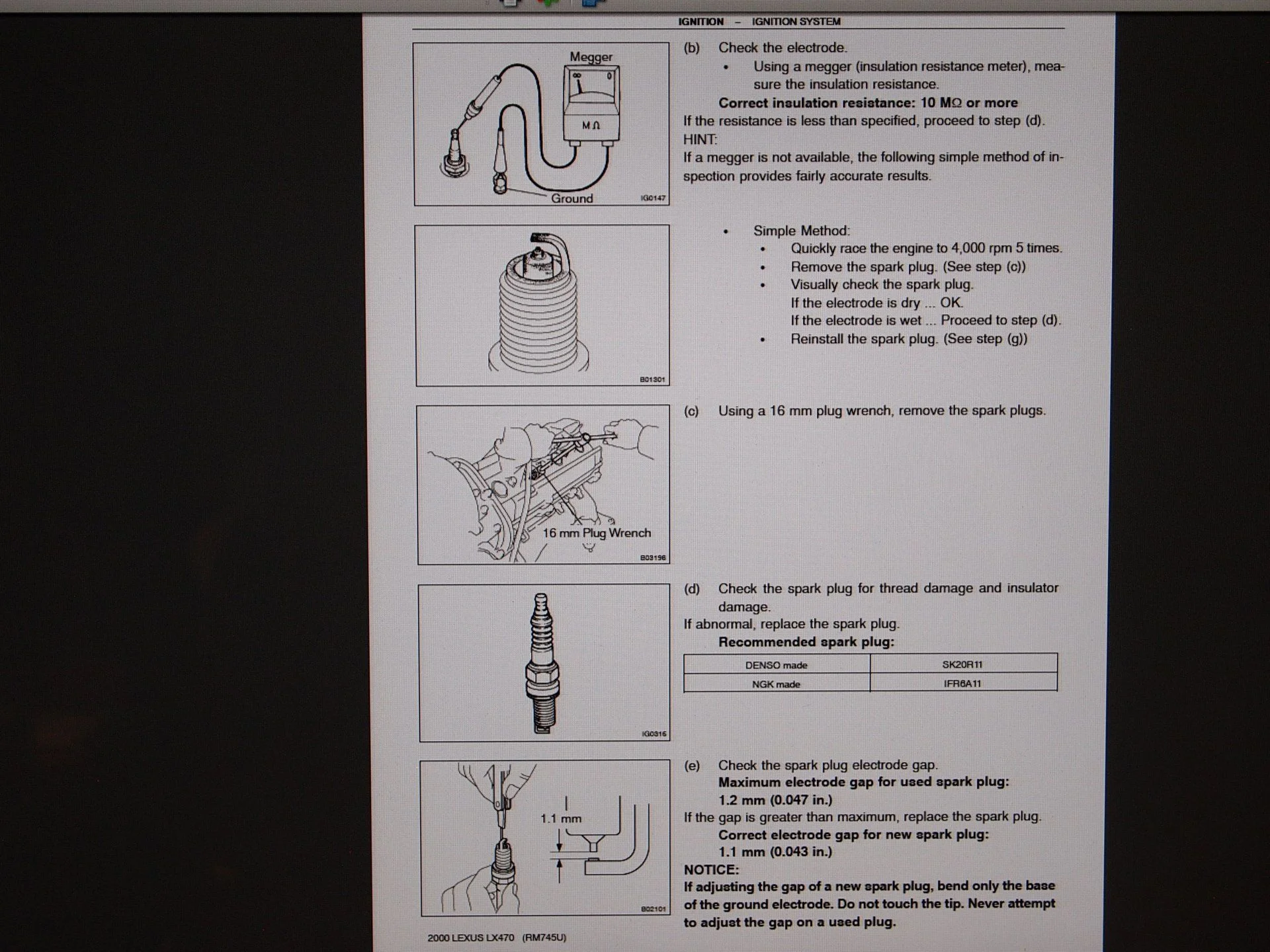

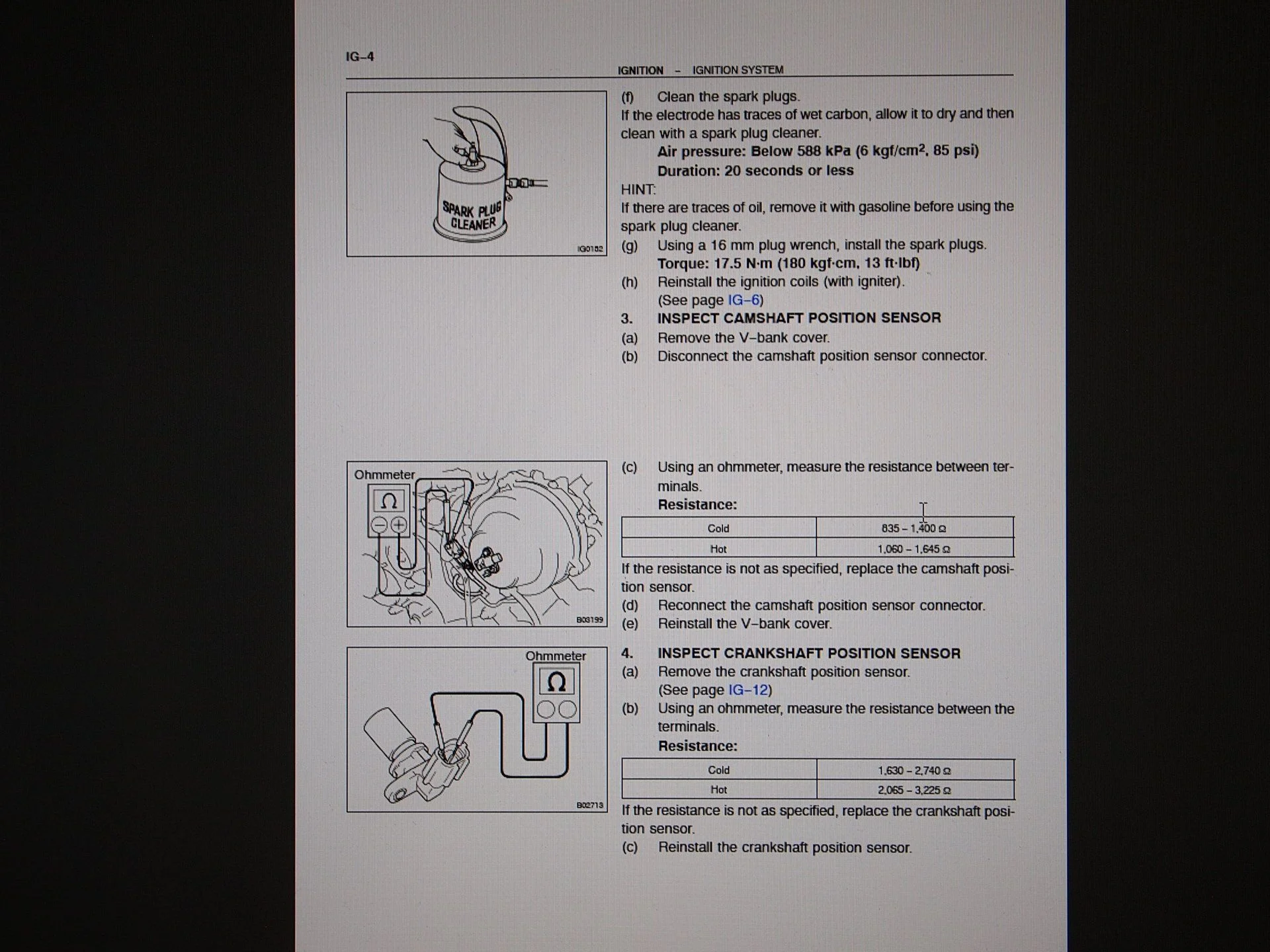

Spark plug service
View attachment 1612614 Spark plug service
View attachment 1612629 View attachment 1612628
