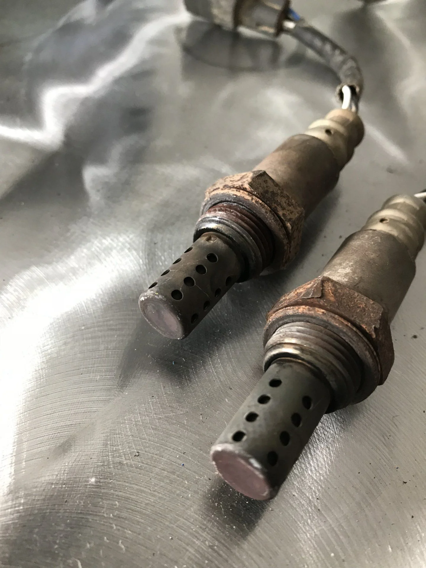

Here are pics of the old downstream O2 sensors.
Here are the old upstream O2 sensors.
As you can see, the upstream were in better shape. Not sure if I needed to change them or not, but I did.
