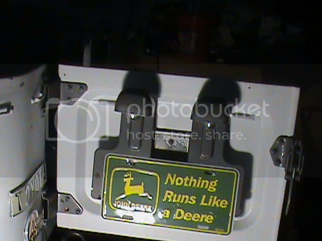

Here's the rear plate on my 40. Yours is probably different!
IT attaches to a bracket with 3 screws on the rear door.

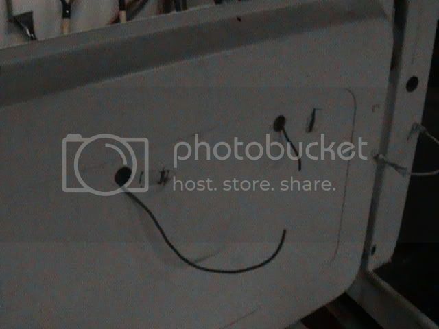

The wiring exits through 2 holes with an attached ground to the door on mine.
How does it tie into the marker lights, if you have them. I do have about4 or 5 female butt connectors in my rear harness that I know are where they tie in, just looking for the routing i.e. the pigtails that plug into there. I also know there should be a hole in a rear wheel well w/grommet...
