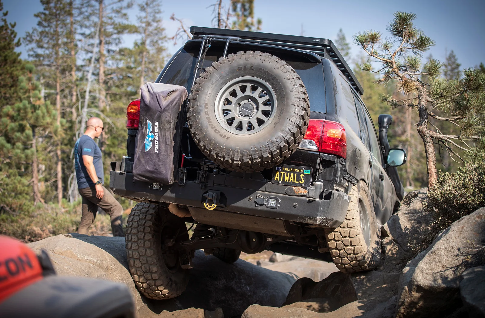

We ran Rubicon again last year and had 3 Cruiser's(100's & a 200) and one of the reasons we run zero offset is because we use our rigs offroad! I know @TeCKis300 makes people think you can run a 35x12.50 on a 200 if you just pick the right offset wheel, just not true, it may be less rubbing, it may rub in different areas etc... I have wheeled with over a dozen different 200's with 35x12.50's, all different setups, different offsets, lifts, spring rates etc... If you actually push your rig and wheel it offroad and don't limit the rear up travel with bigger bumpstops it's going to rub🤪

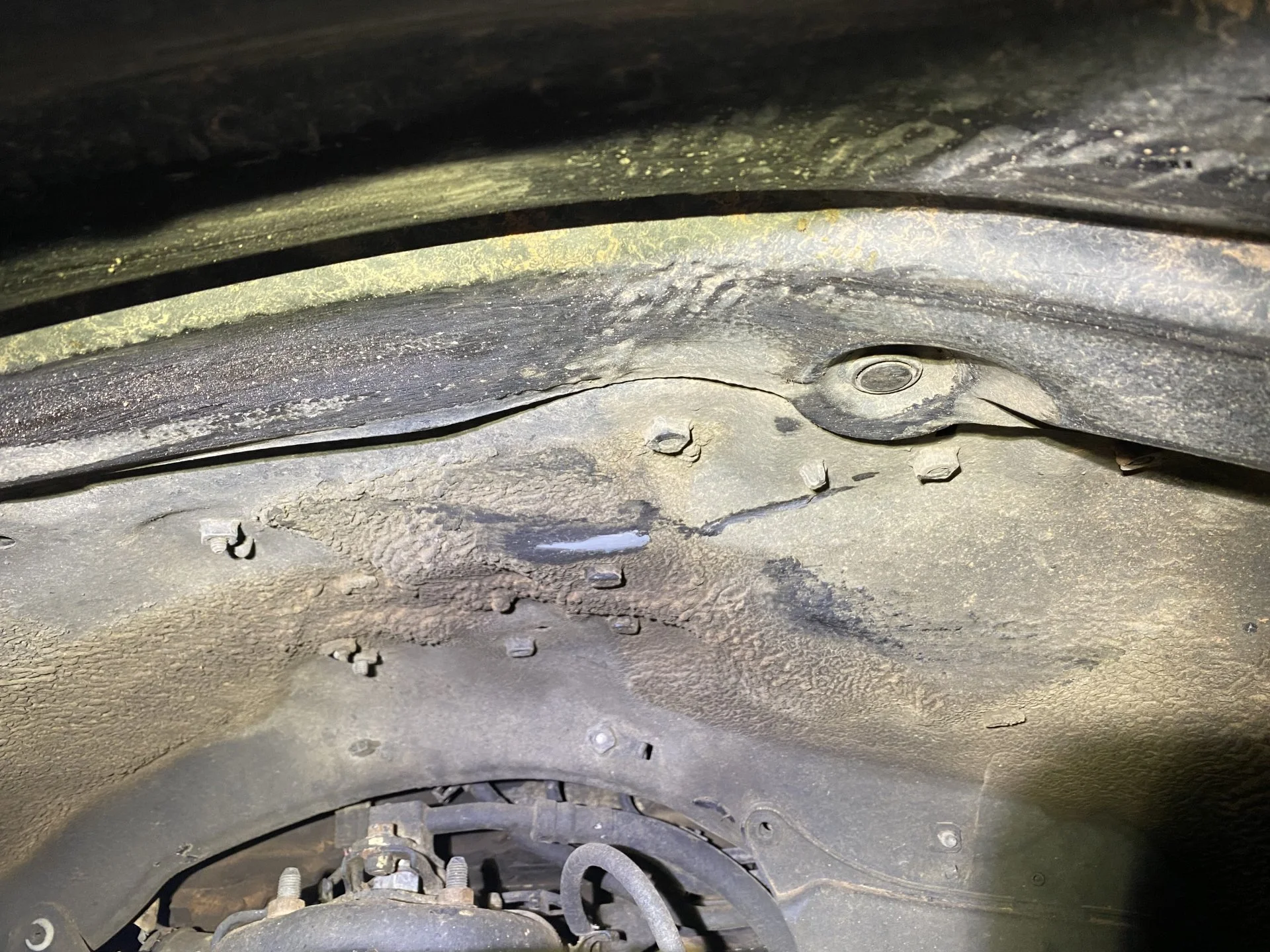

Yep. On Hell’s gate… my rubbing was on the in er top of the rear fender. It basically rubbed a spot through that black crud/coating in there at one spot to the smooth metal beneath. I did not add bump stops in back and it allowed the touch. No real harm, but on full, deep, slow stuff…it definitely touched there.
I was fine in front…but over time I was tweaking my end links badly.
Since then…other solutions have been found for the front end that definitely work, and effectively prevent end link issue. I did my 35’s back in 2017. Lots of little discoveries since that time. Totally doable.

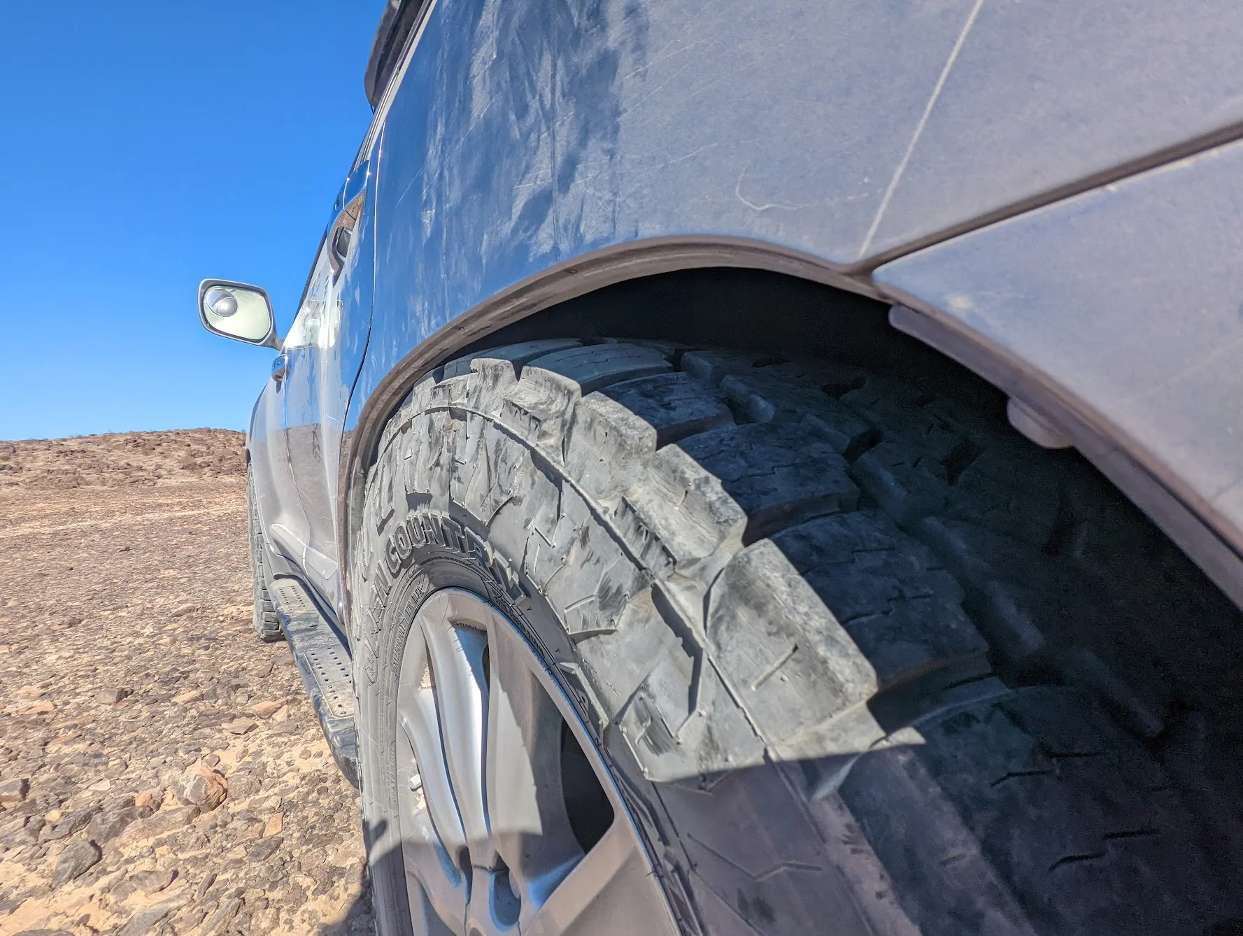

My Falkens 295s on stock wheels + 1.25" spacers rubbed the same way in Moab on my supposedly less flexy LX. Was just sharing these with @radman last night
