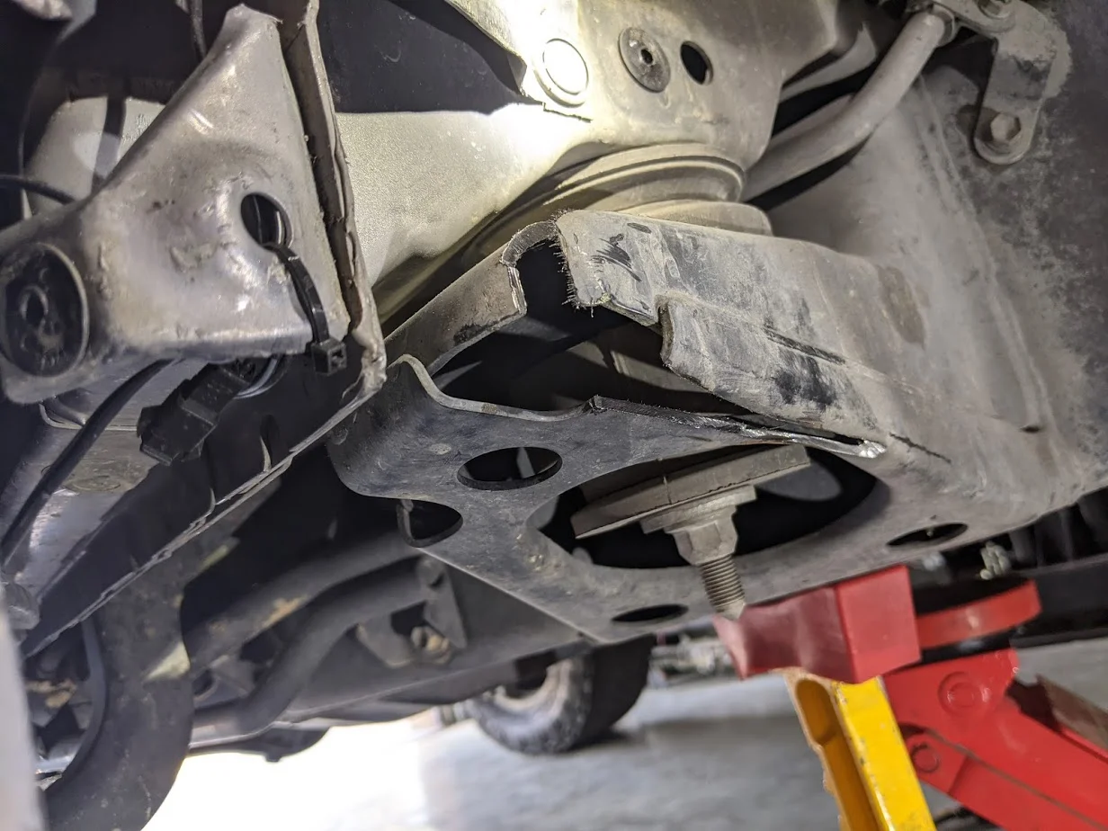

Why is BMC such frowned upon here? Coming from 2 Gx that had to do a bmc for both to run -10 offset I didn’t see anything wrong that would affect structural or engineering integrity if the vehicle. I would rather do a bmc than KDSS relocation kit. Is there a +25 offset wheel with 35s setup where I can avoid KDSS relocation but do bmc on an 18” wheel?
not sure why the BMC is so frowned upon on the 200 group, all my buddies with fj's and 4Runner's did it, s*** they had a party and had half a dozen rigs and we just started cutting, no biggie. I ran 20mm offset with 34's and was just kissing the KDSS bar, I think ya need the zero offset to pull away from it for the 35's, just my 2 cents.
I think it’s more of what are the limits and what’s next if one doesn’t work.
also how far one would go to achieve it.

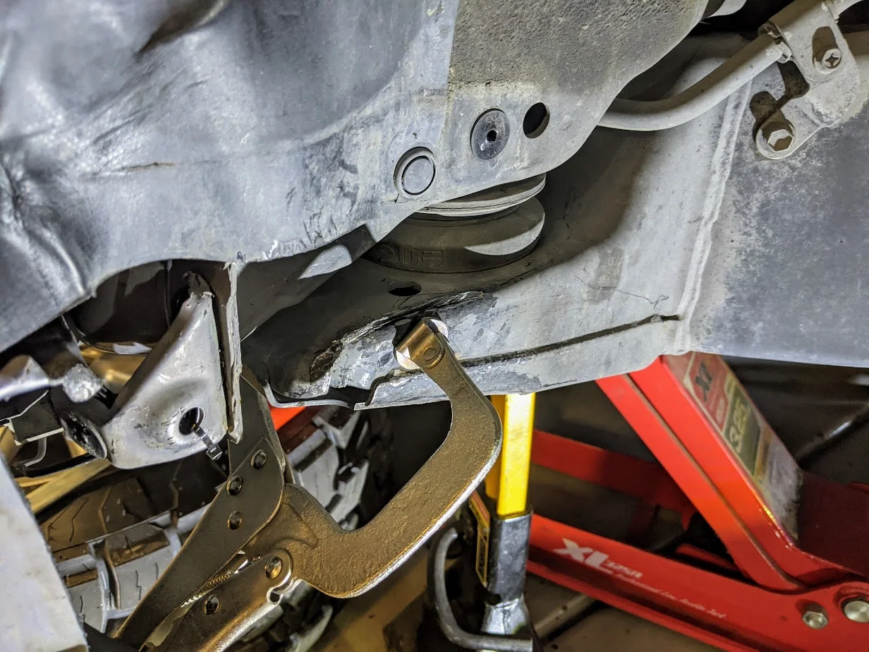

Agreed. It's interesting how hard we seem to avoid BMCs on these boards and do just about everything else including risking CV angles. BMCs are used ally day long on every other Toyota platform and there's lots of shops that do it.
Don't even need a new plate. Just cut a pie shaped strip out behind the face, bend it back, and stitch her up. A 2 hr job.
