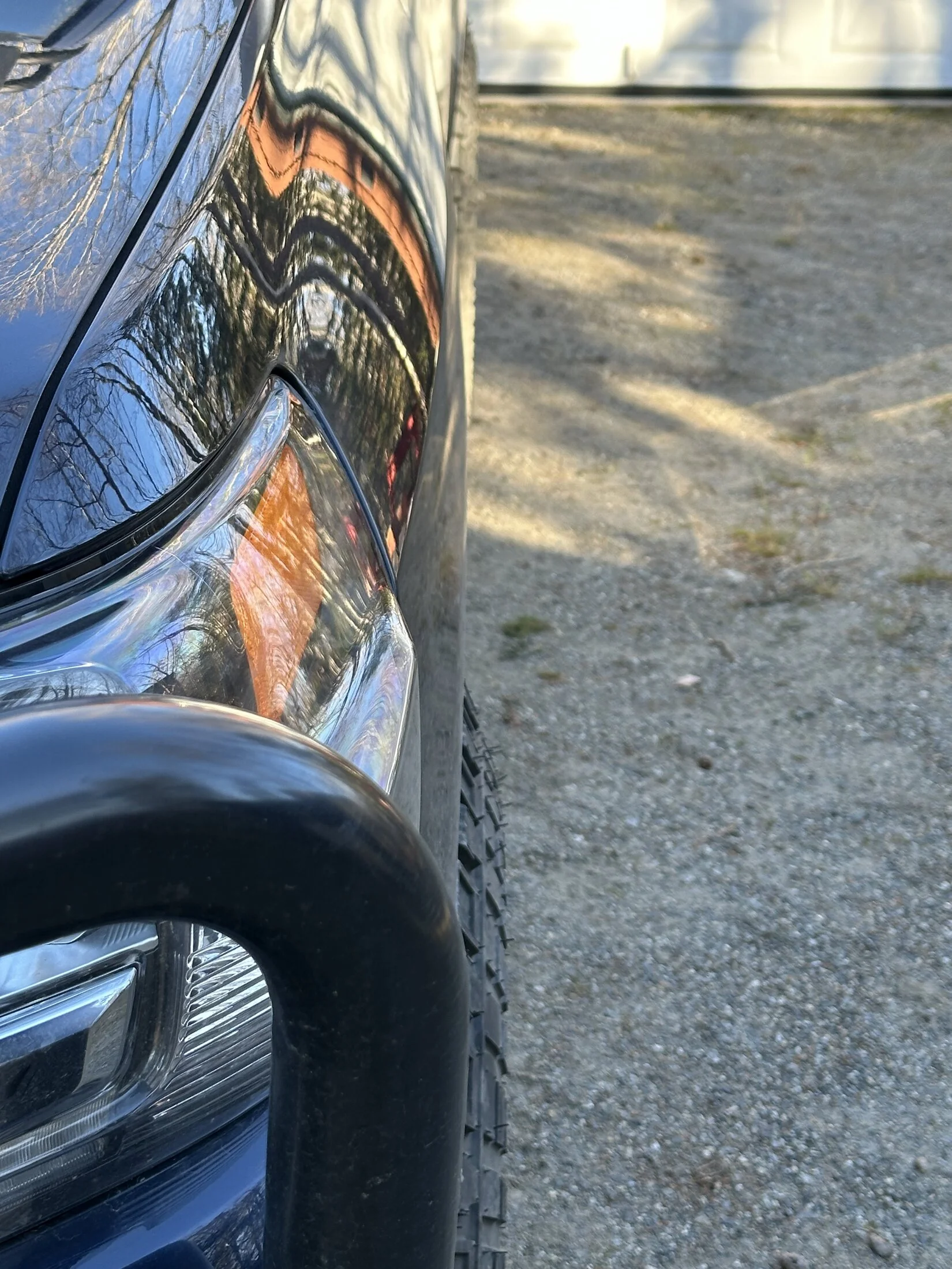

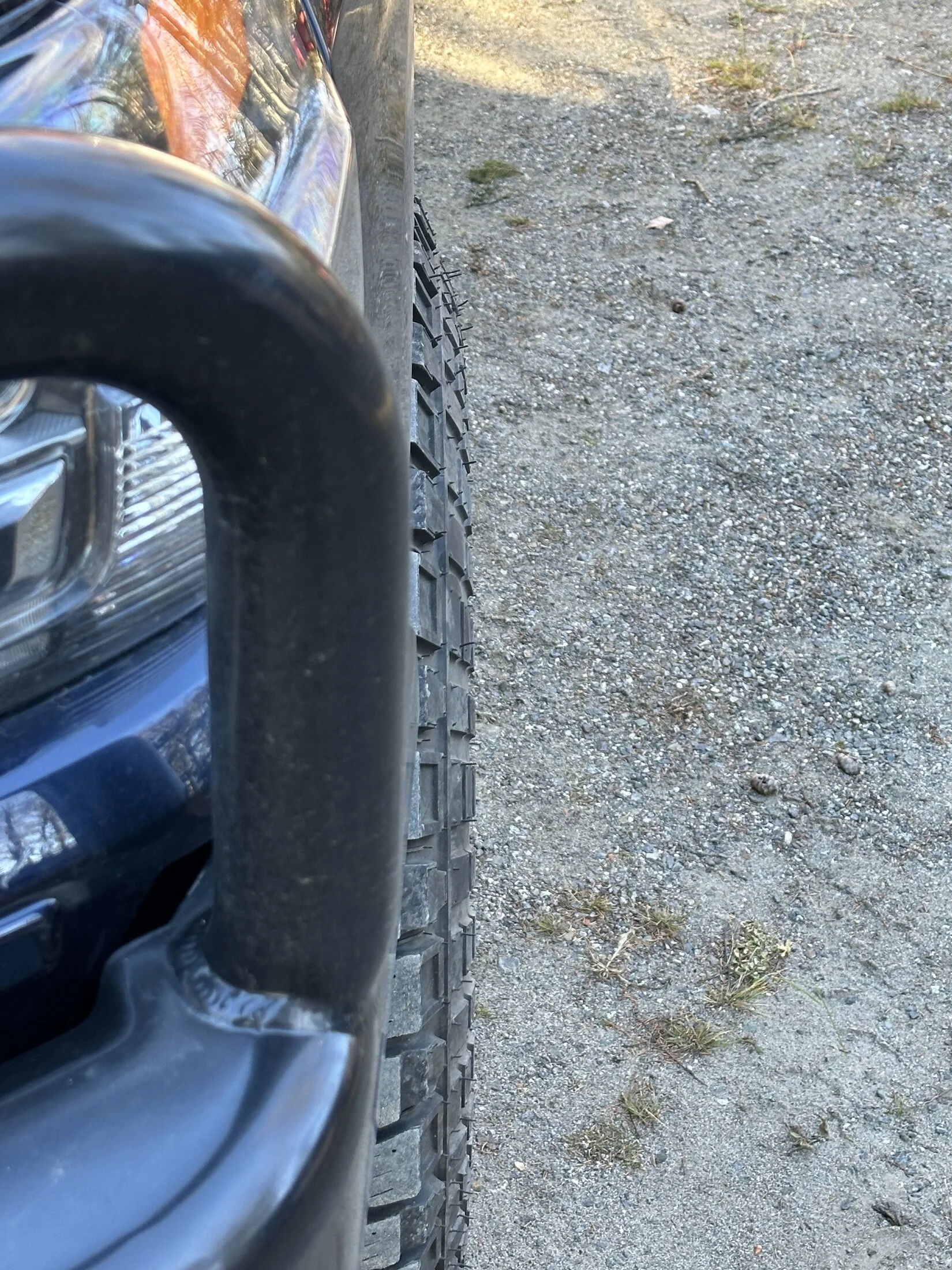

Any side pictures to see the “poke”?
I haven't owned that Cruiser in over 2.5 years now. This is the best side profile pic I could find for poke. The tire was maybe 1/4" outside of the fender.
That’s perfect. I keep reading how the raceline 17x8.5 wheels with 0 offset will look and perform terrible, but yours look great in the same size tire I’m using so I’m inclined to give them a shot.
There are quite a few who run a +/- 0mm offset. I had to do a little trimming at the rear of the wheel well, but no issues otherwise.
