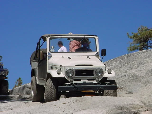

i love my saginaw steering it works great and i think i have got about 350 clams in the conversion it is a cheap venture if you search around for the parts. and it is always a good idea to think of the future this could be you on another year or two.
here s my rig right now pretty clean but future plans ,will make it more capable
