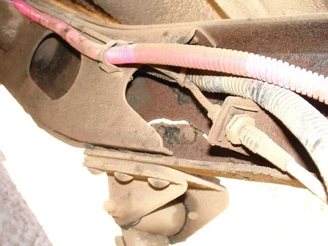

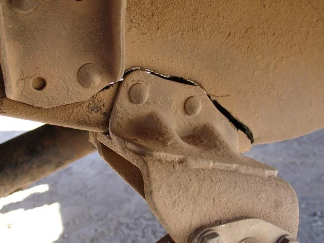

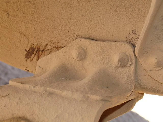

We found frame cracks on both rear spring hangers on the 40 today :( :( :confused: :(. Can anybody recommend a reputable shop to perform a repair of the frame, preferably in the Fountain Hills / East Valley area?

Holy chasm Batman! I can see light through those cracks!
Good luck fixing that, not sure that's repairable. Let us know what happens.

wow just saw the truck in person today, Yikes all i have ta say is your lucky ya spotted that when ya did. Seems strange to me though i mean the frame looks good, not rusty or anything so what would this happeen? hell my old 40 had 35s, small block ect... never any problems nor do many others? so what gives?

There was nothing obvious when I got the truck a year ago. But I have been wheeling it since, and something must have done it, although I have no specific recollection of any particular obtacle or situation. I just heard a 'clonk' the other day on the Chiva run, the sound was strange to me, similar but not quite like a small rock being thown up, happened only two or three times, not enough to reproduce it and recognize. Did not notice anything then when I inspected the truck after the run (as it was getting dark).
I still shudder at the idea of what could have happened on I-17 on the way home.
For nursing it back from our last trailhead Tuesday and to Kevin's shop, Michael rigged two ratchet straps to hold everything in place, actually the crack closed a bit under that tension on the highway.

That's the spirit! That isn't too bad of a repair.....just drill out the rivits, clean the metal, weld it up, and build new spring hangers that offer more surface area on the frame. Good luck with it.
I would graft on both sides with 3/16" 1/4" plates after welding I did it on mine in the rear very strong
