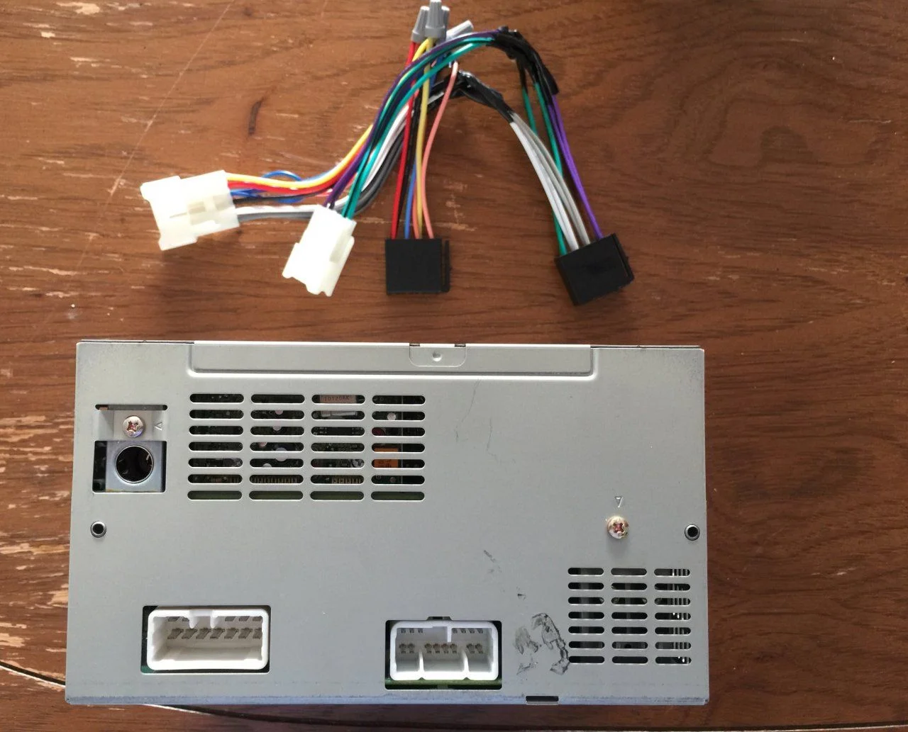

Howdy Gents,
I've found so much helpful information here on the new-to-me 1997 Lexus LX450. I've always wanted this fine fine machine and some ne'er-do-well in San Francisco stole my car a few weeks ago, and I finally jumped in and loving it.
I'm trying to swap out the stock double din Pioneer kex-p9066zt stereo with a fancy new one with everything and a back up camera. However, I have been everywhere online, talked with Crutchfield, and been to 2 stereo installation shops and no one knows where to get the proper wiring harness to attach to the new stereo wires.
This is what all of the sights say is compatible, but the plugs are far too small...
http://www.amazon.com/Metra-70-1761..._UL160_SR160,160_&refRID=0PG278ZQWBT9VBBH8CAJ
Or this which only handles the amp.
Metra 70-8112 Receiver Wiring Harness
Attached is the back of the stereo which looks like no others online.
Super frustrated and could really use some help.
Thanks Amigos!
You check the Scosche kits? They make a bunch of different patch cable harnesses.
This is the harness I used:Amazon.com: Scosche Radio Wiring Harness for 1987-Up Toyota Power/4 Speaker Connector: Car Electronics
It looks the same as what you have. The difference is I did what everyone else on here did- extend all the wires on both harnesses by 20" so you can plug into two of the plugs on the factory amp. Remove the factory amp and throw it in the trash. Remove the glove box and the right front speaker next to the glove box and it's right there.
Take the blue wire from the Pioneer (amp turn-on) and connect it to the violet wire on the plug right behind the factory head unit. That powers your power antenna. The green e-brake wire can run right under the console to the e-brake switch. You'll have to run an RCA with a power wire to the back for the cam. It was very easy to run mine along the passenger side and tap into the red/blue wire coming out of the reverse light for power.

Thanks Gents, great info. Ordering the new harness now and hoping that it fits my weird system. Looks like they are 6 pin and 10 pin connectors and my particular LX450 harness (which no one from Lexus, Scoche, or 2 stereo installation shops has ever seen) has a 12 pin and a 15 pin connectors. Fingers crossed this new harness will work.

This is exactly what I did when I installed my HU in the truck.
I should be picking up my Kenwood DDX393 sometime this week, and the place I purchased it from sourced the adapter kit. Will let you know what I got.
