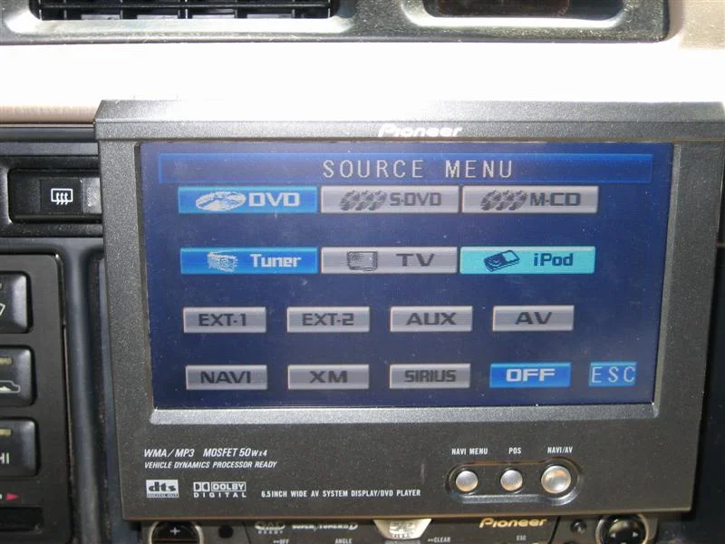

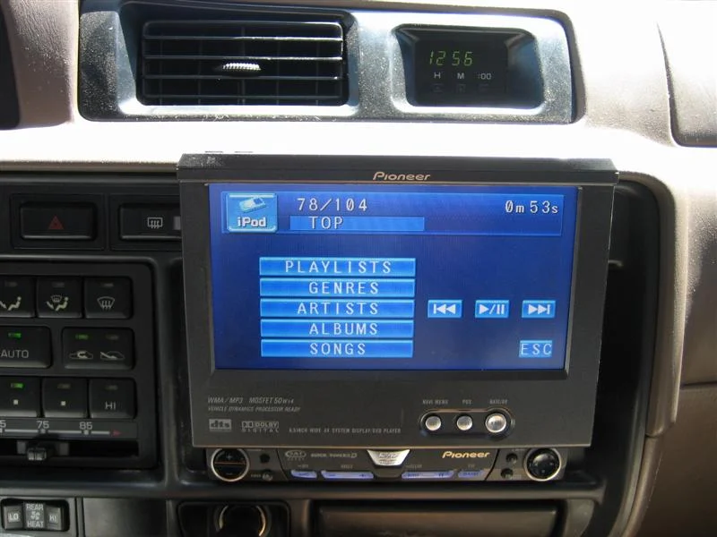

Pioneer in dash DVD with IPOD adapter

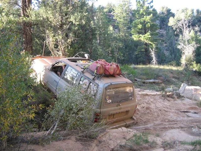

Like many others I'm building this as an 'expedition' truck. Which to me means a lot of wandering the Southwestern US but long term I intended to drive to South America. I tend to like to find the limits of my rigs early on. Between the Utah Cruiser Expedition and the latest Wasatch Cruisers run to Moab I've learned the limits of my truck fairly quickly. Just as I knew I would be I'm very impressed. Okay I used far too many words. Now time for the pics.
First trip in the truck, CM May 05
Moab October 05
Utah Cruiser Expedition Sept 05

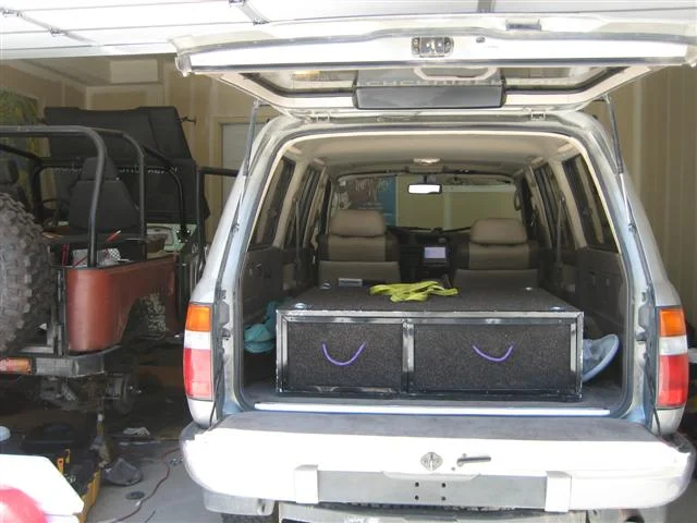

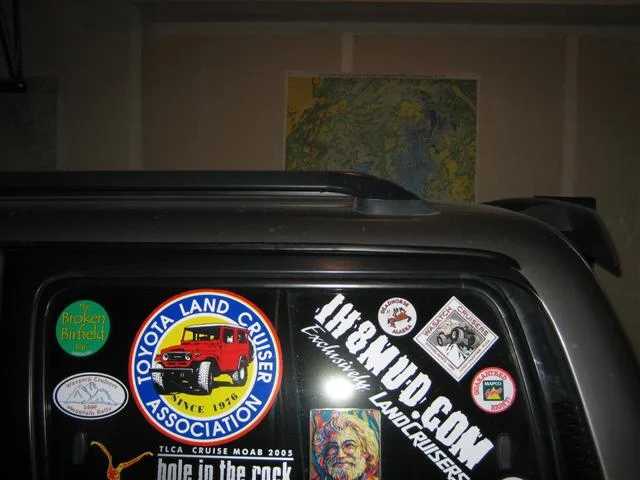

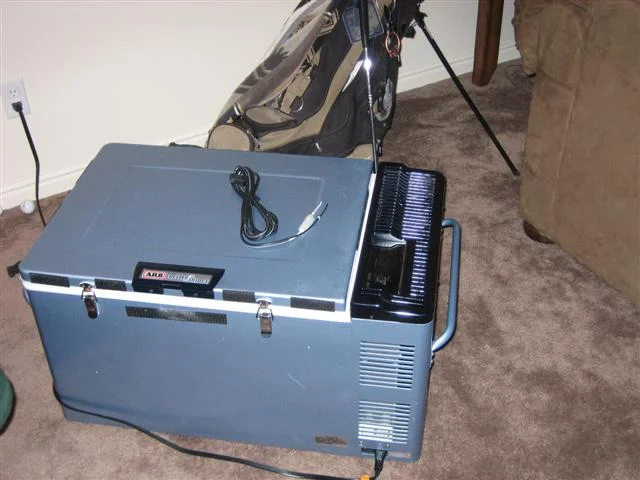

One pic of some stickers just for Cory and the reason I need to build new drawers, 63qt ARB! I have to show off the IH8MUD and giant TLCA sticker. I hope at least one of you Alaskan's will recognize the Mapco sticker.

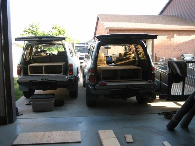

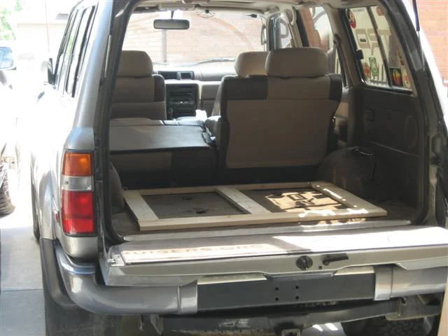

my easy simple drawers...
I'm into them about $160 in material and 3 or 4 evenings. I'm trying to figure out how i can save them and incorporate the Fridge but it's probably not going to happen. The joints are all biscuited and glued so the thing is like a rock, very solid. They aren't anything fancy. no slides, just wood on wood but so far i've been very happy with them.

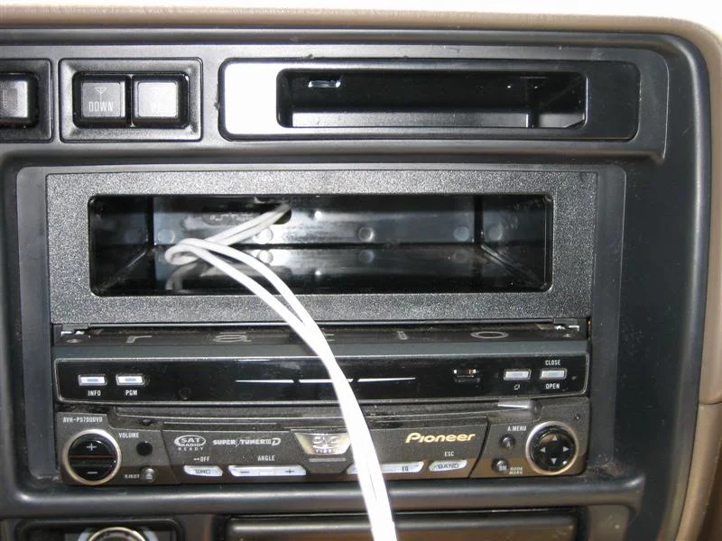

I was anti MP3 for a long long time. It was fine for my pc at work but otherwise I was all about the audio. Most cd traders will understand what that means. I used to haul 500 cd with me on trips just in case I got a specific urge for a certain concert or album. Once I accepted that MP3 was good enough for my bad speakers in a truck with 33in tires and wind noise I was hooked. The IPOD adapter was one of the best decisions i've ever made. I'm considering upgrading from the 30gig photo to the 60 gig movie so I can load up all my live music.

Nice rig dmc.
Would you mind posting a full dash pic so we can get a glimpse of what your 'woodless' dash looks like?
Thx

How do you like your Pioneer and would you do it again?
I have the older dash so the flip up would not be the best for me but I was looking at the other one.
cheers
Sam
Looks like your wood removal method works a bit better than Junks gouging it off with a screwdriver method. Did the plastic under the wood look good everywhere.
cheers
Sam
I've always had Pioneer Premiere head units in my trucks and have always loved them. The current DVD is not a Premiere unit but I've been very happy with it. The video quality is excellent as is the functionality. 90% of the funcitonality I use can be controlled with the screen slid in so when I get off road I don't usually run with it out. I have read some reviews the the ipod controls on non touch screen units can be somewhat burdensome. I went single din so I would have a convenient easy way to store the ipod.
