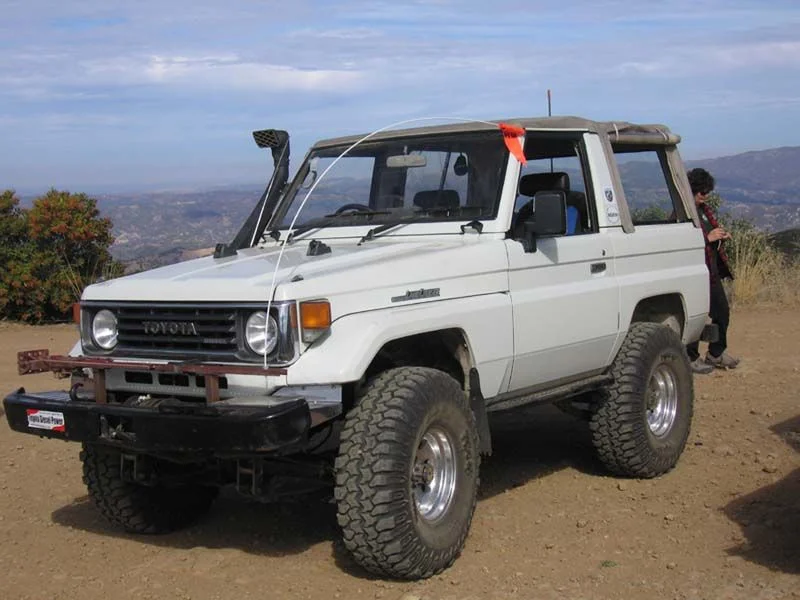

With skinny tires and rims you may even be able to get away with 34" tires. This 75 series is running 34x10.5x16 Swampers with stock factory suspension.
Dave
Dave
Wow Dave!
That is one nice looking 75.
Left Hand Drive too!!
Hey wait a minute.......................... it looks oddly familiar now?
I bet it has A/C too right?
The 75 sure does look good wearing swampers now, Dave

PacToy said:
Wow Dave!
Could it be your truck?????? Hmmmmm?????
Dave
