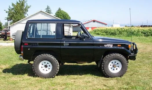

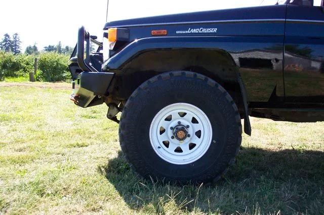

I dug up a pic of my 70 with Greg_B's 35x10.5R16 swampers. Here's how the front looks with OME mediums, ARB bumper and 8274. That front axle would look a lot better about an inch forward. I always meant to ask Dieselbigot if he had repositioned his on his 70.
