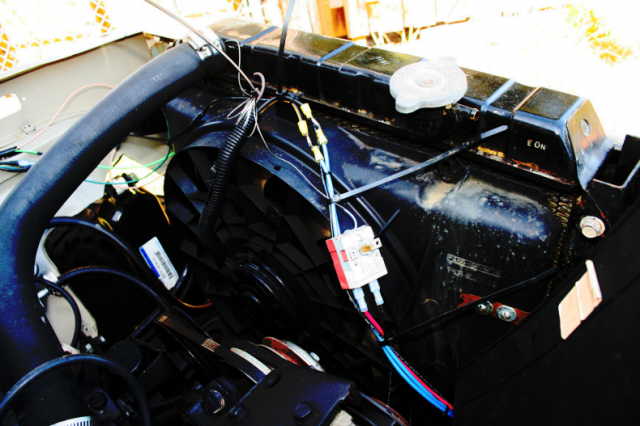

  • cooling: new stock radiator with a ford taurus electric fan hooked up only on high comes on around 190 i believe and works great now that i got the wiring all figured out, i have 130 amp water proof relay that i bought from a local marine supply warehouse that has worked flawlessly so far. the thermostat for the radiator is from advanced auto and it is a controllable thermostat.

  • entirely new harness (EZwiring harness)
  • next inline is APC conversion lights to put the newer style bulbs in my truck for better vision
  • gauges are all mechanical except the voltmeter and tach. all of which are SunPro
  • rear of the vehicle i have LED 3157 type lights that are stop turn and tail, they are susceptible to being hit but at 4 bucks per light I'm not worried.
notes on electrical:
  • Ez wiring harness was awesome worth just as much as painless but half the cost.
  • everything went well with the wiring first try, I just followed a cross of the EZwiring harness and the factory wiring.

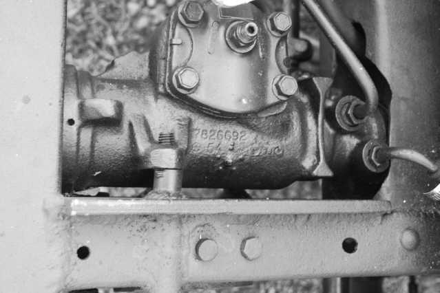

front sway bar. ( custom made from DOM) already have ideas brewing
steering upgrades
high steer arms from all pro offroad, new $tuds, new cone washers from them as well
5/16 wall DOM tubing for the Tie Rod using weld in steering bungs from spidertrax.com
All around 1 ton GM tre's
nylon locking nuts on the high steer arms
full rebuild on front axle - all seals and fluids replaced
notes on steering
I had used the nylon locking nuts on the high steer arms to prevent them from backing off as much as they normally do and lead to breaking on the trail i thought this was a good idea and have never seen it done but i'm sure it has been done before. I opted for all new studs and cone washers just for the hell of it. The steering is real beefy although i did have to ream out the arms on the high steer to fit the 1 ton GM tre's it does work well and there is tons of metal still there so breakage i don't think will be an issue. the metal and the weld in bungs were from spidertrax and i got all the TRE's at work, so all and all in was a clean project.
