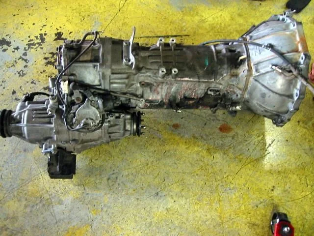

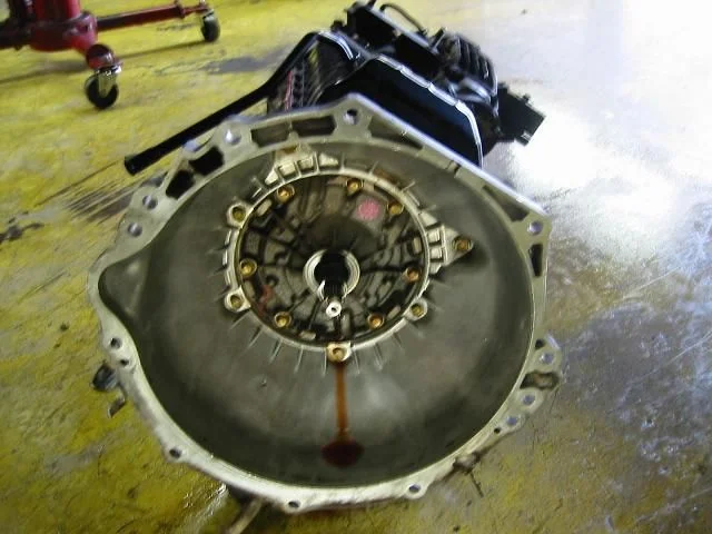

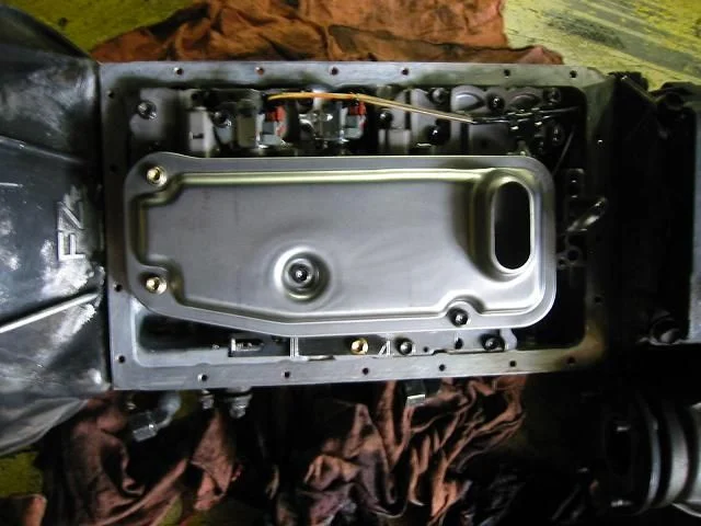

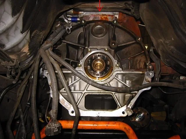

I was just doing simple thing replaces the front crankshaft seal, oil pump seal, rear main seal and look what I've found in the 2nd pics.And don't get this wrong, the truck been well taken care and had extremely maintenance in the past 9 yrs since I purchased it new.
The truck has been checked regularly.The 1FZ-FE engine running smooth and quiet like brand new truck .Obvious no leaks, no rattles, all the fluids, coolant and reservoir also good, you name it I've done it all.No indicate the HG leak.And If I sell my truck to you in dealer showroom condition, same as in the 1st pic tell me who's not interested to buy my truck, but hey they didn't know it was leaking from the back.
One last thing, If you willing to drop the tranny just be careful the 1FZ tranny is so heavy at least you need 2 or 3 big guys to hold and drop it.I my self big guy 265 lbs couldn't do with 2 guys.
