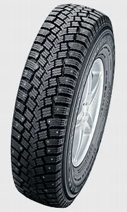

Nokian tires
I have been running Nokian Vatiivas on my 1994 LC and they have great snow and ice traction and are pretty good on dry. 265/75 16 was the only size they had in stock, but fit the factory height nicely.

How about putting studs on the tires to increase the ice traction?
I don't believe these are Mud Terrains based on the tread pattern and what I found in a 5 minute google of these tires
