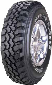

Has anyone tried these?
http://greendiamondtire.com/ (New, sizes up to 31")
http://www.high-tec-retreading.com/diamond.html (Retreads, sizes up to 36")
It looks to me like a replica of those two. The top picture is a Dunlop Radial Mud Rover (the one on the left) and the bottom one is a Buckshot Maxxis Mudder.
