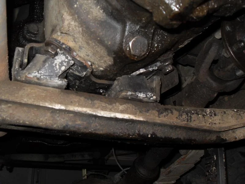

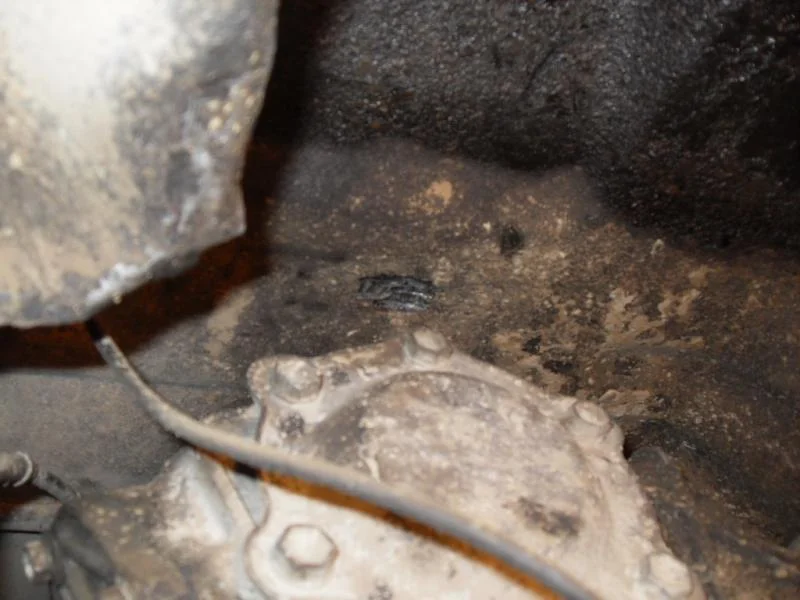

Crawling around the 60 the other night and found a couple more things out of place you might say...

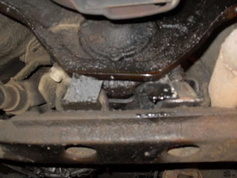

In the pic of my broken rear shock bar i noticed that my rear driveshaft didn't look just right... after futher inspection i figured out what was going on....
I never did get a new trans mount, i just welded some plate on it to make it a solid mount and it broke... i guess my welds were not that great and that great big thud i heard when i was in the lower rock garden probably helped too .... Trans cross member got banged up pretty good too, but no sign of anything else so far.... Looking back, i'm happy the trans mount broke and not the bellhousing or something worse...

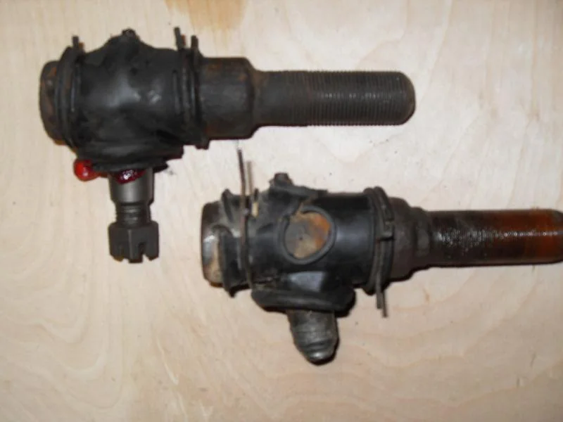

I did get the drag link end swapped out though...
