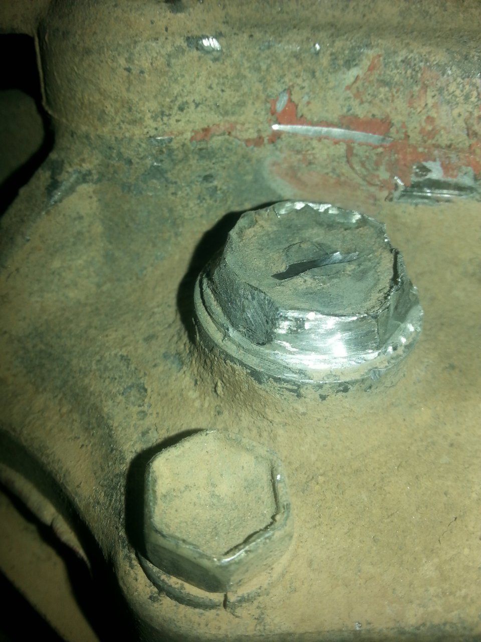

Take your 24 socket grind it down to remove the rounded area on the edge so you can get the socket on to properly grip.
Save it in your toolbox.
Already tried this, too, but I think the bolt is just too soft. I'm just going to weld a nut onto it I thinkHammer a 23mm socket on to that.
