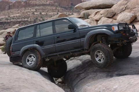

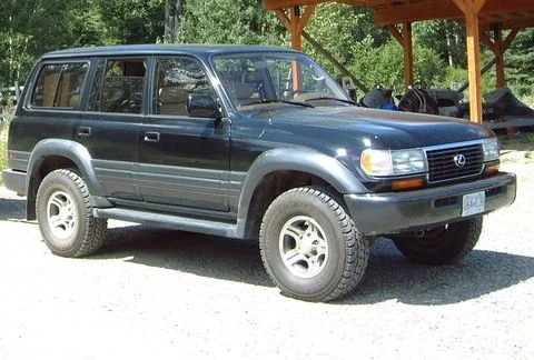

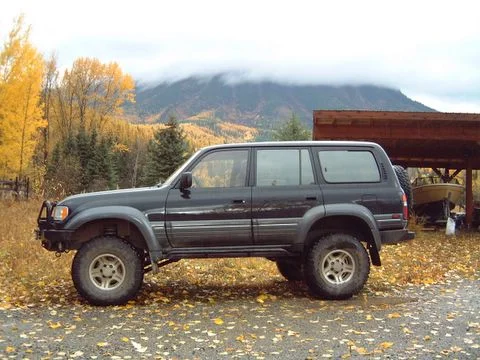

    Here they are.

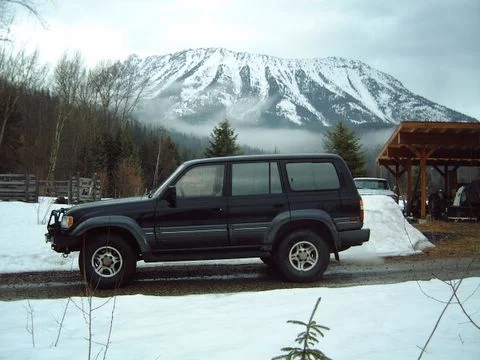

    and the last one with 6" lift.

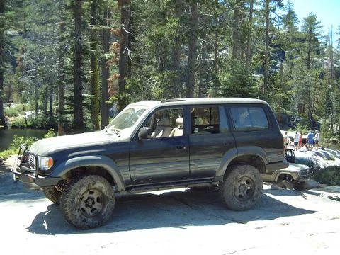

    Here is an early pic from elephant hill. 2 1/2" belton lift, and another from golden crack post 6"

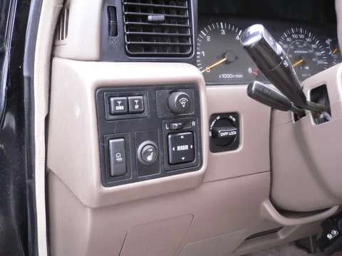

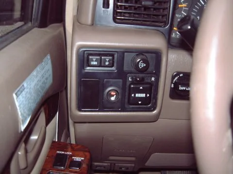

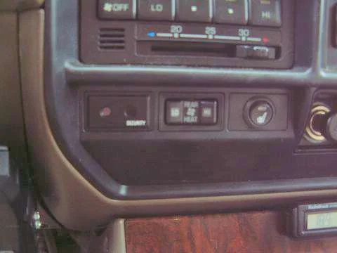

    Here is where I installed my heated seat switches.

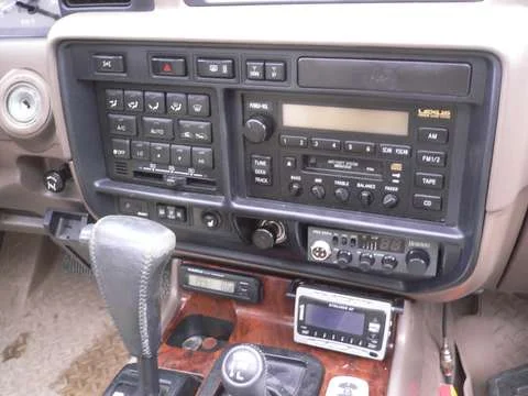

    Here is a pic of the CB install and the switch for the winch and lightforce lights.

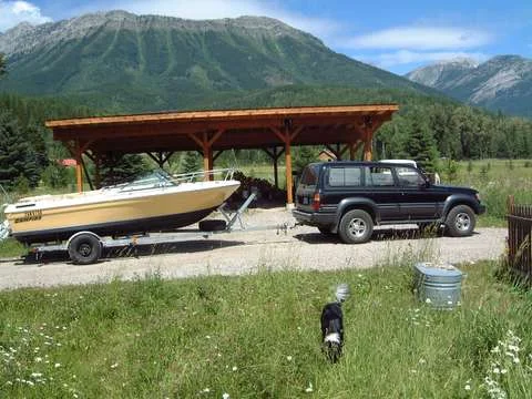

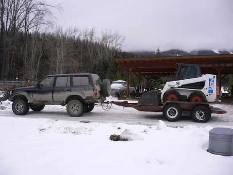

    I also use my cruiser to tow alot. Used it to get rid of my durango. I tow my boat across BC every summer, and I just picked up a bobcat that I had to tow over 3 high mtn passes to get it home.
    I will testify to the towing stability of the slee 6" lift. It is far better than stock and alot better than both the 2 1/2" belton and the Jsprings. Surprizing for such a tall lift.
    The Durango + trailer was about 5500 lbs,
    Boat + trailer is 3500 lbs,
    Bobcat + trailer is 6500 lbs.
    Notice the pintle hitch for the bobcat trailer.
    Cheers,
    Sean
