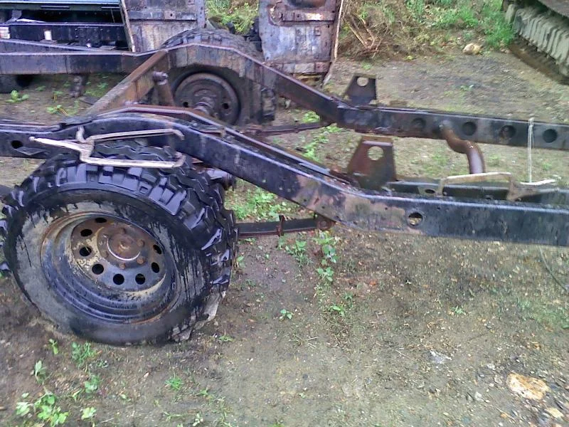

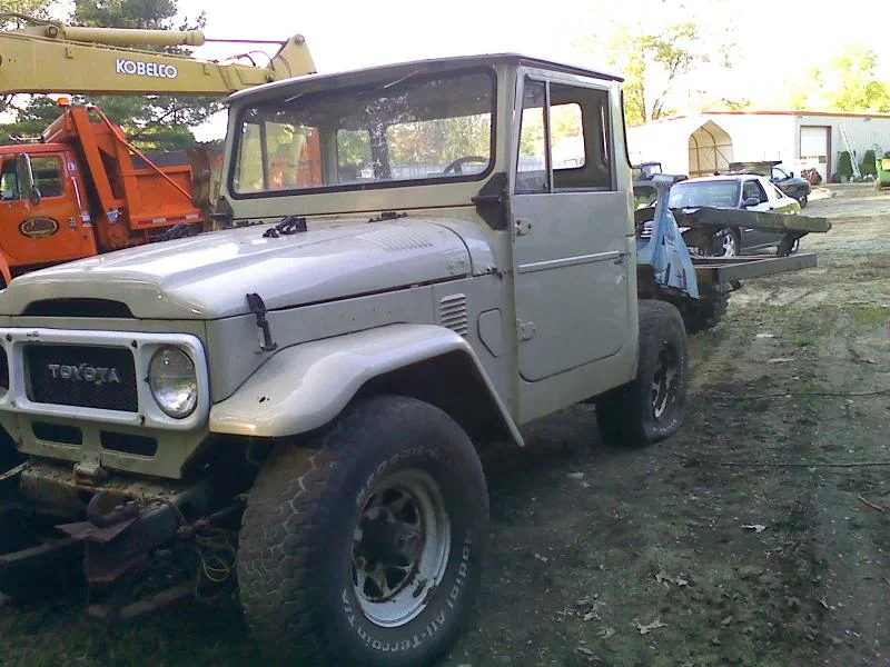

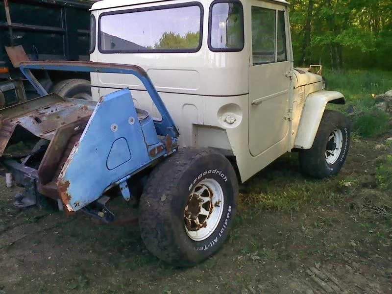

I took the ride today and picked up the 45, It is a frankencruiser right now on a79 40 frame begging to be put back on it's 45 frame.Hopefully in the next year I will be able to do it. There is a bunch of work ahead and I hope that you guys can steer me in the right direction. Here are some pics.
The original blue cowl 45 cowl with the right windshield frame is on it for the hold downs is on the back.

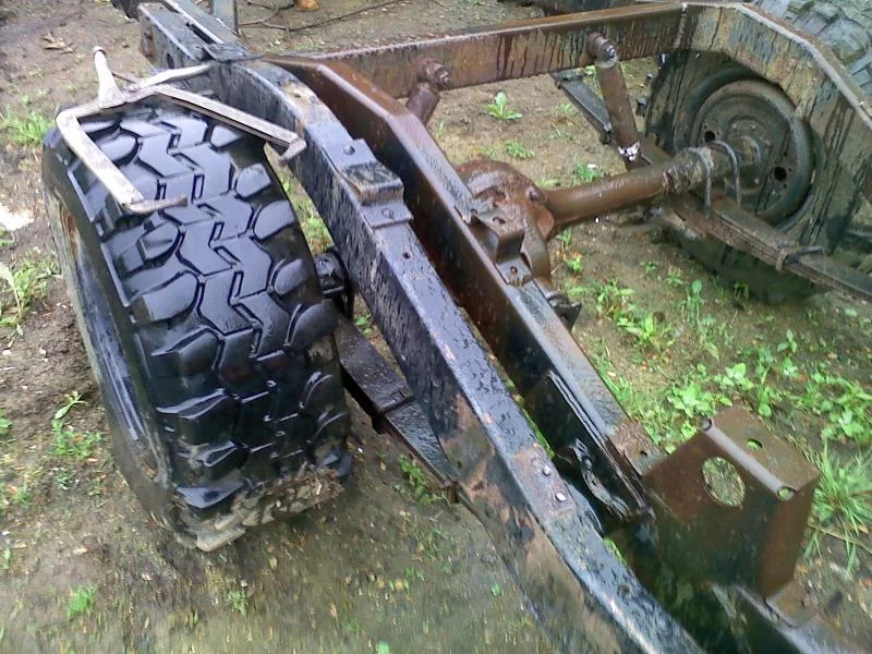

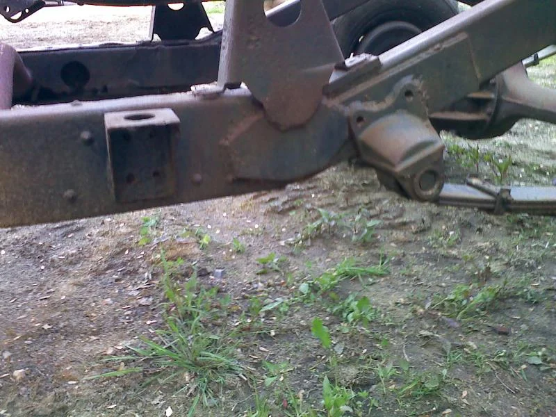

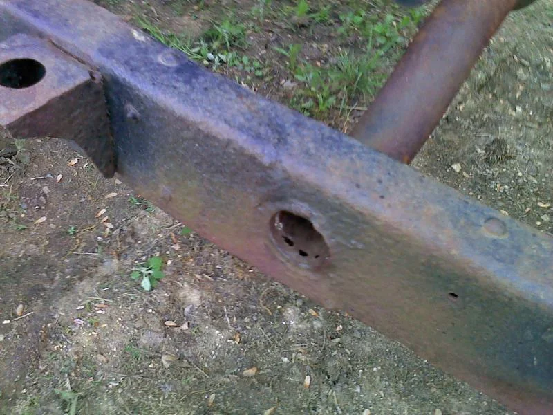

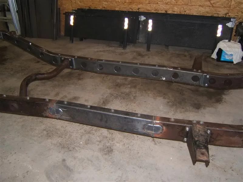

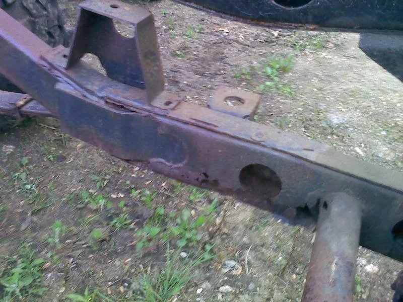

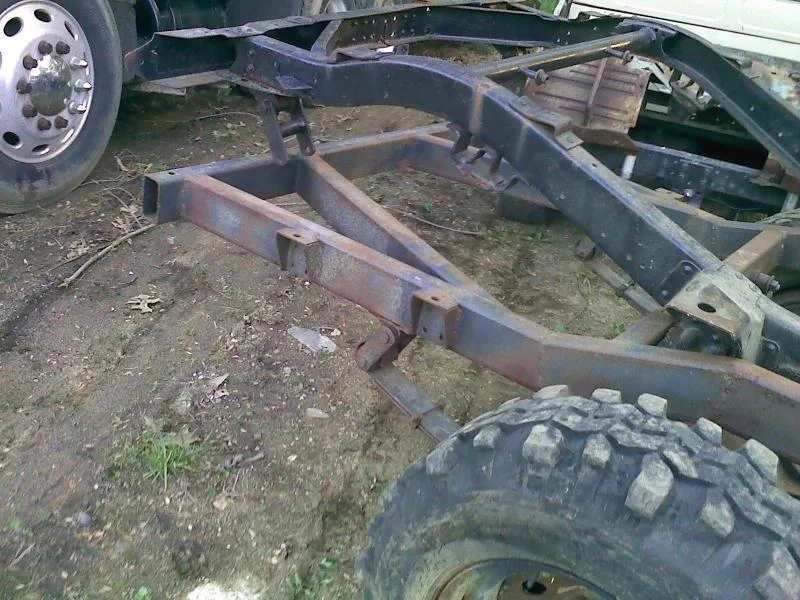

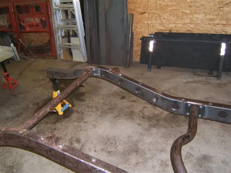

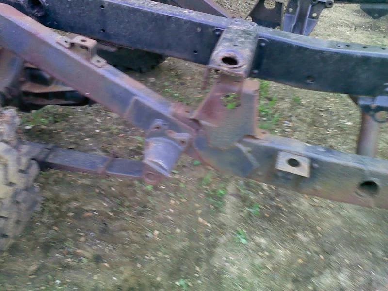

So I was looking at the 45 frame after I got it home and I see that it is 2 pieces. I am thinking that a 40 frame can be grafted on and the end lenghtened to work. The last pic is the frame where it was repaired at one time.

Anyway I am looking at the frame spec sheet and it looks like the top line of the center of the frame goes right thru the rear spring hanger eye. So it seems if I line up the new frame section with the top of the frame line I should be able to line everything up.

Correct me if I'm wrong, like I've ever seen a real fj45 frame, the frame you have from the fj45 looks to be a fj40 frame that was extended. Also will you give me the link for the frame repair picures you found? Oh, I didn't know the cowl was differant between the 40 & the 45. The cab pictures you have do look abit differant because of this? I've thought about making a 45 frame from a 40 frame but havn't persued it. Your ressurection has got me excited. I'm looking forward to seeing your progress.

Dan the frame that the body is on now is a forty frame. The frame that was repaired (if you can call it that) is a 45 frame the vin is on the frame. Yes you can stretch a forty to make a 45 you have to add to the center and to the end.

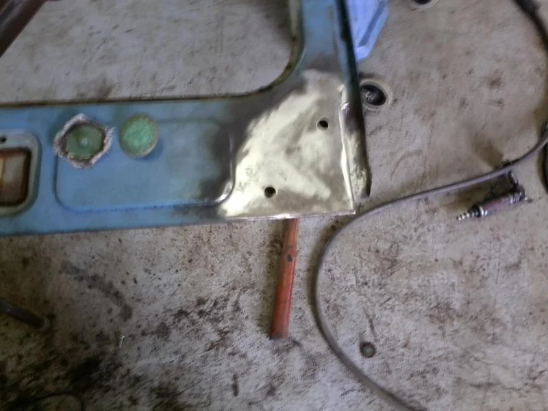

Got a little time in today on the 45 parts, I started to take apart the cowl pulled the windshield frame off and as expected there was some rust/rot under the hinges and the captured bar for the hinge screws came loose. So cut out the rot and made a new strap to hold the bar back in place,made a piece and welded it back together.I had drilled a hole threw the the new piece to plug weld the strap up.
Also I pulled the top off the 45 and the doors,and 74 windshield frame.
