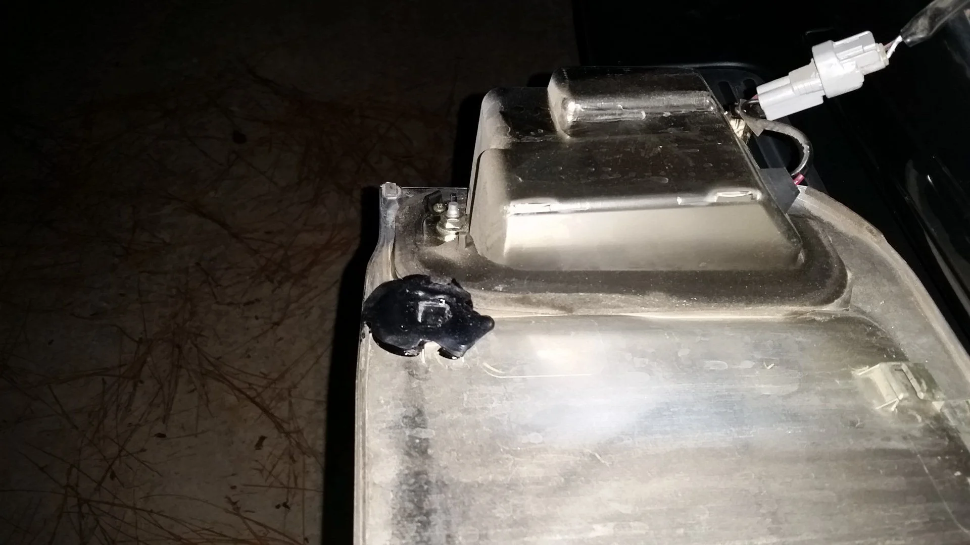

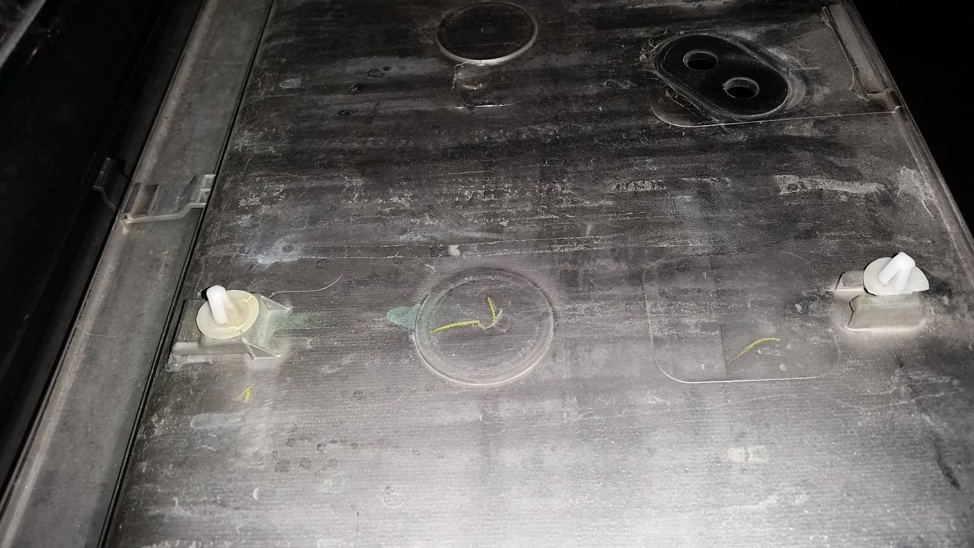

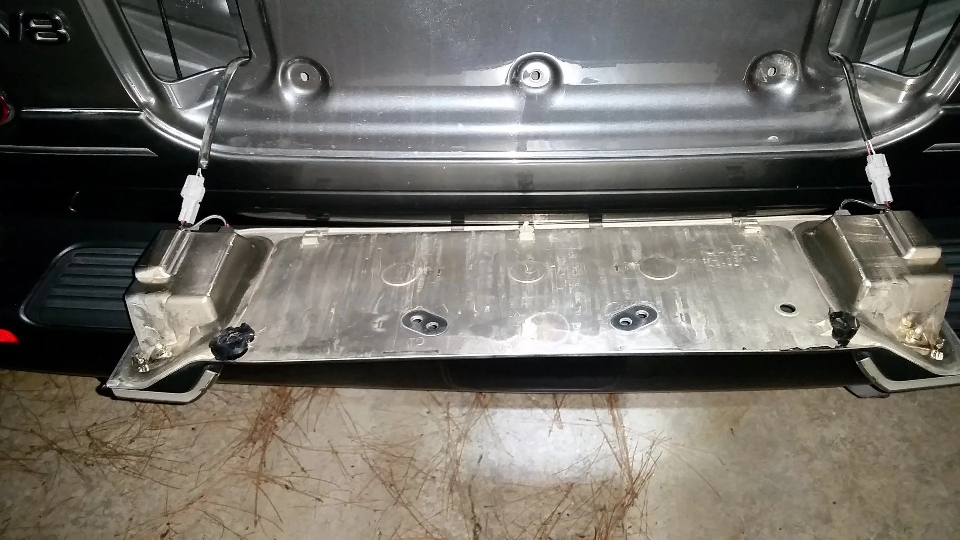

1)repair rear tailgate plastic plate behind license place. When the dealer repaired the dent the must have just tried to rip this piece off and broke several tabs and therefore it is currently only being held on by the license plate bolts. I plan to repair the broken tabs with plastic epoxy and fix this piece when the plastic clips come in from Onur
