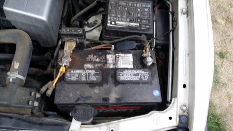

The first step was to remove the nasty wet cell battery I had in there. It was only 3 years old, but the wheeling and the fridge done it in. It still started the truck, but it wouldn’t charge over 12 v and the fridge would kill it within 4 hours.

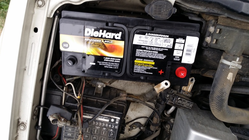

Once the old battery was out of the way and all the terminals were cleaned up, I test fitted the new battery. There is maybe 1/2” space between the a/c lines and the radiator! It is a tight fit, but it fits!
The only “modification” I had to do was make some spacers for the hold down bracket. The design of this particular battery has a stepped top. I just used a chunk of 2x4 I had lying around to make the bracket. My original plan was to do this just to get me on the road, but it is holding the battery so well I will probably leave it… Besides, the Lexus needs a little redneck.
And here she is all buttoned up. My truck will be used as the camp truck for 4 days up in the woods with the fridge running, so I will report back on how the battery performed.

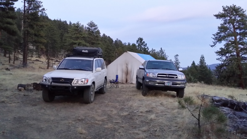

I took the LX deer hunting with my Dad last week out in Eastern Oregon.

What kind of tent is that? Its like a mini home...
It's CVT's Mt Cayley. Personally I think it is too small... I had the Mt Hood before that, and it was a bit big for me. With the CVT's I have been around, I am leaning towards a Mt. Bachelor for my personal tent when I finally buy one. CVT has awesome tents!
The Best Roof Top Tents -RTT's for Truck's-Car's-SUV's and Off-Road Trailers-Cascadia Vehicle Tents | Cascadia Vehicle Roof Top Tents
Wait a minute, where you talking about the wall tent in the background? That tent is so old I have no idea who the manufacture is. It is 16x14 and has a wood stove. There is quite a few companies that make them, but here is a link to the ones Cabela's sells: Cabela’s Outfitter Wall Tents by Montana Canvas : Cabela's
I would recommend going to a Sportsman's Show if you want to check one out. There are usually 4 or 5 wall tent manufactures at the big ones.

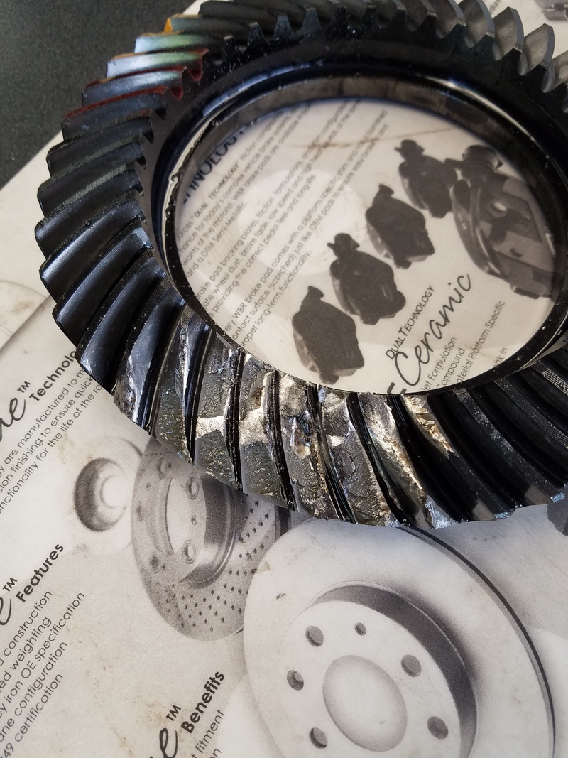

Two days into the work, I get the first dreaded phone call. It seems the rear carrier bearings that were included in the master install kit were incorrect. The carrier has a radius where the bearing goes and the bearings included didn’t.
This shows the carrier:
Here are the bearings. The one on the left is factory and the one on the right is what was provided.
