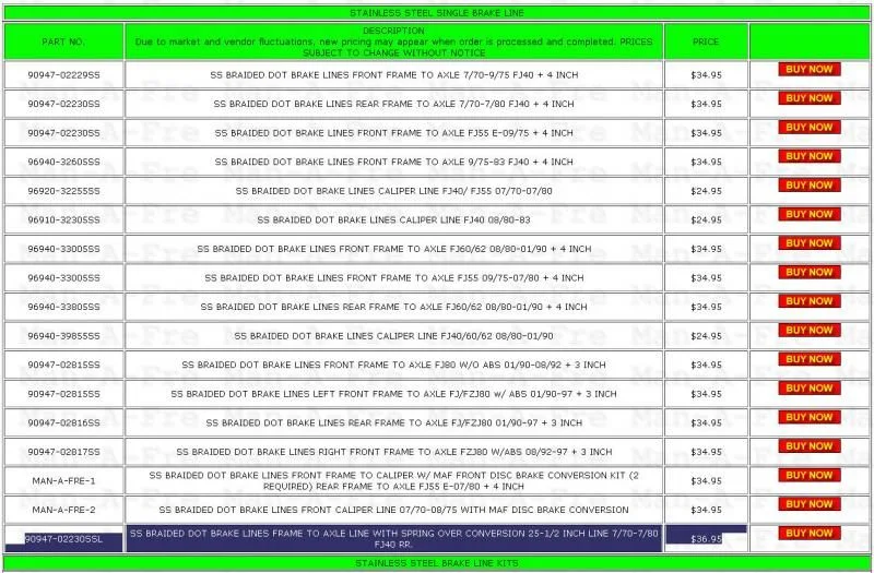

I ended up buying the TG steering..saved me $100. My next issue is my knuckles were just rebuilt not too long ago. So I dont need the bearings and shims, all I need are the gaskets and seals. What are people doing about the brake lines for the SOA? The longest braided lines I can find are for a 4in lift.
Either get custom lines made or buy the 25 1/2" long SS brake line MAF is selling. It's listed for a 40, but the fittings are the same. The frame bracket is a little different for a 60, but the clips fit so it's solid.
FYI, I have the 4" model in the front of my 60 and it's working pretty well, for now. It fit when the suspension was in full droop ( no weight on the axle ).
I dont see a 25 1/2" line listed. Or is it just the 4in lift line for the 40s?
Yup missed that..so I need 2 of them?
I bought the 25.5" long one first, and then the FJ60 4" lift second. It works for me. If I did it again, I'd just get two of the longer ones.
