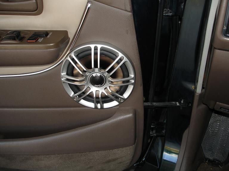

I selected the Polk db651 because the mounting depth was fairly low. I debated between these and the db651s, which are shallow mount, but found out that shallow mount refers to how much of the speaker sticks out above the mounting plate. Since I was more concerned with depth inside the door, I went with the regular db651. I don't mind the speakers being visible (it is a 15 year old vehicle), so trying to find a very shallow speaker was never a concern because the selection is very limited and the sound quality suffers a lot.
First, I removed the door panels and the speakers. I checked the mounting depth and knew I needed to space the speakers out from the door some. I used the supplied mounting bracket and cut off all the extra tabs. Next, I taped the speaker bracket where I wanted it and drilled 4 holes using the bracket as a template. I attached it to the door using 4 #8 x 1" stainless screws.
Then, I put the door panel back on and made sure everything lined up. Using the supplied mounting bracket allowed me to create a spacer between the door and the panel to give me a little extra clearance. It also gave me a solid surfact to mount the speakers as I didn't want to just screw them into the door panel. I used the 4 speaker mounting holes as a template and drilled 4 small holes around the speaker opening in the door panel. This gave me a template to mount the speaker and made sure I was securing it to the bracket in the correct places. I used a Dremel to smooth out the edge of the speaker grill that rests against the chrome accent strip on the inside of the door and provide enough clearance so the speaker sits flush. The amount of material removed from the speaker grill was minimal. The mounting bracket is mounted to the door and the speaker is mounted to the mounting bracket (the way it should be) through the door. It feels very secure and offroading shouldn't be a problem.

A few more pics of the finished product. There are no clearance issues with the dash and the difference in sound is amazing. The 6.5" speakers put out a lot more sound than the 5.25" versions of the same speaker, so I plan on installing my other set in the rear doors soon.

I have those same speakers in the front, and the 5 1/4 in the rear (do not get the 5 1/4" for the rear, just use the 6.5", they will fit better and sound better). WELLLLL worth $50, I would not go for a lesser speaker. I mounted them the same way. After a few weeks I decided to make them look a little better, and primed and spray painted the speaker grilles with a matching brown paint, it looks good, though I should have put a clear coat on to really finish them off. No one but a mudder would know they are not stock now.

The rear install requires making the speaker hole a little bigger in the sheetmetal. You can use a jigsaw, with a metal blade, it is very simple. The 5 1/4" speaker is actually bigger in the wrong places, than the 6.5" which should fit easier.
The 5 1/4" did not come with the spacer like the 6.5" did. I bought a $15 spacer (now I remember, that is why I bought the brown spray paint, because the spacer is black and doesn't look right). And attached it through the door panel and into the sheet metal with sheetmetal screws. Then I attached the speaker to the spacer, I used a small nylon spacer/washer to make sure the grill and speaker were snug when screwed to the spacer.
You may not need the external spacer with the 6.5", but if you do, the same spacer fits 5.25" or 6.5", so you could mount it exactly the same if you want/need to.

Here is a pic of the front door, with painted grill:
Ben...the painted grills look factory, well done.
