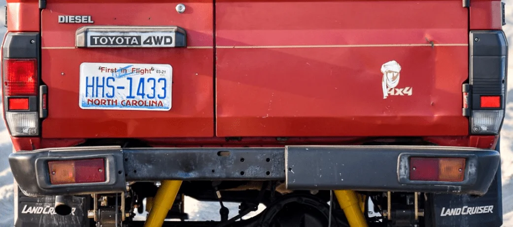

It's good. Rock it.
Thanks!It's good. Rock it.

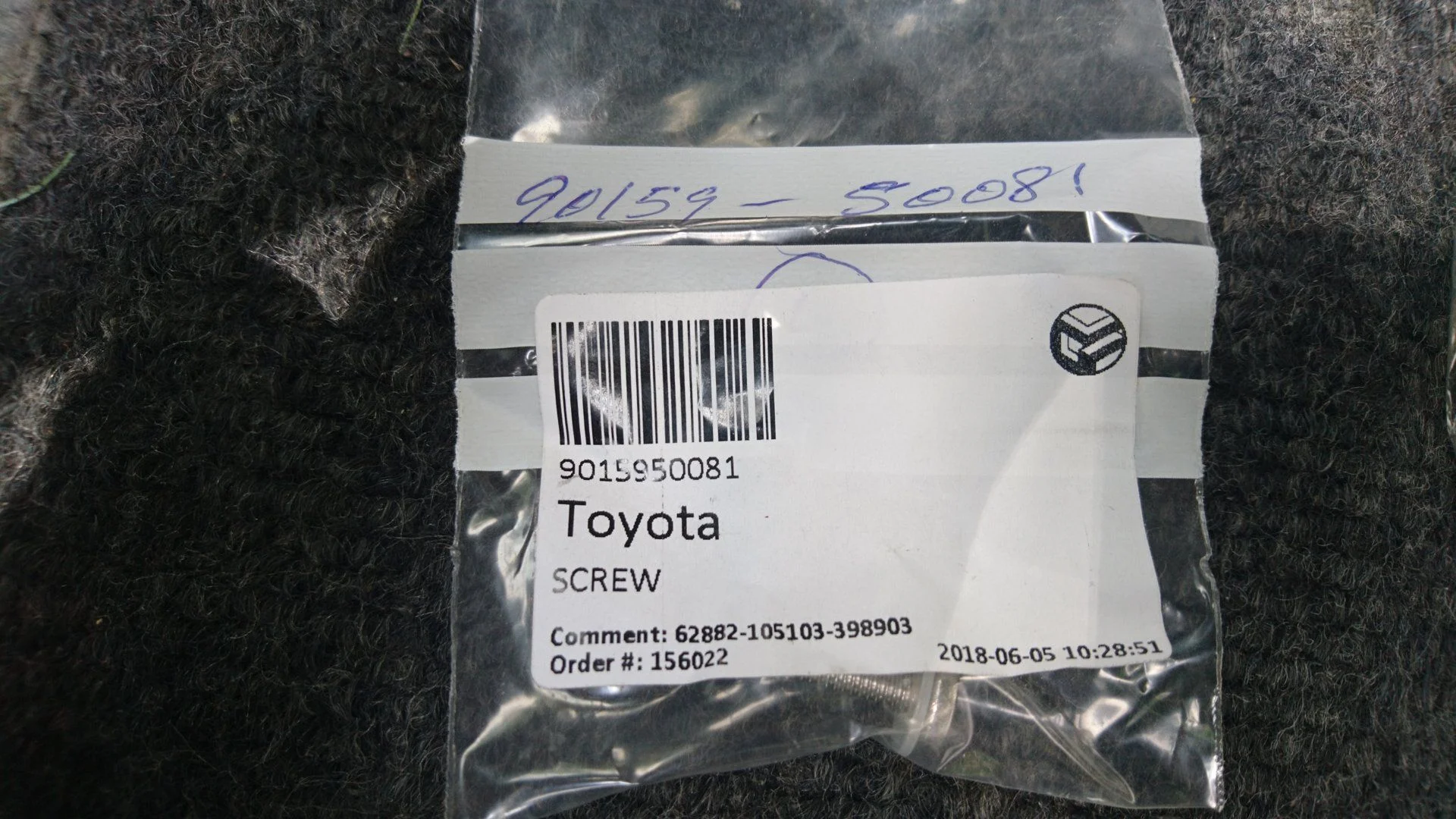

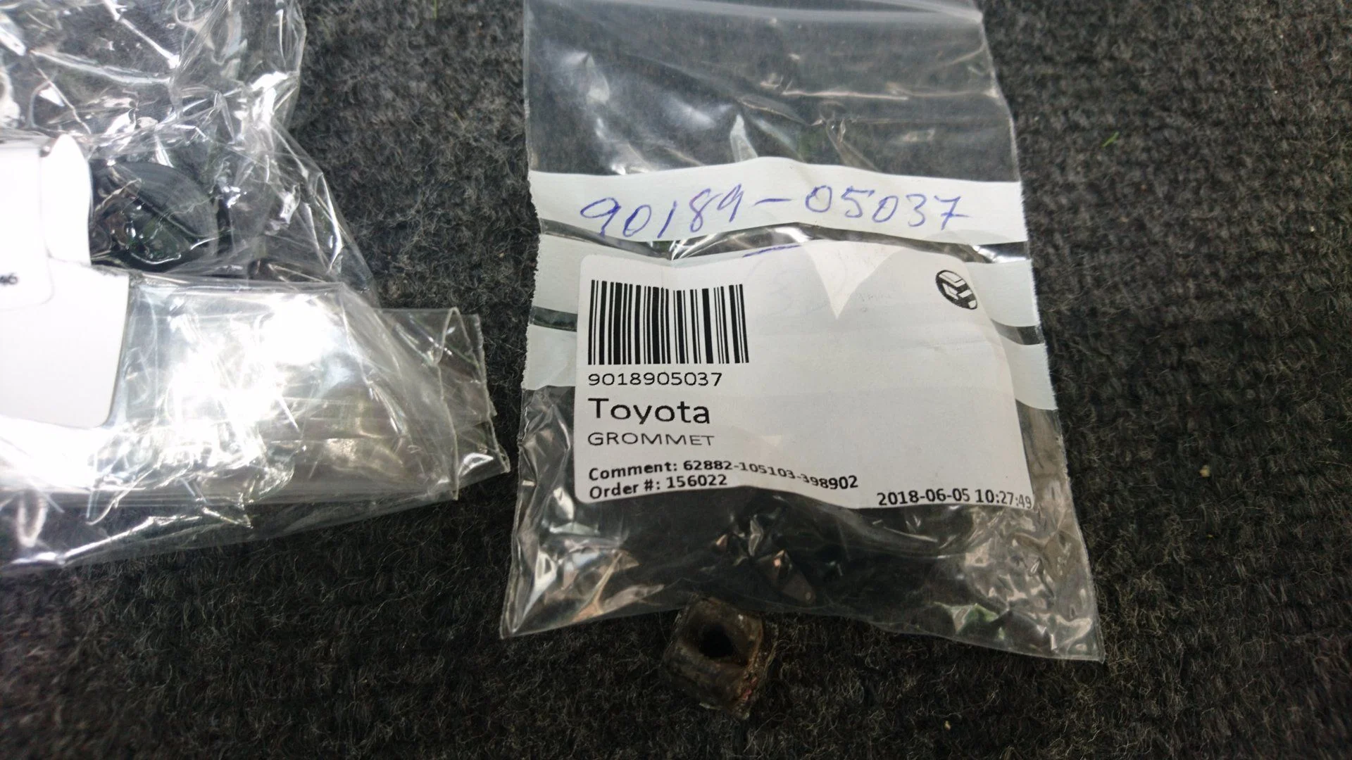

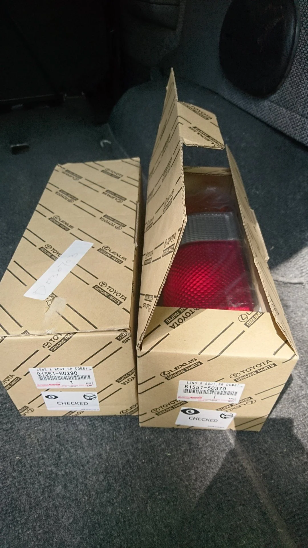

For these combination tail lights: LH: 81561-60290 and RH: 81551-60370, any idea if these would fit a 1987 BJ75 Troopy? Were they 12V or 24V?Replaced the POs aftermarket tail lights with some OEM and had to replace one of the clips that the screw screws into as well as one of the screws. Also, bought a few clips that hold on the felt under the hood.
LH: 81561-60290
RH: 81551-60370
grommet that clips into the body that the tail lamp bolt bolts into:
90189-05037 (you need three per side)
the bolt that bolts the tail lights into the body:
90159-50081 (you need three per side)

Unfortunately i'm not sure on part compatibility.. but mine is a 24VFor these combination tail lights: LH: 81561-60290 and RH: 81551-60370, any idea if these would fit a 1987 BJ75 Troopy? Were they 12V or 24V?
OK - just trying to find something to replace the right side body fixture with something to match the left side.Those are lens-and-body part numbers. No bulbs or sockets.
see link. It looks like what I have in my LJ78. Amazon product ASIN B0183HTFDYOK - just trying to find something to replace the right side body fixture with something to match the left side.
Using the VIN brings up what's visible. I don't know market specifics enough to search the proper parts for the combination lights, sockets, harnesses, etc.
