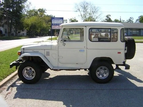

Thought I would share the process of my build for those who are interested. I am starting out with a pretty solid 79 FJ40 that has 28,000 original on it according to the title. This rig has very little apparent rust showing at this point. I am having all of the glass and panels taken apart and sprayed separately prior to assembly. Stainless hardwear will be used in the assembly. The underside will get a fresh coat of POR 15. The interior will be lined with a tinted to 031 liner.
You can see that the front of the rain gutter is bent upwards. The right fender has been coated with some kind of funk and the hood has a pretty good ding in it. But no complaints out of me.

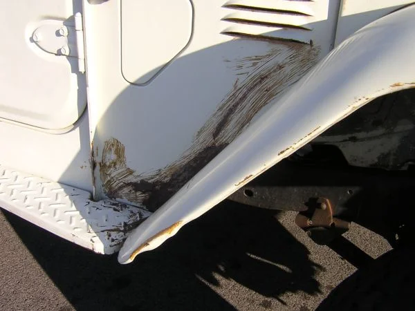

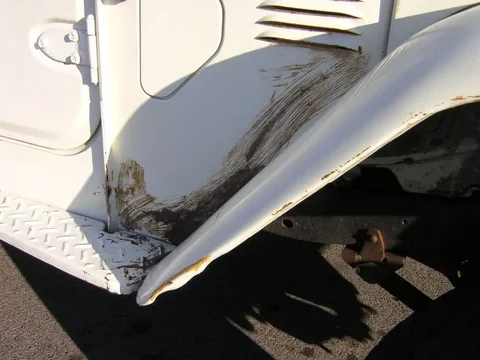

Here are some detailed pictures of the trouble spots.

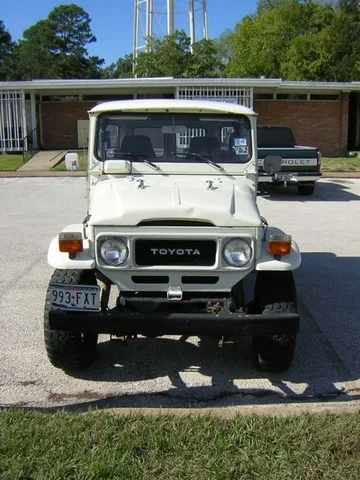

Here ar esome of the progress photos of the disassembly. You can see that the interior floor pans are in pretty good shape considering the rigs age. Some attention will have to be given to the tailgate / rear door area though.

Nice 40 Indeed, Take A Lot Of Pics Of The Whole Resto.. Is The Square Bezel From A Later Model Though? Or Is That The First Year Of It? My 78 Has Still Has The Round Bezel.
I believe they went square in early to mid 79. I have a 3/79 with round but it is also a conglomeration of parts...like the early split hood.
