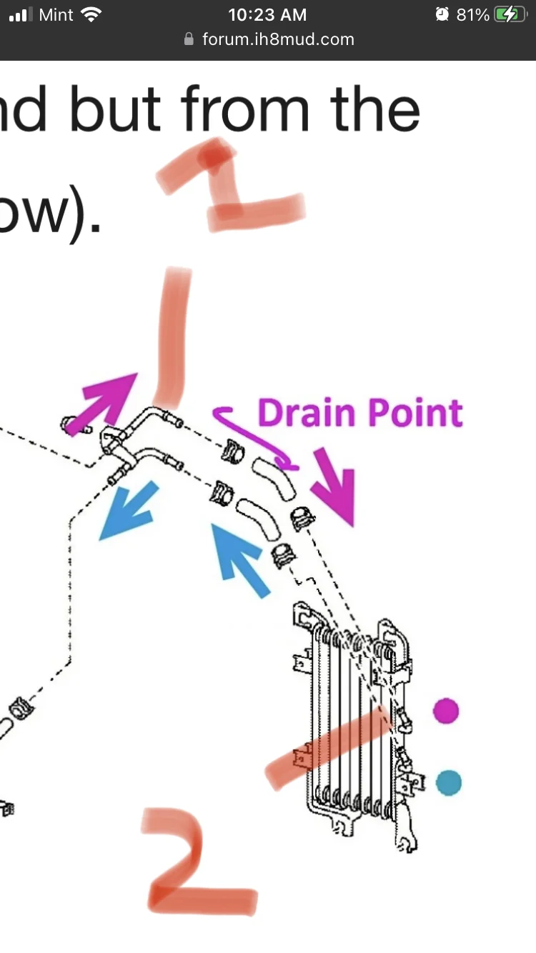

From the service manual that seems to be the only valid way to do a proper fill level with our electronic thermostat valve.
The procedure is a bit complex for operating temp fluid level and that is very interesting that you report the RPM fluctuates.
Ive got TS and will be adjusting my plan according to this and start off with excess fluid.
