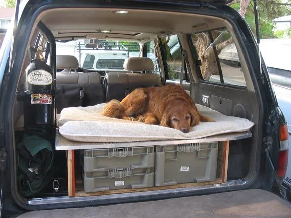

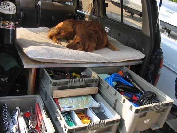

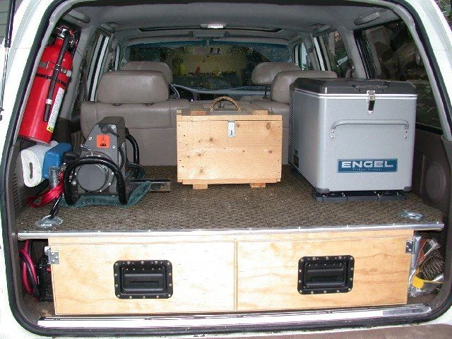

From a Post from rockclmbr
Here is my set-up which has saved me hours of loading/unpacking during trips! I'll give credit to Jim Brantley for the base design. I made a few minor additions that I thought was needed:
1) Fold-up flaps to make the entire platform flat ( this is a must if you have a dog in the back)
2) Cotter Pin setup (not shown) to index the drawer and keep it open when on a slanted hill. This also keeps the drawer from rolling out too far or closing.
3) Hand holds to open and close drawer without pinching fingers
Things I wish I added:
- top hatch for getting to gear that is inacessible when the back is stuck up against a tree or rock!

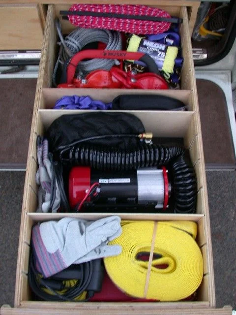

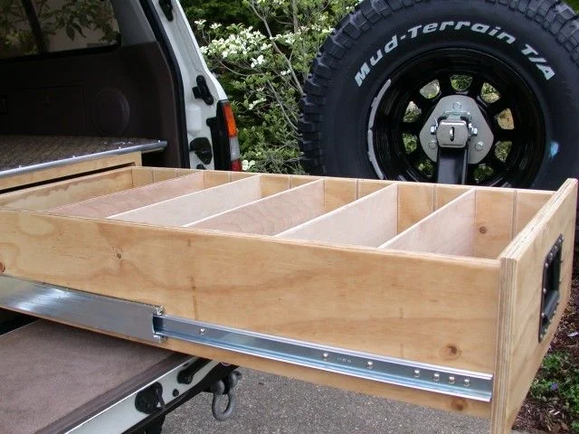

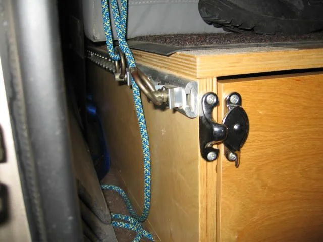

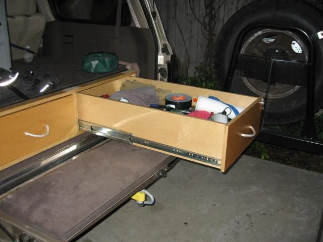

Accuride 36" slides 300 lb capacity each side
window cam latches
rubber truck bed mat cut to fit each drawer
J-Tracks on each side of the box to tie down the fridge and stuff

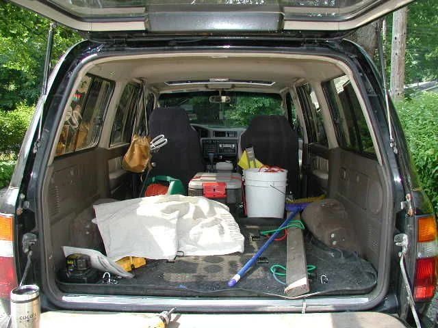

These storage solutions are too nice!!!
How about the whole rear of the truck?

Beno,
You need a before and after shot.

I think that IS the after......

It is the before the finale shot....
Working on Herculining the entire rear section, putting in some metal storage boxes over the wheel wells, and dropping a wall between the first row and the back with a door like contraption....
Too much to do, too little time.
It's always a mess back there. Even when it's clean.

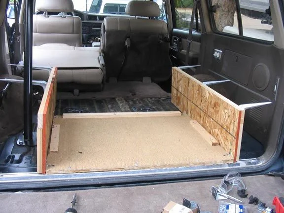

Ok, sorry Romer for being a slacker here. I've got a platform in back, similar to what many have created. Differences for me are that I've got completely square plastic tubs, so the platform itself becomes the lid when they're in place. Whole thing is secured through the floor, with the 3rd row latches removed. Also secured using the tie-downs and turnbuckles, and even through the rear threshold.

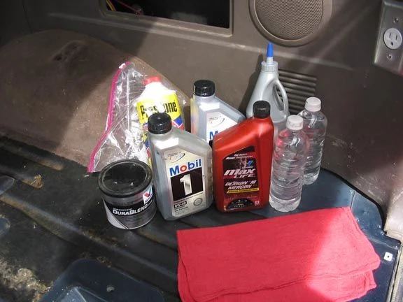

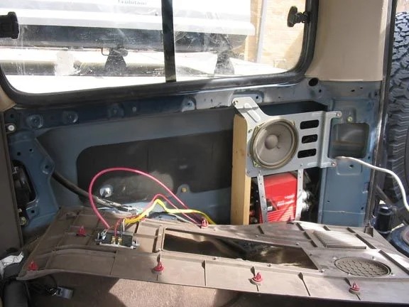

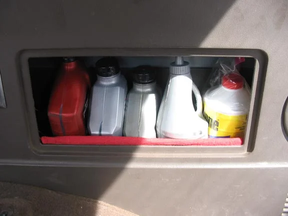

And one thing I've done different is I've removed the little "cargo area" from the PS panel, installed a barrier to keep my inverter isolated, then used the rest of the space to store fluids. And yes, those are shelf brackets that hold the outside of the platform up.. think light weight!

Also the tubs themselves work at support for the platform, keeping the hounds in check above. Here are a couple pics of the panel removed, so you can see how I've mounted the inverter, plus all the fluids I've stashed in the PS wall.
couple other comments: I took my cargo carpet out, that stuff was nasty from life, but more importantly the install of the wood is much more secure without it. Plus it gave me a little more room, and allowed me to easily incorporate the existing holes for the 3rd row latch bar deals in the center. The 1x4 is my "barrier" that keeps the fluids away from the inverter, both of which tie into the OEM speaker mount. Without that speaker, and without the inverter, you could store enough fluids in there to do a complete front and rear axle service, change out the T-case, and probably have enough room for a 4 qt. drop & swap of the ATF. If you haven't already, I would encourage you to take that PS panel off and look at all the room back there...
