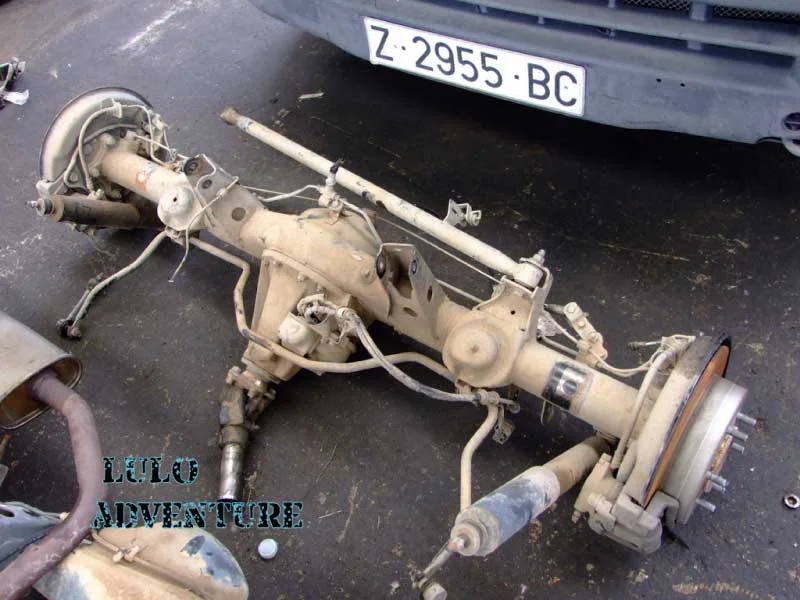

Factory Diff E-Locker ---> (LULO LJ-70) Part 1

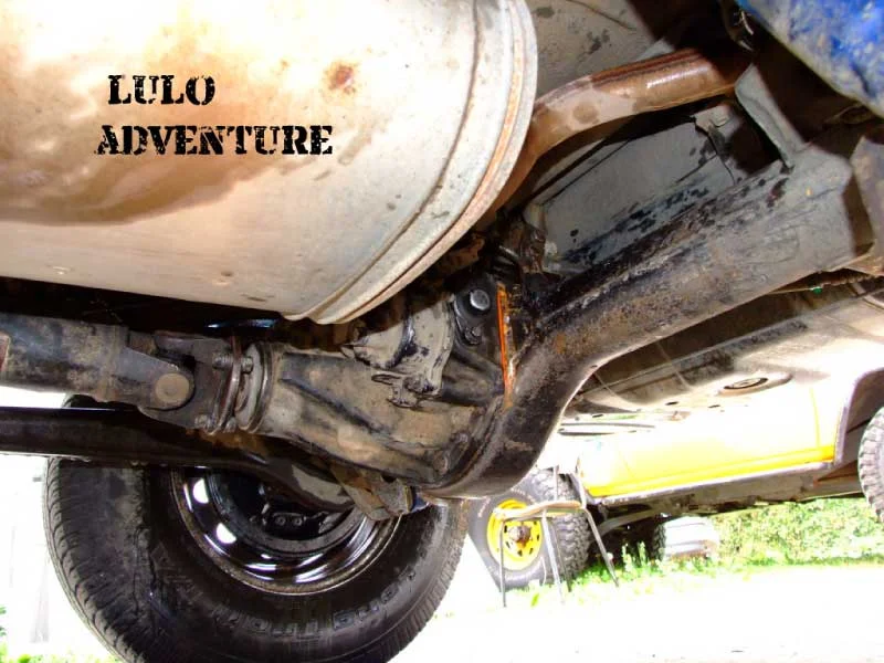

I buy 90 series VX (Luxury Edtion) rear axle with Factory Diff E-Locker

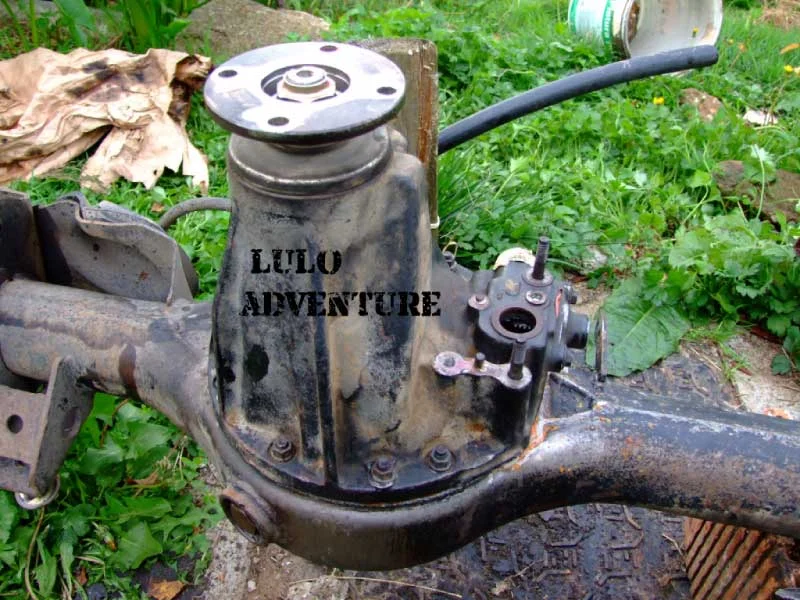

Factory Diff E-Locker ---> (LULO LJ-70) Part 2

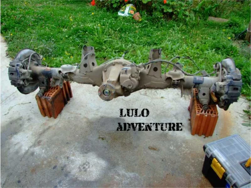

In future attempts to bring the disc brake system on my rear axle
My dirty rear axle... (waiting the new toy )

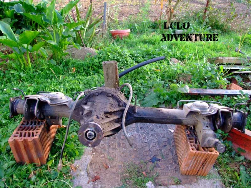

The left Third Member (Factory Diff E-Locker) with new Gear And Pinion "YUKON 4.88" , the right
Third Member (Factory Diff 4.88) ----> K.O.

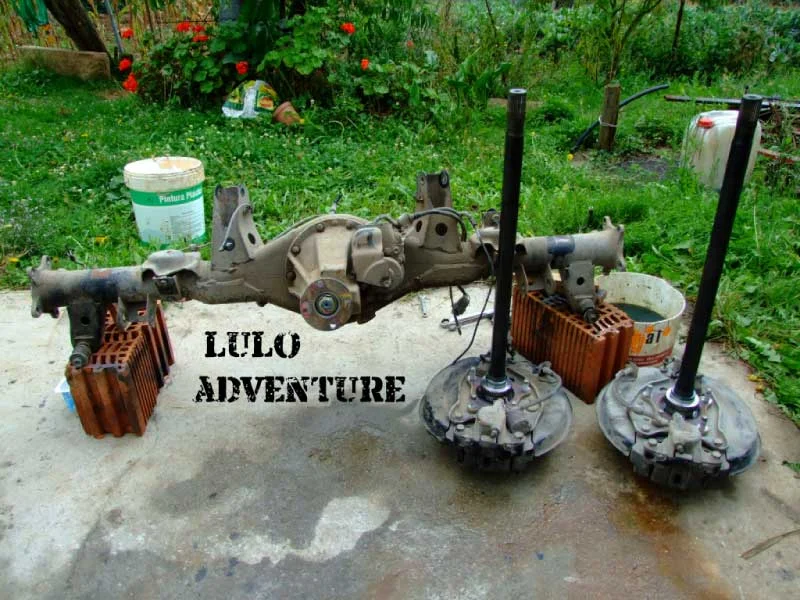

Factory Diff E-Locker ---> (LULO LJ-70) Part 3

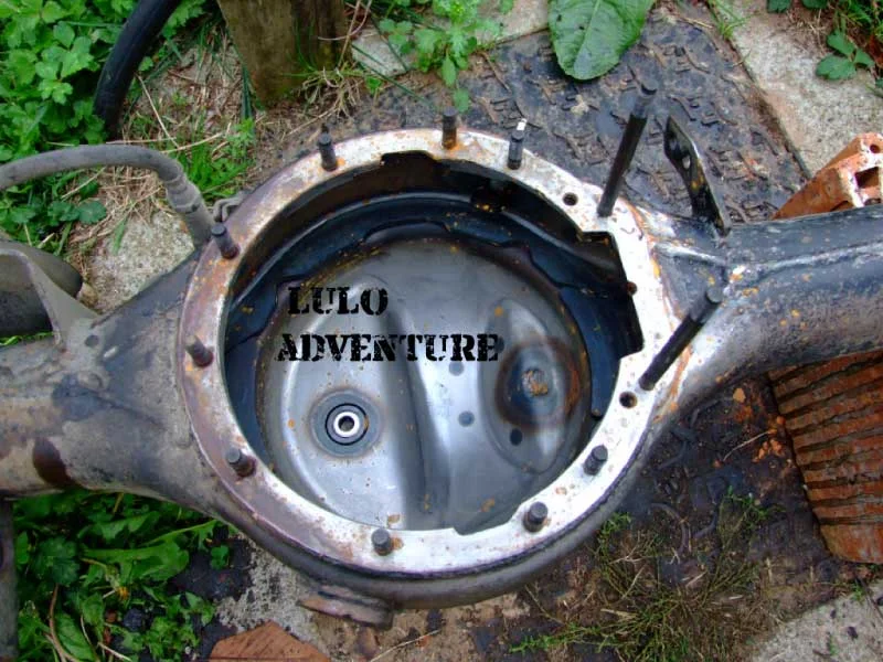

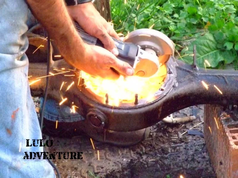

Start the cuts in my old axle...

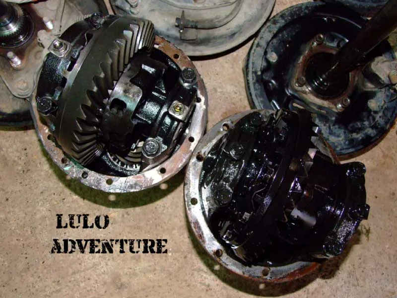

After cutting and welding ... everything went well...
All is ready...

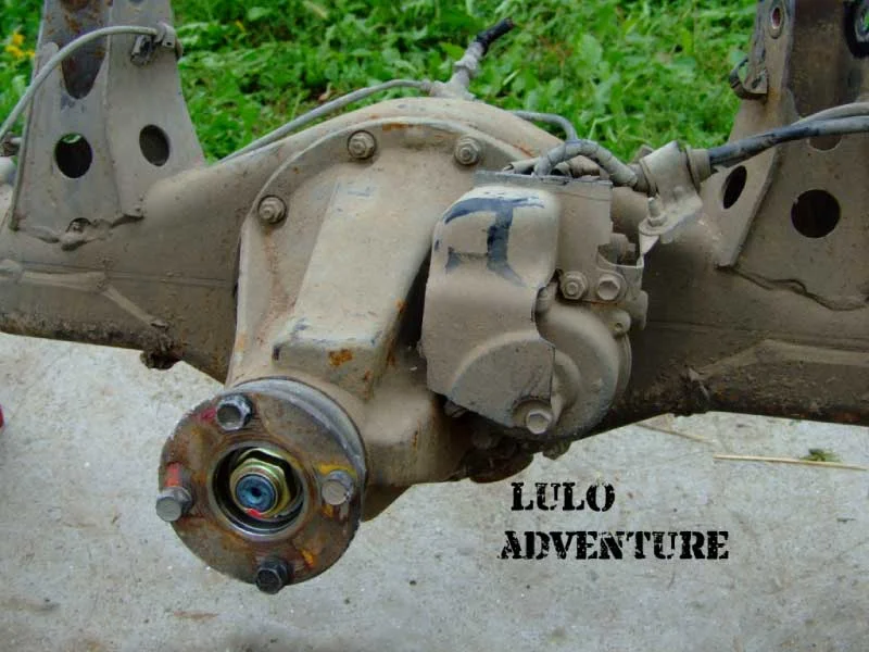

Factory Diff E-Locker ---> (LULO LJ-70) Part 4
The last Pic...
