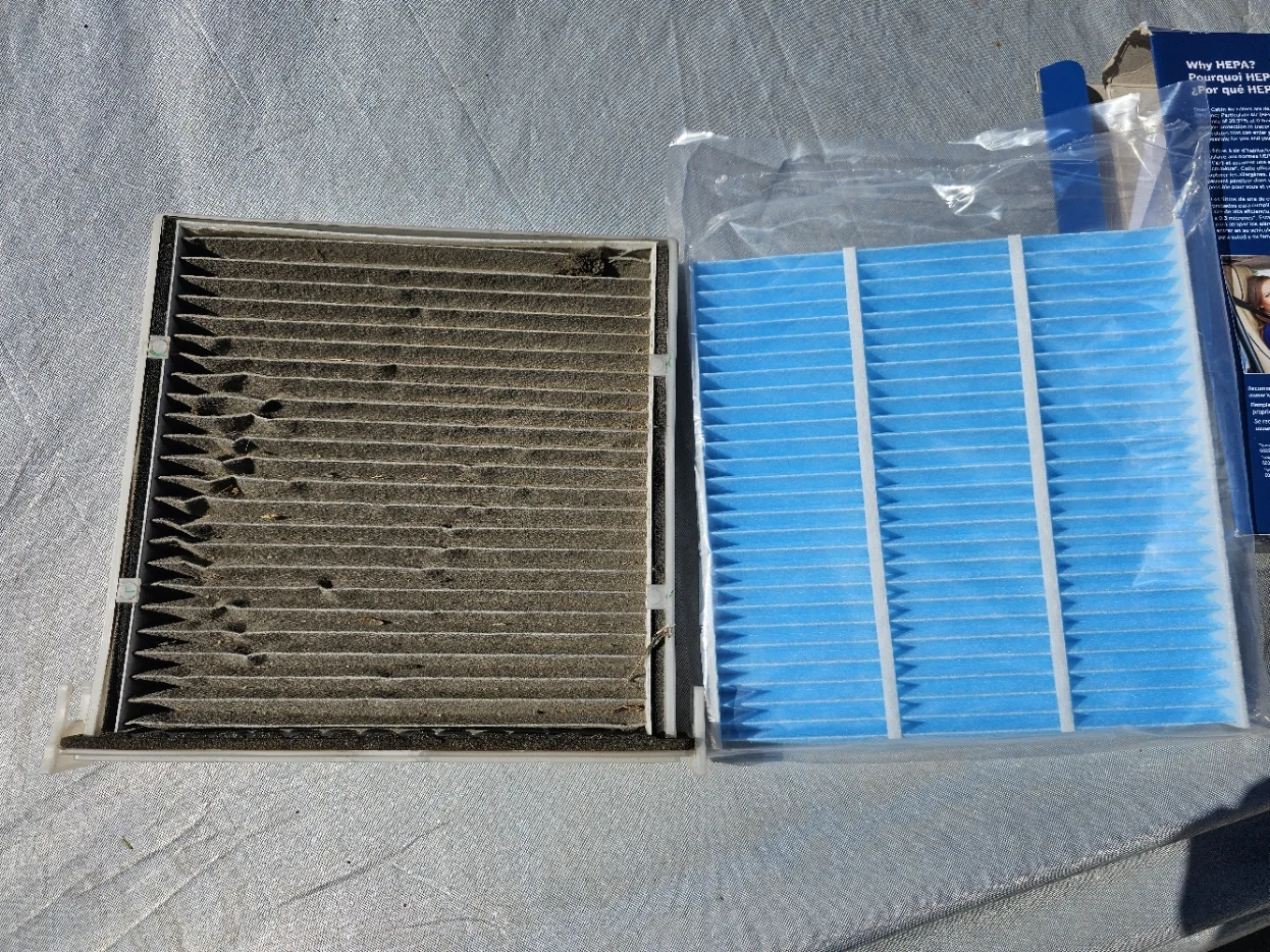

Since it's been a year since I bought the GX (yay!), I also replaced the engine and cabin air filters. The engine air filter wasn't too bad but noticeably dirty compared to the new one. The cabin filter though...
(the other side was still white so props to Denso for making good cabin air filters; new filter is Bosch)

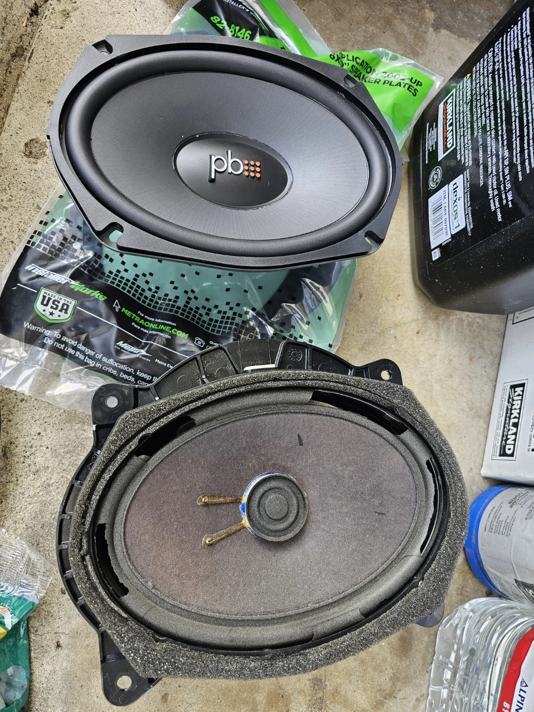

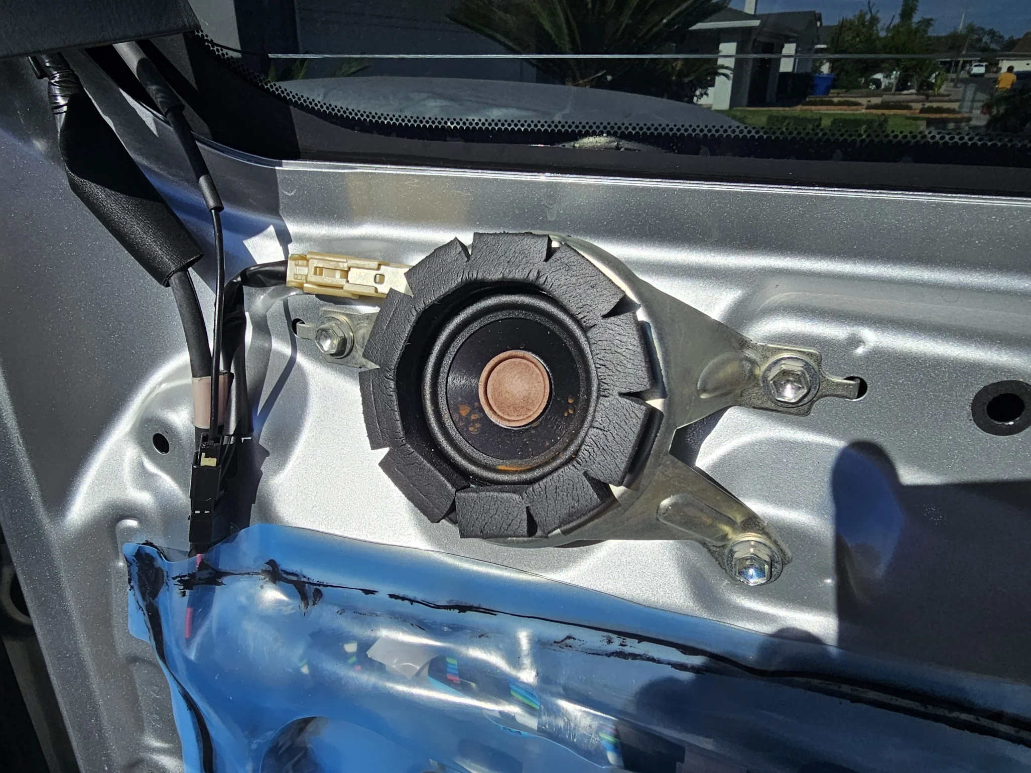

Feeling productive this weekend. I diagnosed the M3's thermostat code yesterday (that was a fun one lol) and since the GX's new speakers were delivered this week, I tackled the front speaker installation.
It was much easier than I had anticipated. Everything just assembled together without much drama.
I also put new foam surrounds on the rear tweeters in the back door.

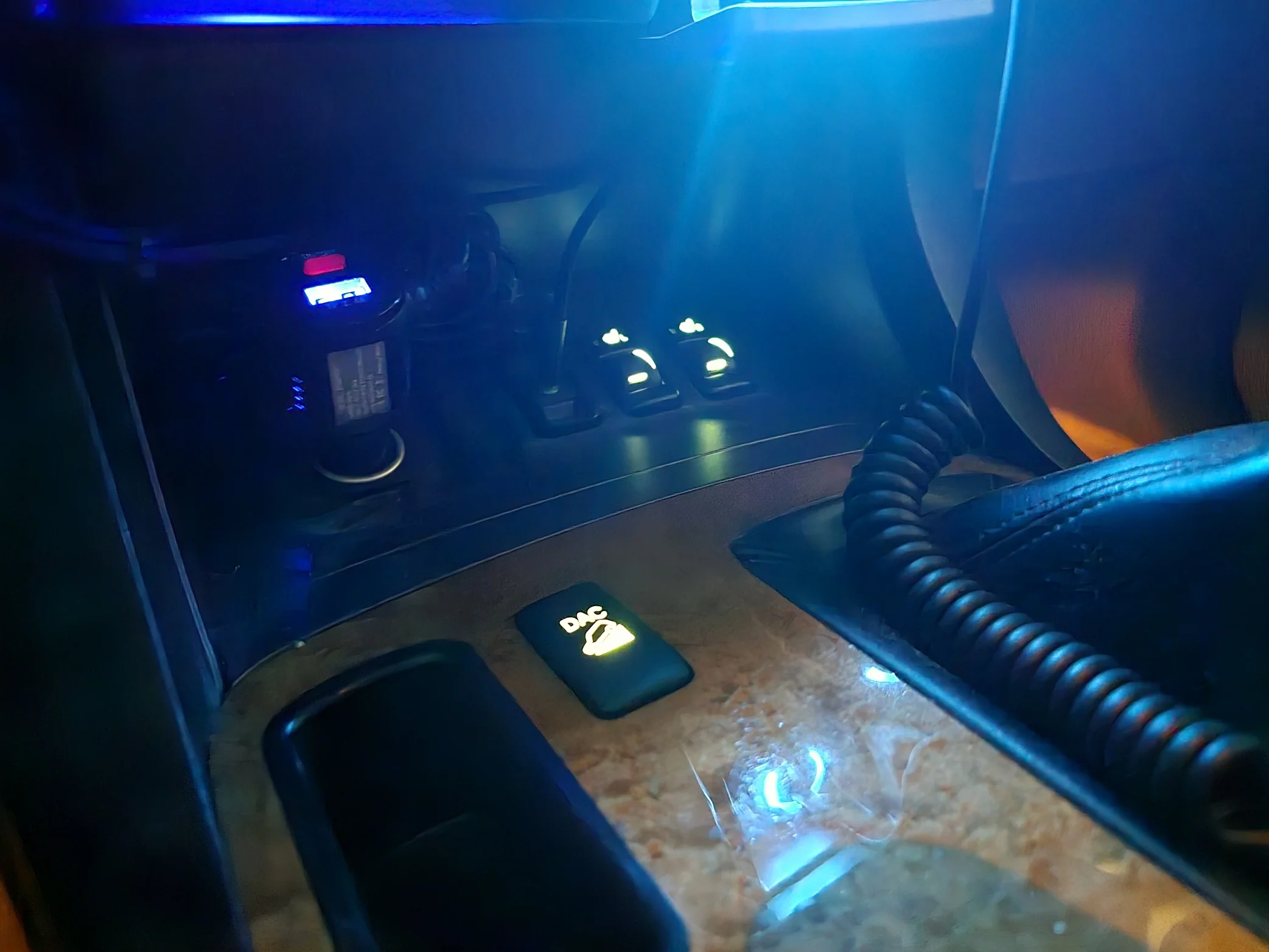

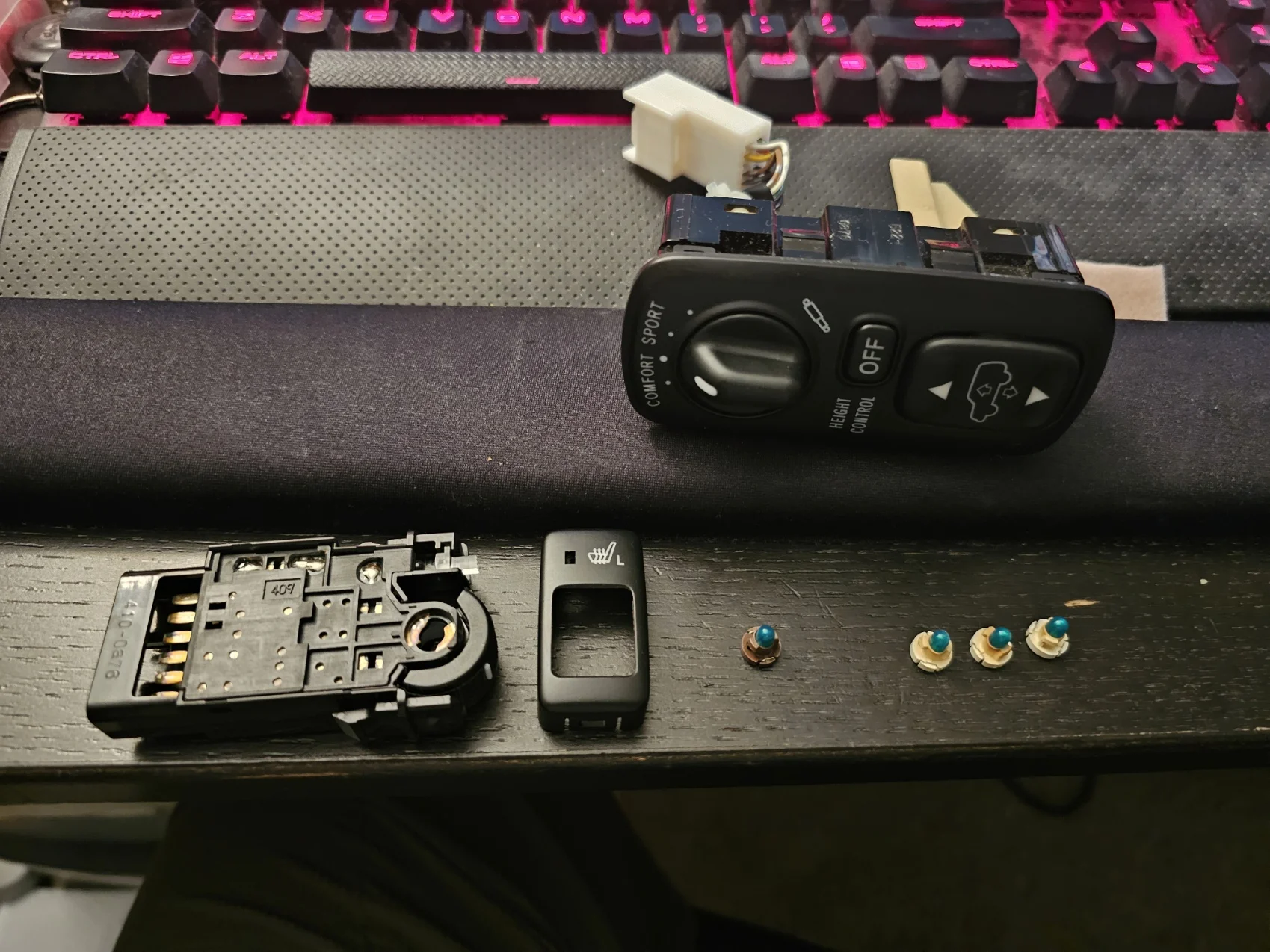

I've been thinking about getting new replacement LEDs for the burnt out ones in my switches and realized my old suspension control switch had 3 functioning bulbs that match the brightness of the original bulbs.
seat heater and DAC switches back to standard lighting:
At least these can remain OE in appearance. Most of the switches to the left side of the steering wheel are burnt out, so I'll try out the LEDs there first.
