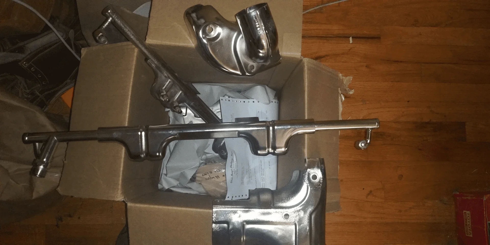

They recommended some high-heat Nickle plating for the below bits. After 5 years, not a mark on them. They even repaired one of the air rails where the small tube on the end was loose.

I do have a question though. Did you have to do any polishing before hand to get that shine? Or did you send out your items simply sandblasted?
The parts that needed de-greasing I cleaned first, but didn't do any rust removal.
The bits shown above were given as-is. That's a high-temp Nickle plating, not zinc. They have a $100 min (or it was last time I was in there), but prices are very reasonable, I think. Or were... It's been a couple years since I took anything to them.
