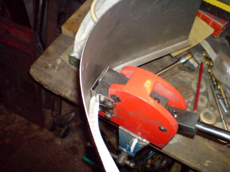

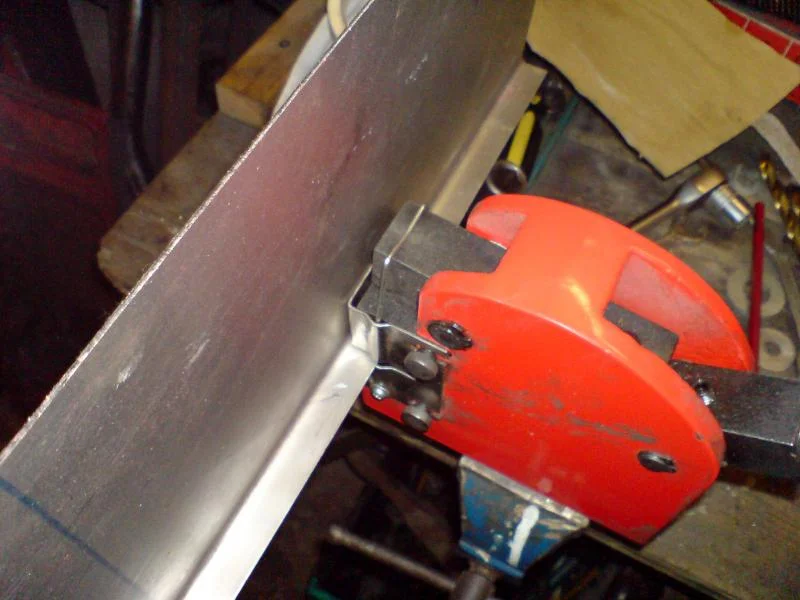

Re the second film: I've just used a shrinker/stretcher to form repair panels for the rear quarter panels. Put the return on first and then use the shrinker to form the curve - it shrinks the return and pulls the panel to the required curve. Amazing tool. Will post photos when I've done enough posts.

Thought I try to show a couple of pics showing the Shrinker/stretcher when I made my rear quarter repair panels.
The advantage is you don't then have to weld on the return.
