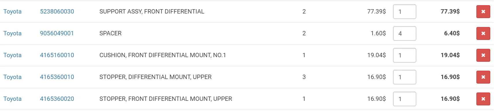

Getting ready to make my order on Partsouq. Before I do, can someone help make sure I've gotten the right part numbers? Trying to alleviate as much pressing as possible, so I'm going to buy the complete 'arm'(s?) It looks like there are 2 complete arms in the video. Not willing to pay for the diff cover/bushings combo so I'll chisel/press that. Part numbers I have are attached. (Spacers are for LCAs, disregard).

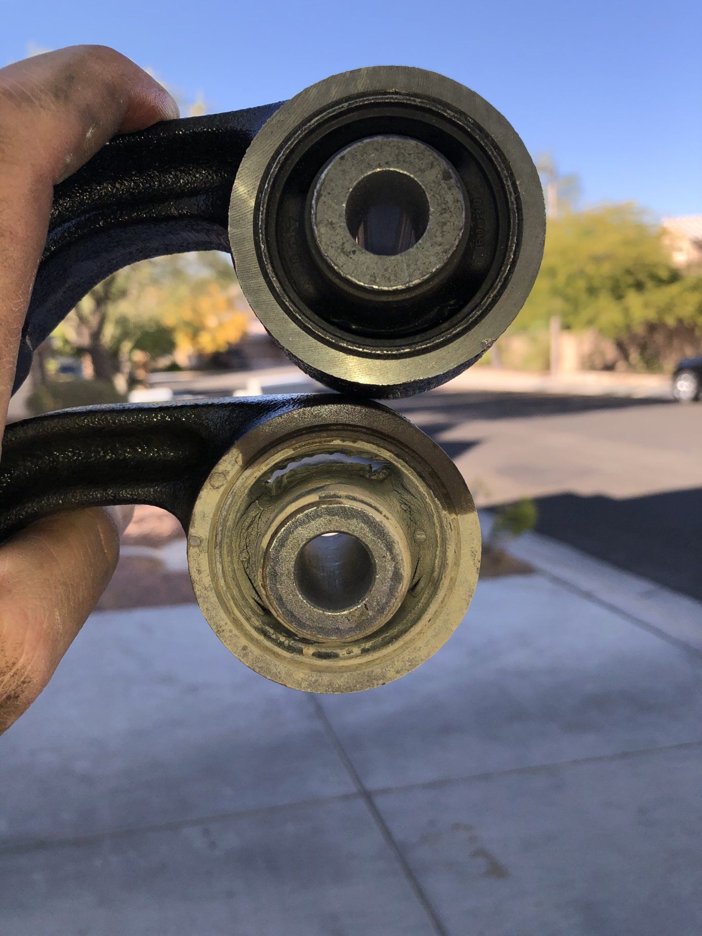

As for the diff replacement, yeah a lot more scary sounding/looking than it ended up being. Took me less than 30 minutes to drop the front lower diff bushing. Started with a hand chisel to get the lip started moving all the way around, then sprayed a bit of penetrante on it and let it sit for a few. After that I hit it with the air chisel, took a bit of work (side to side) to get it starting to move and not just bending the lip down, but once it starts moving it comes out within minutes. I will replace the other two arms completely. Just easier and quicker.
As an update here, I just went through my 06LX and swapped bushings. Took me about 90 mins including prep and cleanup this time around. Once you know what to expect with the air chisel you can really scream through the job.
I bought the side arm from Toyota so that saved a TON of time and effort. I'd recommend that to most folks if time is of any concern for you (or if you don't have a press). I also left the rear lower bushing alone - it looked great. I think that bushing sees relatively little force/wear. I don't notice a huge difference with the new bushings, but glad I tackled it. At 217k miles the bushings weren't ripped, but were definitely worn.

partsouq fedexs the parts to you in three days. I just ordered the five diff mounts and balljoint boots from them this morning. This order would have been $418.73 for parts and shipping, before tax.
5238060030
Item# 5238060030
$85.54 USD​
1​
$85.54 USD​
5238060040
Item# 5238060040
$85.54 USD​
1​
$85.54 USD​
4165160010
Item# 4165160010
$20.97 USD​
1​
$20.97 USD​
4165360010
Item# 4165360010
$18.67 USD​
1​
$18.67 USD​
4165360020
Item# 4165360020
$18.67 USD​
1​
$18.67 USD​
4332469085
Item# 4332469085
$5.06 USD​
2​
$10.12 USD​
Subtotal$239.51 USD
Shipping and handling$55.54 USD
Total$295.05 USD
Payment$295.05 USD
