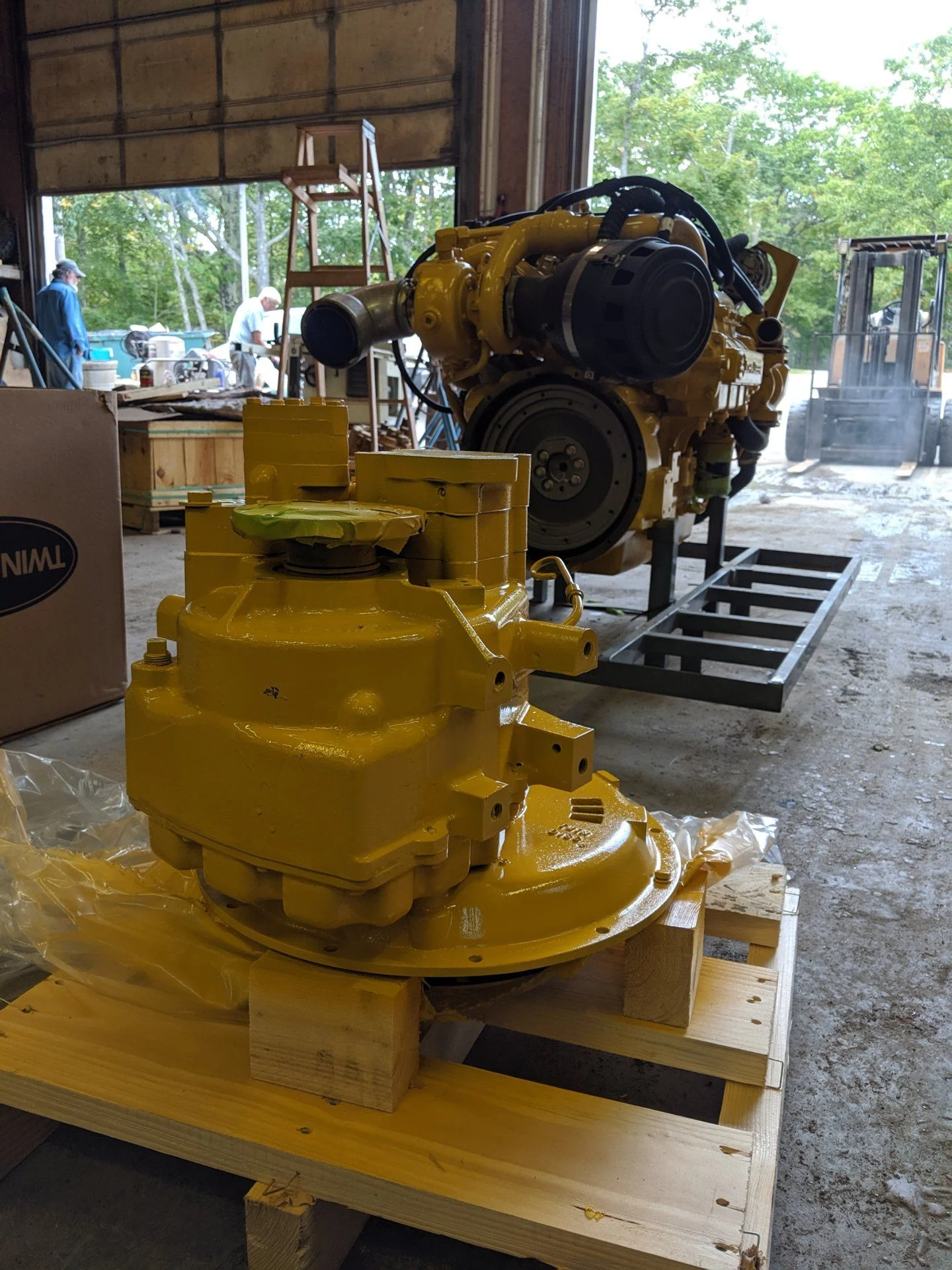

So I have this in the shop that I can pick up for very short money, I rebuild these things for a living so labor is good, I know parts can be expensive but we get discounts so not to bad.

That rear mount turbo is pretty interesting. What’s that used for? Gen setnor something? I wonder if the 1HD-T pump will swap on? That probably has a load based IP?

Looks to be an HD-FT variant. The turbo mounted on the backside will need to be relocated. You will need to spend hours on TDIY researching part #'s to make it work. All new intake and exhaust manifolds, turbo, cooling, motor mounts (look to be in same location), injection pump (?), fuel lines, vacuum pump, etc, etc. Then wiring. Sh!t ton of work and time.

this is a marine propulsion engine I would think I would try to find a "normal" exhaust manifold and turbo, so wot on the marine engine is 3850 and the toyota is 3400 so I dont know if that or the way the governor works will be a problem

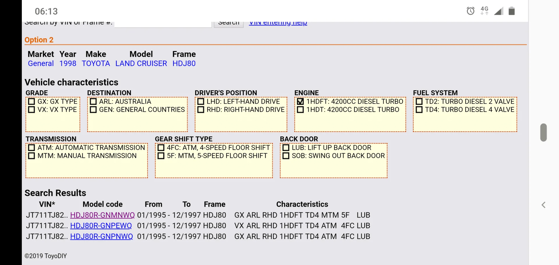

It's 24 valve, so the Toyota equivelant is a HD-FT, they were used from '95-98 only.
If you're searching on Partsouq, amayama etc, search for an Australian market 98 hdj80
