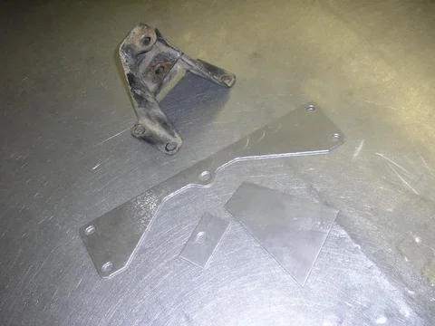

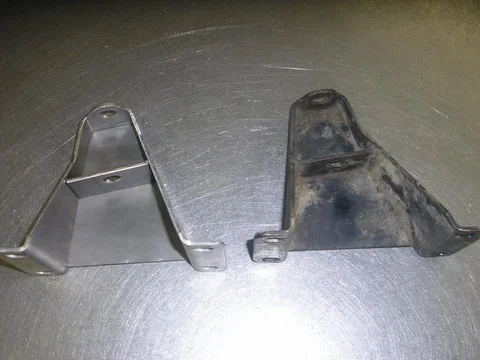

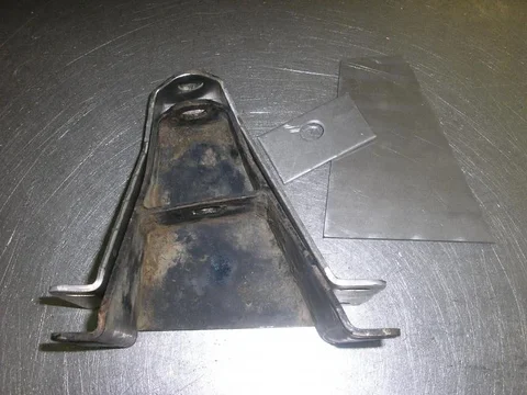

Ok, finally got time to fit in a little progress on these. I drew up, punched out and made a first off of the PTO shaft bearing bracket...
Came out real good - no changes required to the layout - ready to manufacture
I have also done the layout on the frame extensions and punched out the flat - just have to bend them up.

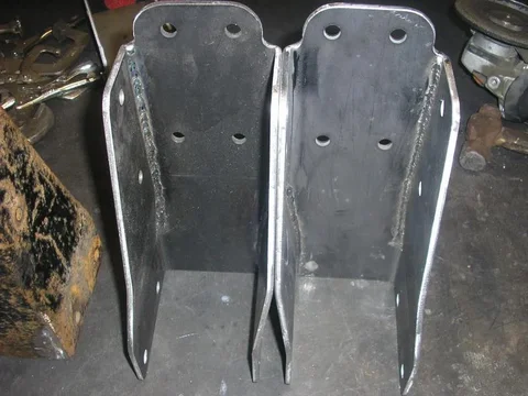

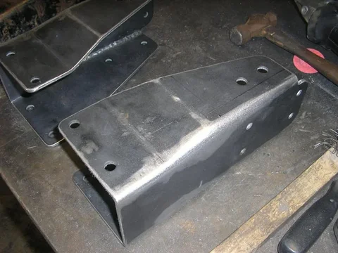

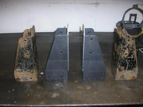

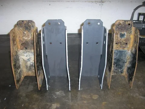

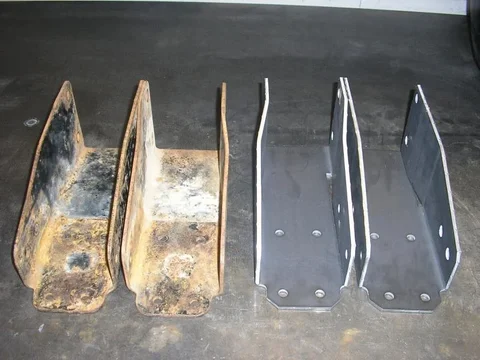

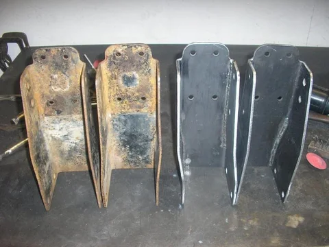

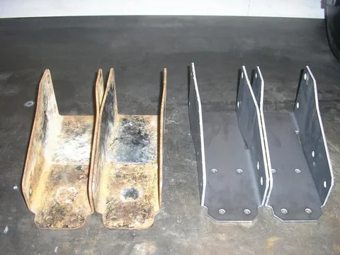

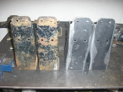

Ok, I have got a set of frame extension brackets formed up and ready to ship. What I'd like to do is send these to 3_puppies for some feedback before I finish off the rest of the run.
I am attaching several photo's showing my reproductions compared to the samples 3_puppies supplied.

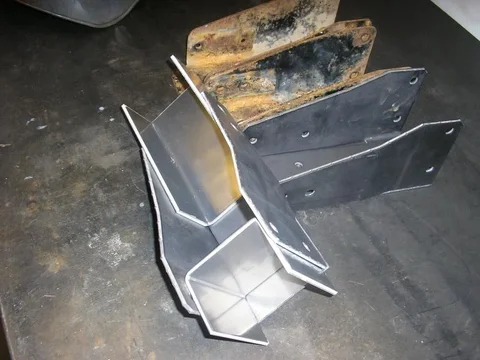

Starting with three views before welding...
Here you see the offsets in the flanges - top and bottom flanges are offset a different amount

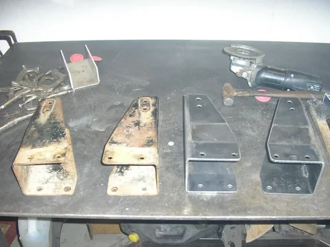

more views:

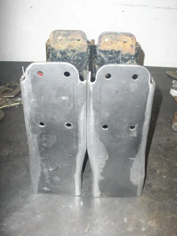

These are the aluminum jigs I used to maintain a 3.75" ID where the brackets wrap around the frame ends and the 4" OD to fit inside the bumper or whatever goes on the end.

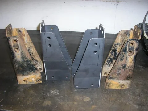

welded and cleaned up
the internal bead was kept small as to not interfere with the frame
I believe this is the way they sit on the truck - if you were standing in front of it
