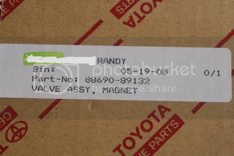

4WD VSV Replacement: Toyota P/N 88690-89132
Part Name: Valve Assy, Magnet
Price from CruiserDan: 17.77
No Discount Price from Toyota: 23.70
This part is off a 1988 Toyota Pickup. It's off the 22R Engine.
