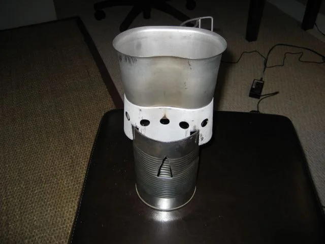

Well. My stove works or at least the alcohol stove works. Almost too well. Haven't tested the wood or esbit yet. But remember. I just thought of this last night.:flipoff2:
Used a hammer w/ an x-acto knife to start the cut around the Armour 3oz. Potted Meat can. (WEAR GOGGLES! The tip of my x-acto knife broke and went flying. It would suck to be in the eye.:crybaby: ) Then used the X-acto knife exclusively to finish cutting the big hole. I drilled 8 holes and tried it outside, and the flame was all over the place. I might try another with fewer vent holes.
I ended up w/ a 25.5oz Chef Boyardee can. A little taller and will give me more burn time with wood. (I thought I had bought lunch too, but that s*** is just nasty.:doh: )I measured thirds around the can to properly place the triangular "flaps." I tried the x-acto knife, but it was too tough. Got out an old serrated knife and went to town. Pick one ring around the can to start all your cuts from. This way the inner alcohol stove will be level.
We'll see if the holes around the bottom work or if I should make another with the holes in the bottom and put some legs on.

It sort of got put on the back burner(pun:D ), but not after some developments.:D
I received the canteen cup holder and realized that it was too big to fit the 25.5oz can I was going to use(pictured above). So I went out and bought a bigger 35.5oz Chef Boyardee can(gross) and proceeded to brainstorm ways to mount the canteen cup holder on top of the can.
Then it hit me. Use the pre-cut opening in the canteen cup and then cut 2 new "slices" into the canteen cup holder so it rests evenly and firmly on the can. The canteen cup sits pretty firmly inside the cup holder right out of the box so once they are joined, it's really hard to seperate them. Hence why I made the holder easy to lift on and off the can. The cup holder and cup are attahced to form one part of the appuratus.
Below is pictured the current prototype. It boiled a cup of water in about 20 minutes using the alcohol burner. Way too slow. The next design calls for the burner to sit higher up so I'll be cutting the side slits higher up.
