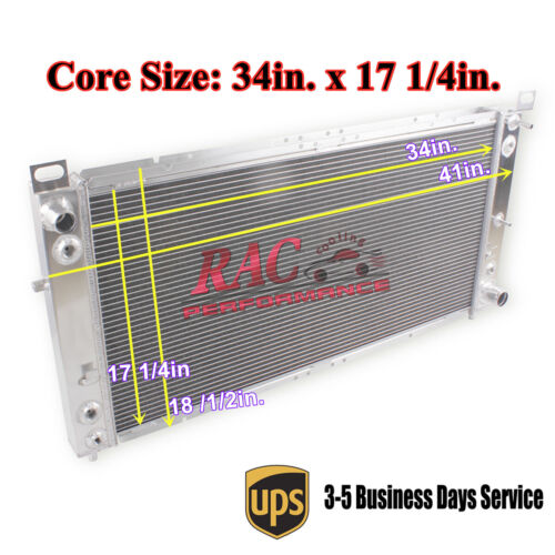

Got the exhaust fixed. Only real immediate need is a radiator. It's leaking a bit. I'm thinking of getting a Chinese aluminum radiator...
I really don't like plastic radiators that much and avoid them if I can. I'm going to see if I can find anyone on the forums using these radiators. The original clutch fan works great, its like only the original with truck clutch fans on gm stuff works right i guess. The power steering box will need rebuilt eventually due to seeping as well as the hydroboost will need new seals at some point. I'm injured, so I'm pretty limited on what I do. I'll get a shop to do a radiator and perhaps some shocks and everything should be good for a while until things settle down. Overall I'm happy with the truck. The floor rust was a definite unexpected issue but not too bad of a fix.
I ended up replacing the radiator with a denso unit. Works great. I need to replace the driver door pins and ultimately the door. Used doors are cheap and plentiful. I replaced the broken stalk switch with a used one. Replaced the cracked washer tank with a used one as well. I also washed the engine compartment. A old trailer controller came with the truck. Replaced the trailer plug and it works. I also got a set of aluminum 317 heads I can port if I feel bored. I also used a cheap heavy duty door mat from home depot as a floor mat. All the cheap floor mats are too cheesy. Im getting 12 to 13 mpg city so far.
