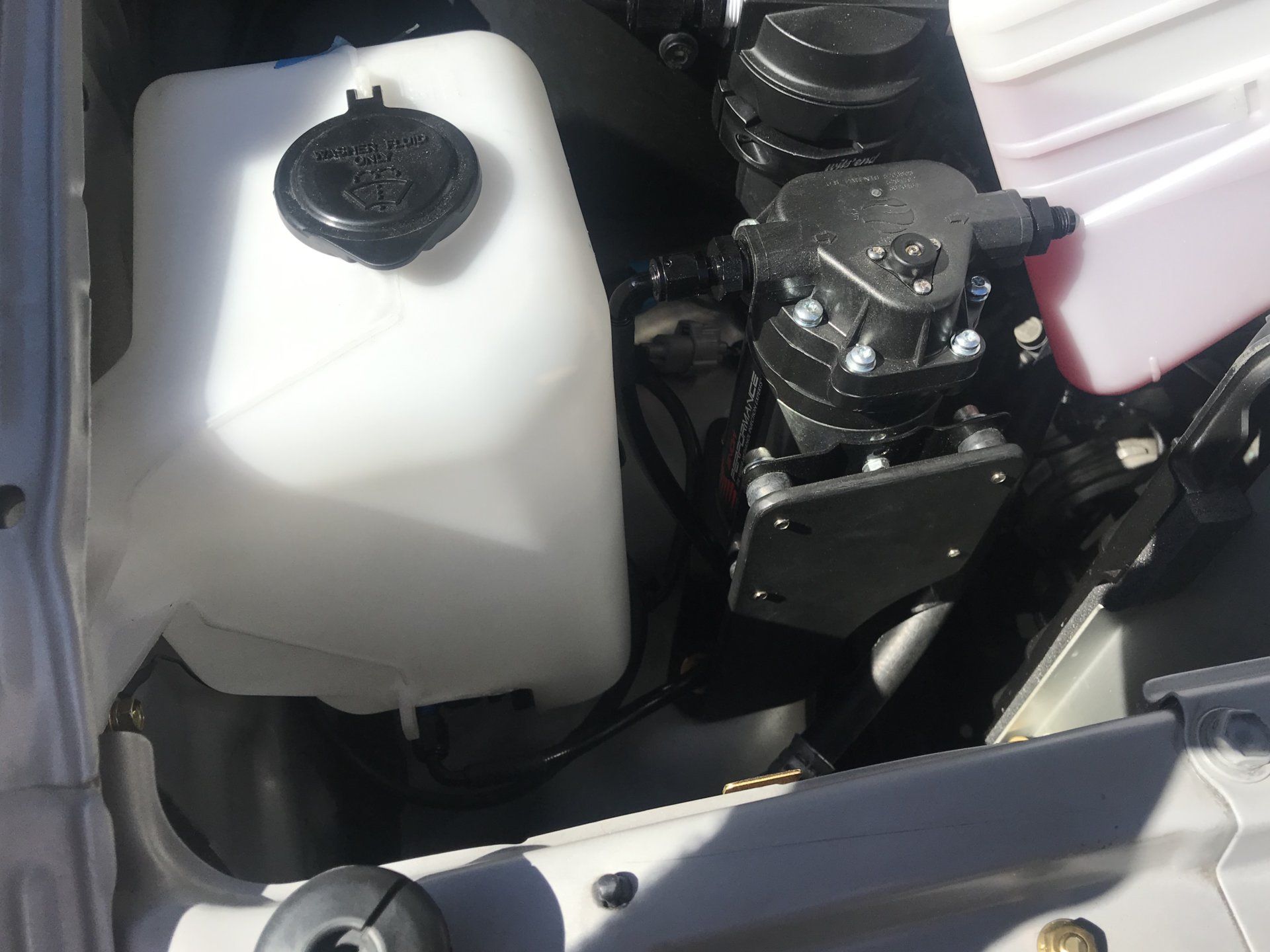

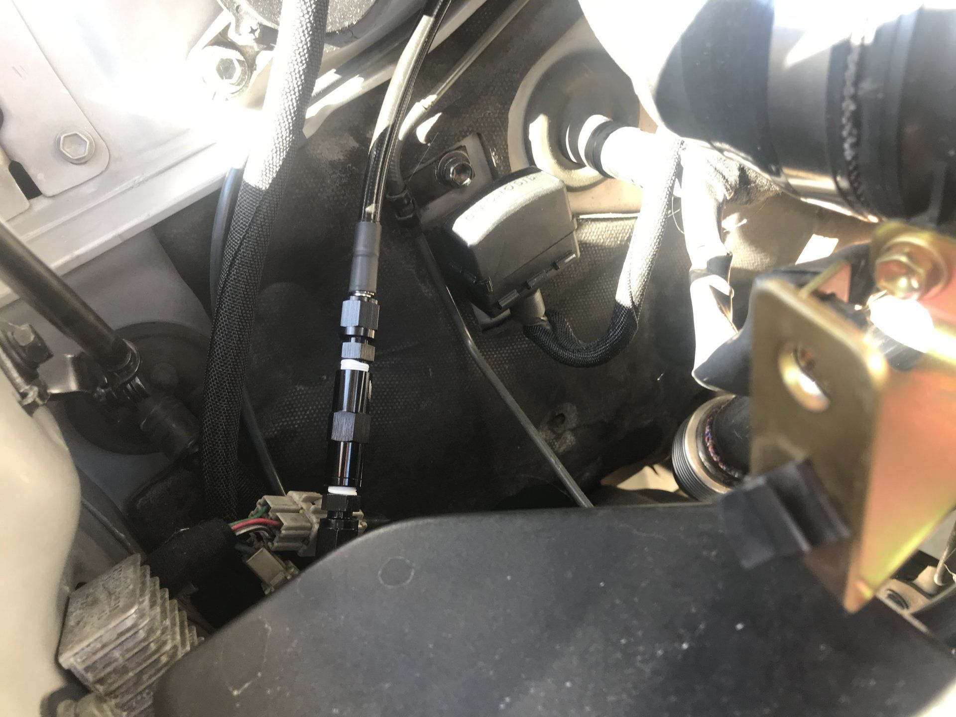

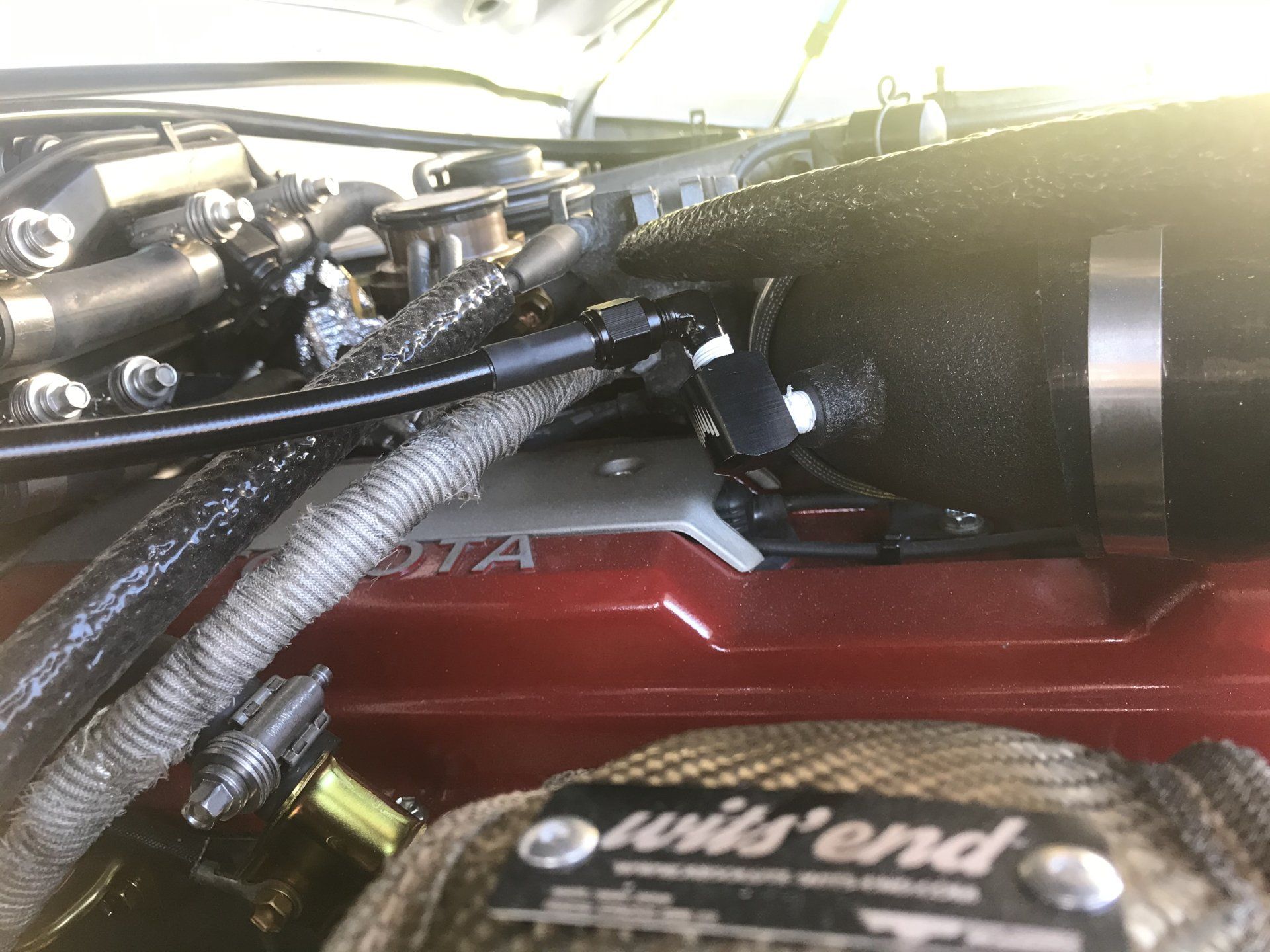

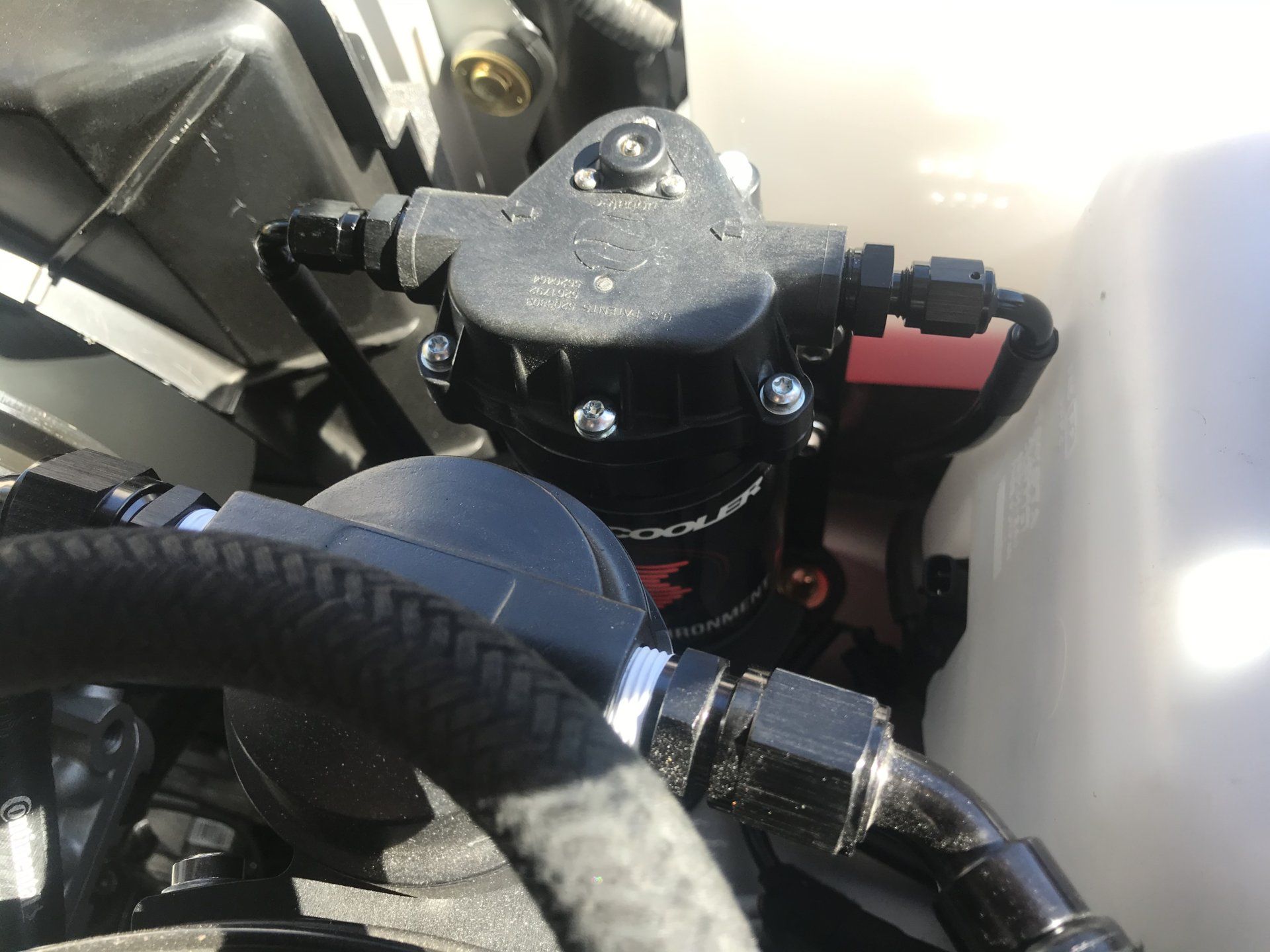

The Meth Injection system got another step forward. All the hoses are in and it’s sealed tight. I have everything drawn up so replicating it won’t be a problem. I’ll have to figure out how much the hoses want to move once they are pressurized. Only reason they aren’t secured down yet.
