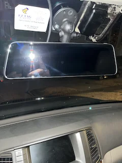

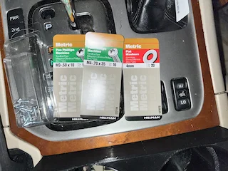

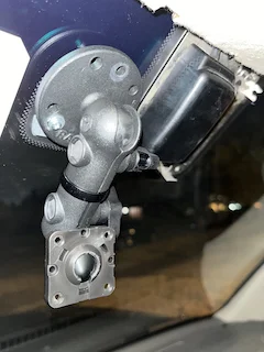

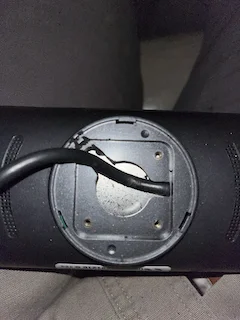

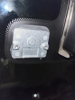

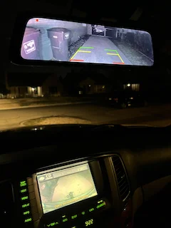

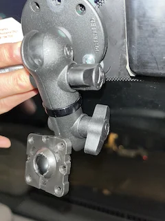

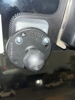

2005 LX470 here. In the meantime, I fabricated this mount from several pieces and used a Dremel to cut the mirror cord wire an exit and the 4th corner off the mirror mount for the same reason. 3 screws should be fine. Ram ball mount, 67 designs nano mount with 20 mm to 1" ball. bulletpoint mounting adapter ball 22.5 mm to 20 mm. The factory silver mounting plate takes 2 M3 machine screws. I used an auto-vox mirror and did some custom fabricating on it to make it work. You can also do this without fabricating the mirror by using a ram ball motorcycle mount with M4 machine screw and washer to go into the mount that comes with it and a ram mount arm but it makes the mirror super long and hangs down too far IMO.

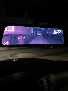

notice the pics comparing OEM monitor and new mirror are at nighttime and then the reverse light and function is used to auto tilt down and shows guidelines and produces a perfect image. NO blind spots when using the new mirror with it's super wide view and side view mirror. Great solution for those that want a full time rear view camera display. This camera also has a dash cam on the front as well.
shorter mount install
67 designs arm with 20mm to 1" clamps
bulletpoint ball adapter 22.4 to 20mm: 67d was sold out
Ram mount
auto-vox mirror
machine screws at lowes
see pics
optional longer install:
ram arm
ram ball
machine screws
see pics
@HTXLXCRUISER Genius! Thanks for sharing. Do you get any wobble from the ram base at the windshield mount?
zero wobble. one pic shows it mounted with excess at the bottom. I switched that to the top for the final install and either way it's super snug. it really mounts nicely and that ram ball was used due to the multiple holes. I'm certain you can use a square or other ram mount if you want to drill holes to make it work. dealing with such small tolerance of M3 screws, I didn't want to do that. I'll use blue loctite after I test this for a week to make sure it stays put.
Again would rather have wits end custom metal fabricated mount so it looks factory and not quite as long but this will do until he gets that done. where there is a will there is a way. cost me about $75 in parts plus the mirror plus $500 in time and labor researching and testing a solution. ha!

I get wobble from the original Gentex version, quite a bit of jumping around just driving on the highway and I don't see any easy way of adjusting the tension without
modifying the mount with screws or the likes.
