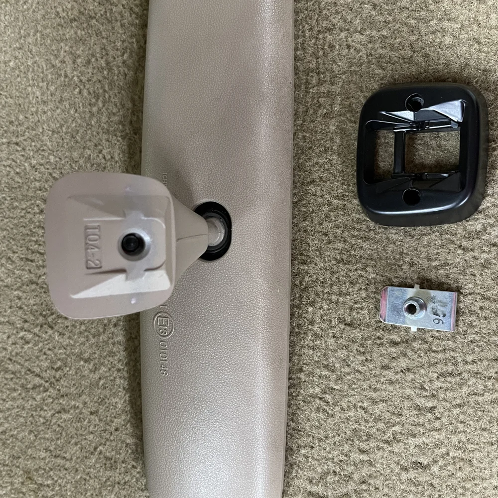

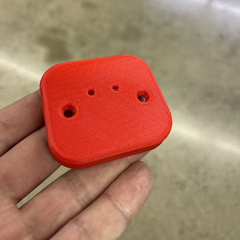

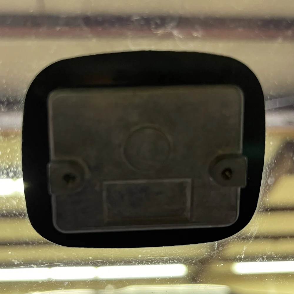

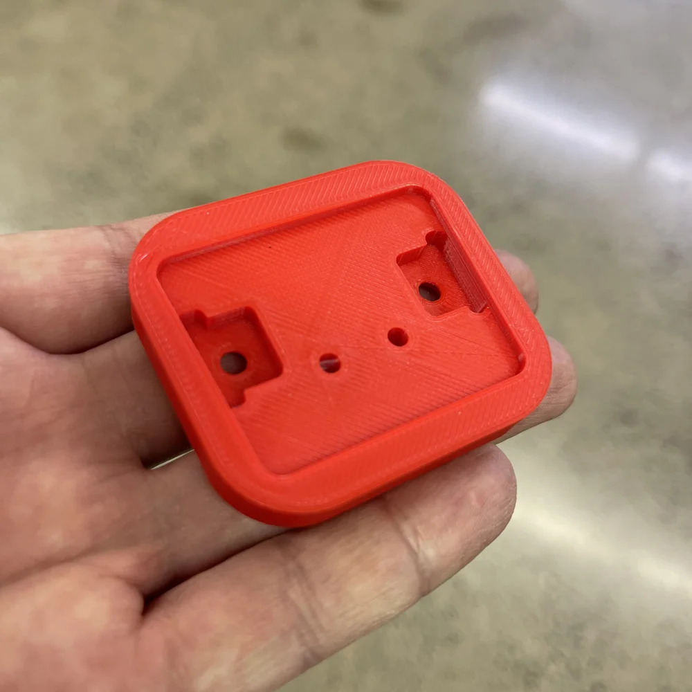

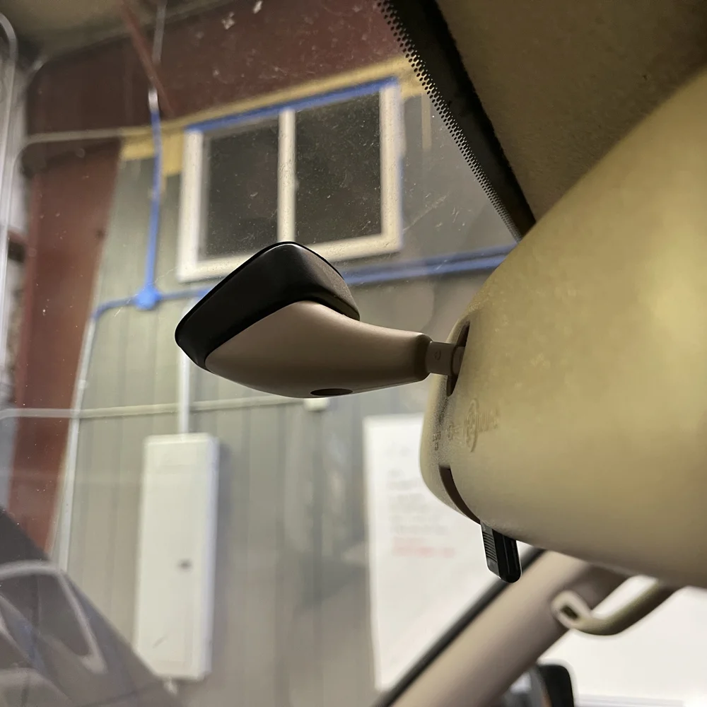

I've been working off and on making a Gentex mirror mount for my 99 100Series. The main issue is the mount itself is integral to the actual windshield so I had to work with that piece. The next problem is it used TINY machine screws to mount the OEM mirror but this means its not smart to mount extra accessories like dashcams and/or GoPros so I'm thinking of JUST a mirror mount.
Right now I am just looking for feedback because I'm really not sure how popular a mirror mount will be if I'm making it a one-hit wonder, whereas on the 60s/80s there are optional mounting options built in.
The original Toyota mirror and mount:
